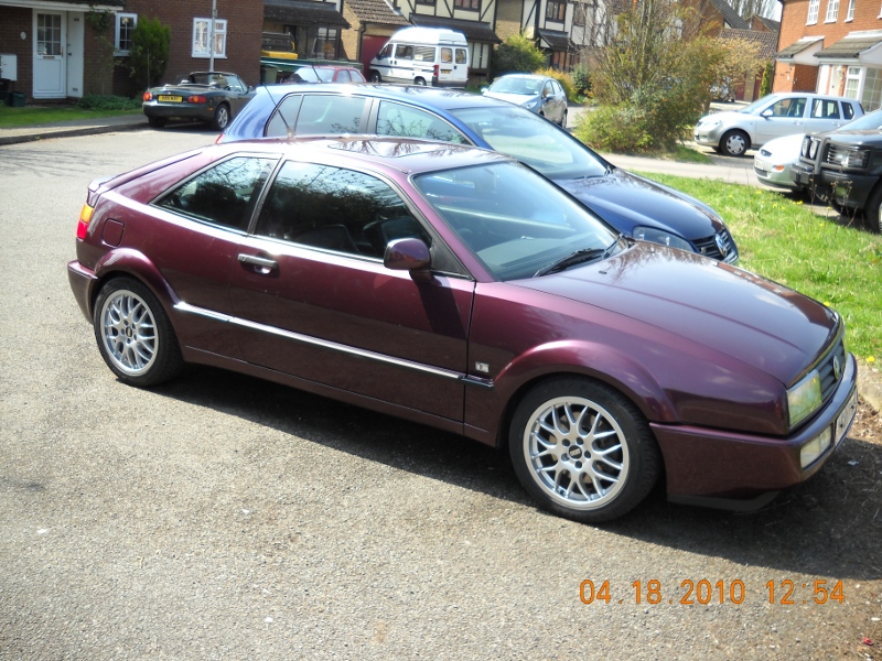

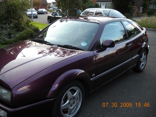

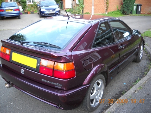

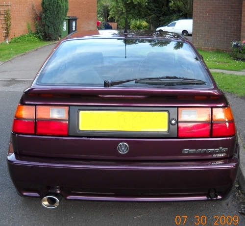

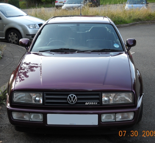

beastie4126 0 Posted March 21, 2010 (edited) Took these last year following a 4 hour polishing session, looked like it needed to be done again two weeks later :brickwall: Edited August 12, 2013 by beastie4126 Quote Share this post Link to post Share on other sites
MK1Campaign 0 Posted March 21, 2010 Mint. Definately my favourite Corrado colour. Quote Share this post Link to post Share on other sites
ozowen 2 Posted March 21, 2010 AAAHHHH target number 3 :lol: :lol: :lol: . Nice looker matey. I think the blackberry scrubs up so well Quote Share this post Link to post Share on other sites

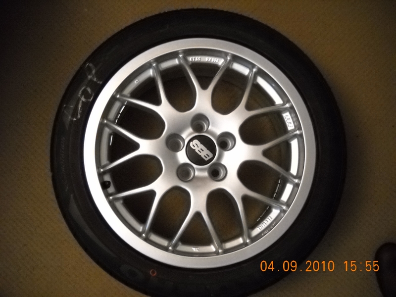

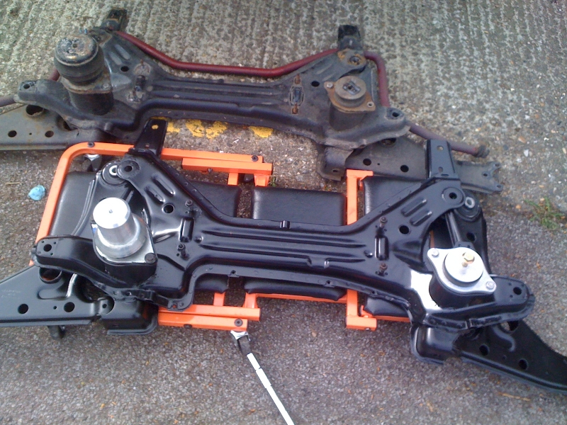

beastie4126 0 Posted April 9, 2010 Been busy this week swapping over my refurbed subframe and wishbones as well as a full set of new engine mounts. Took a drive to Lepsons in Gillingham today to collect my refurbed BBS RX wheels, can't wait to get these fitted over the weekend. Quote Share this post Link to post Share on other sites
scarlet_vr6 0 Posted April 9, 2010 RXs on a blackberry? def gets my vote :wink: Car looks lovely by the way. Hope mine will shine like that one day :D Quote Share this post Link to post Share on other sites

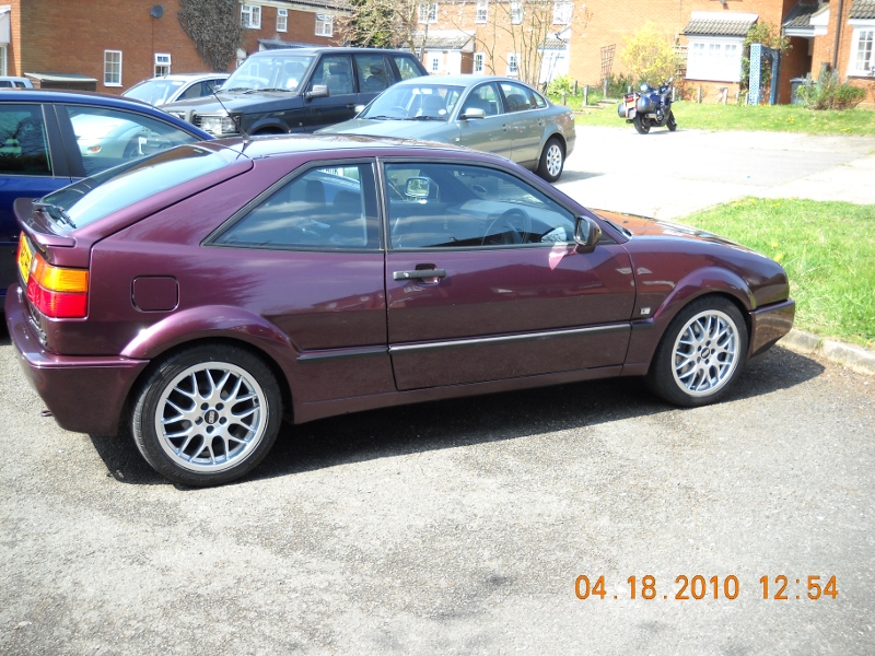

beastie4126 0 Posted April 18, 2010 Decided to make the best of the sunny weather and get my new wheels fitted and then take the old girl out for a test drive. After installing cams and suspension parts during the week it feels nice to drive and even nicer to look at now :D Quote Share this post Link to post Share on other sites
robrado974 1 Posted April 18, 2010 lookin sweet mate kooks realy nice 8) Quote Share this post Link to post Share on other sites

beastie4126 0 Posted August 15, 2011 Switched over my Eibach 22mm Front ARB to a Neuspeed 25mm at the weekend, mostly to get around the wishbone knocking the Eibach was doing. Reasonably easy to do once jacked up and with the help of my mechanics m8 (wife). Easy to see from the pictures why the Eibach bar was clouting the arms when compaired to the Neuspeed even though the new one is 3mm thicker. Not had much road time with the new one fitted but very glad to be rid of the anoying thunk noise I had. Quote Share this post Link to post Share on other sites
