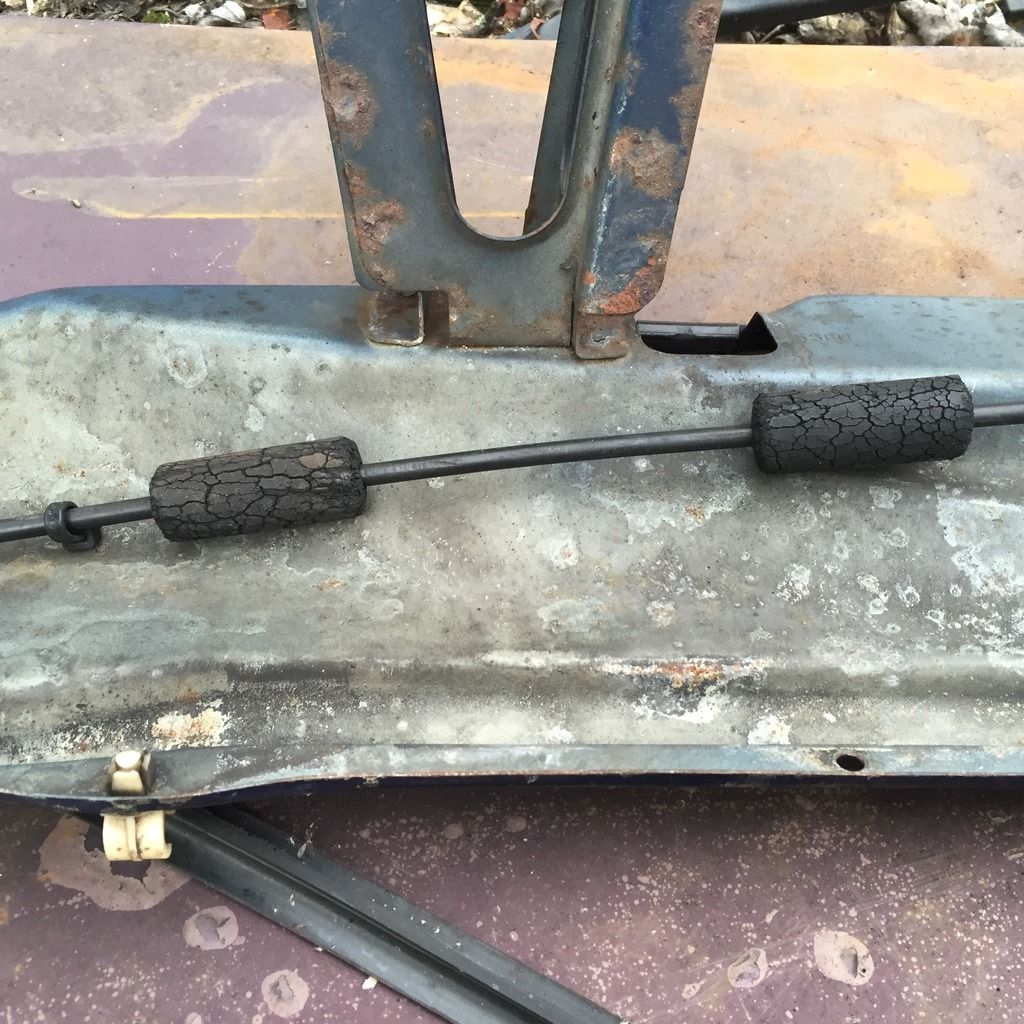

Jim 1 Posted August 17, 2016 One thing I would be interested to see is what the guides that protect the bonnet cable where it runs between the two release latches and across the front of the radiator, look like? They're apparently obsolete. I read a guide somewhere just saying to use a segment of the old bonnet cable sheathing. Does anyone have a picture of what this stuff is actually meant to look like? It's part number '24' on the attached diagram.. My cable is now running right across the top of the radiator so I worry that the constant heat cycling on it will cause it to weaken over time. Quote Share this post Link to post Share on other sites
easypops 6 Posted August 17, 2016 One thing I would be interested to see is what the guides that protect the bonnet cable where it runs between the two release latches and across the front of the radiator, look like? They're apparently obsolete. I read a guide somewhere just saying to use a segment of the old bonnet cable sheathing. Does anyone have a picture of what this stuff is actually meant to look like? It's part number '24' on the attached diagram.. My cable is now running right across the top of the radiator so I worry that the constant heat cycling on it will cause it to weaken over time. I'll fire up a picture of it later on mate, it is as you describe, the same as the cable sheathing with a metal end on each side plus a 3 foam type spacers to stop it rattling I guess Quote Share this post Link to post Share on other sites
Jim 1 Posted August 17, 2016 I'll fire up a picture of it later on mate, it is as you describe, the same as the cable sheathing with a metal end on each side plus a 3 foam type spacers to stop it rattling I guess Hm OK - I may remove my cable then and fashion something out of the old sheathing for a bit of extra protection. Cheers. Annoying that part is obsolete really given that everything else is available. Quote Share this post Link to post Share on other sites
easypops 6 Posted August 17, 2016 Hm OK - I may remove my cable then and fashion something out of the old sheathing for a bit of extra protection. Cheers. Annoying that part is obsolete really given that everything else is available. Should be easy enough to fashion something out of your old cable mate, I'll also take an accurate measurement of it Quote Share this post Link to post Share on other sites

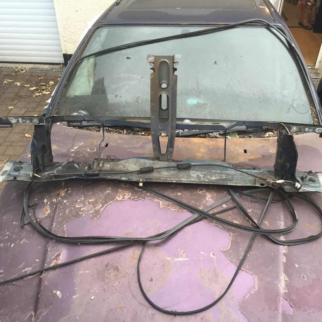

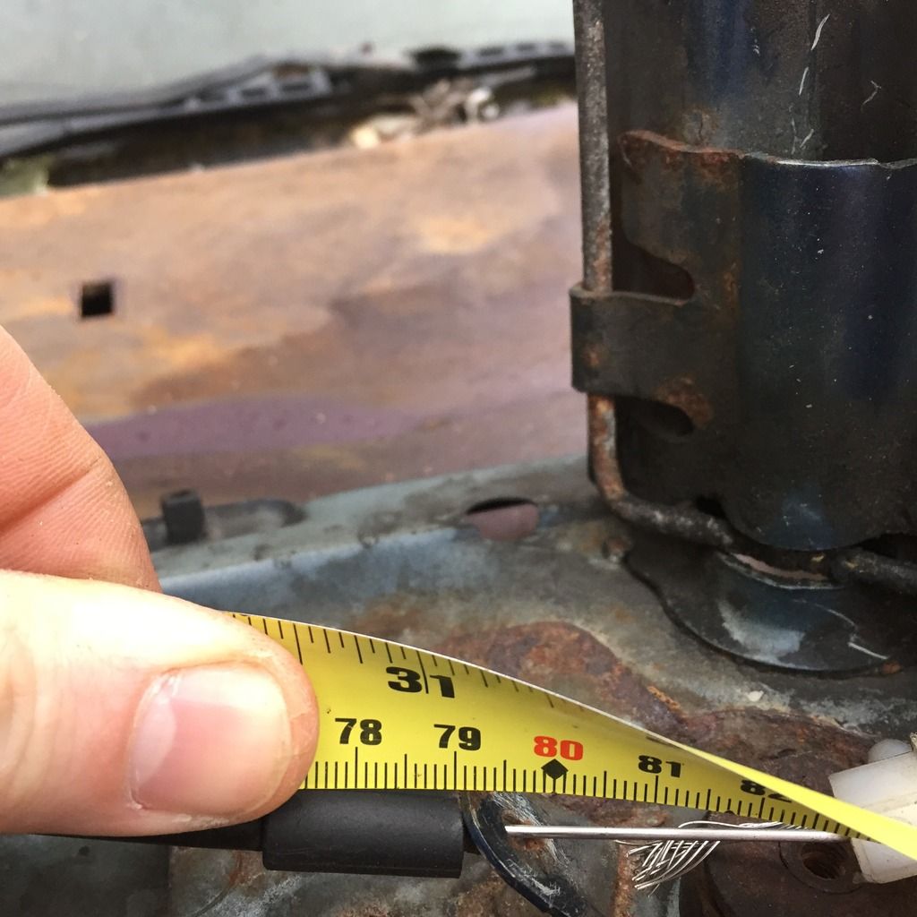

easypops 6 Posted August 19, 2016 Jim, Here are the pictures of the bit under the slam panel,as you'll see it's basically just a bit of cable sheathing with ends on it and some foam spacers, should be fairly easy to make one I'd think......I've ordered some ends so will likely try one out. Length is 790mm Foam spacers Quote Share this post Link to post Share on other sites
Jim 1 Posted August 19, 2016 Interesting - going to start looking for something suitable to duplicate it. I would have said bike brake cable sheathing but this stuff seems more heavy duty, with the metal braid around it. Quote Share this post Link to post Share on other sites
Jim 1 Posted August 19, 2016 OOH BINGO: http://www.ebay.co.uk/itm/BOWDEN-CONTROL-CABLE-2MM-OD-INNER-6MM-PVC-COVERED-OUTER-CHROME-ENDS-1MTR-SET-/291387819817?hash=item43d8114729:g:HLIAAOSwv0tU6ISp Quote Share this post Link to post Share on other sites
Cressa 37 Posted August 19, 2016 Easypops, is that a clip near the bonnet stay holding the cable in situ?? Mine doesn't have that, or any hole where something could go through. The VW etka picture doesn't show it either. Hmm! ! Sent from my SM-G900F using Tapatalk Quote Share this post Link to post Share on other sites
easypops 6 Posted August 19, 2016 Easypops, is that a clip near the bonnet stay holding the cable in situ?? Mine doesn't have that, or any hole where something could go through. The VW etka picture doesn't show it either. Hmm! ! Sent from my SM-G900F using Tapatalk No mate, it's just an old cable tie, it's not my doing, just on a spare slam panel I picked up :) Quote Share this post Link to post Share on other sites
