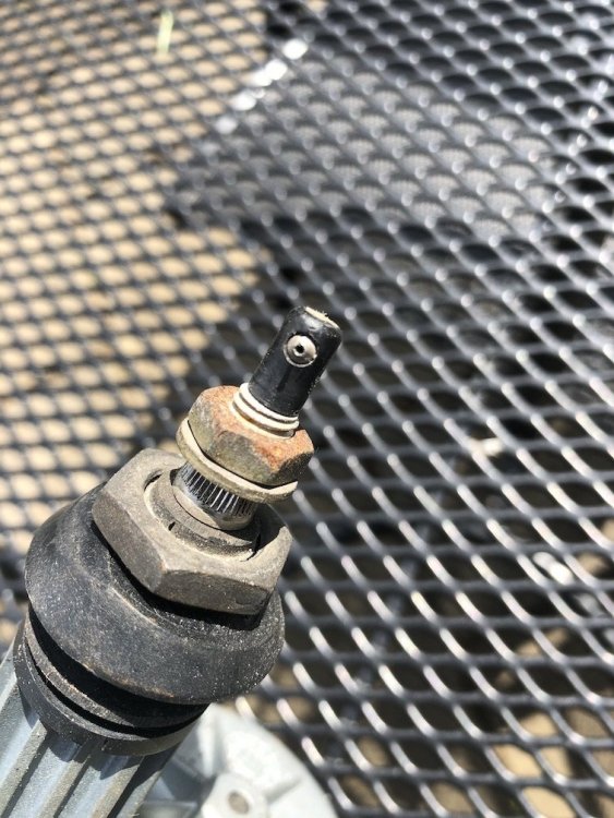

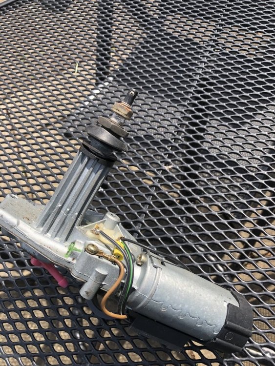

tonedef 5 Posted May 7, 2020 2 hours ago, fendervg said: That would be great - cheers. This is the rear wiper motor I removed and the jet that's in there, I haven't tried removing yet as I don't know how it comes out and don't want to break anything. Give me a clue how it comes out! Quote Share this post Link to post Share on other sites
Cressa 36 Posted May 7, 2020 I was totally unaware that these could be replaced until a few months ago when I did the one on my Passat. I believe I just wiggled it out. Wait until you get the new one maybe Quote Share this post Link to post Share on other sites
fendervg 24 Posted May 7, 2020 He'll be trying to get it our for me. @tonedef - it should just pull straight up and out with a little force, maybe some side to side wiggling. Sometimes they can get stuck - so don't force it if it doesn't come out too easily, you'll be better off selling the whole motor with it in it. The feed pipe part should just pull out of the bottom then - the two bits kind of hold each other in place from both ends, although I did see a motor where the plastic pipe was practically bonded on to the spindle and even a drill wouldn't shift it. Quote Share this post Link to post Share on other sites

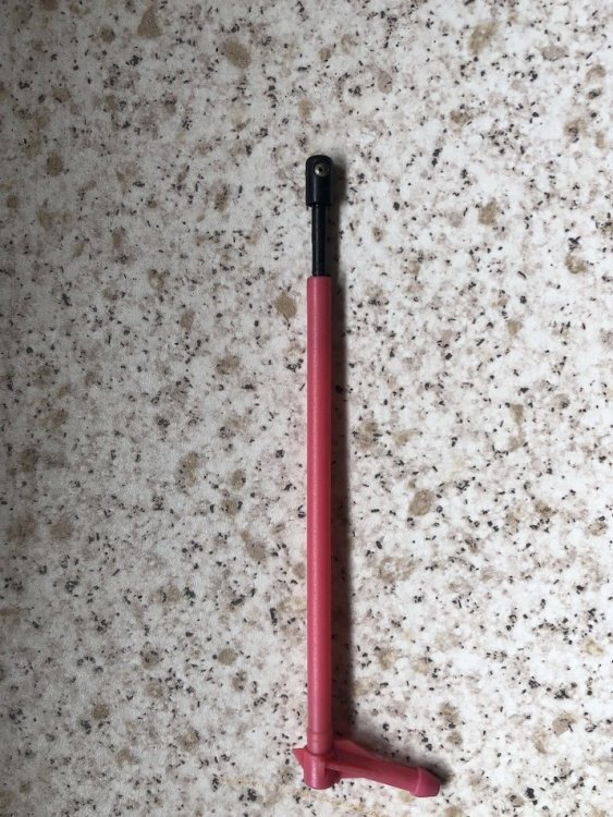

tonedef 5 Posted May 7, 2020 4 hours ago, fendervg said: He'll be trying to get it our for me. @tonedef - it should just pull straight up and out with a little force, maybe some side to side wiggling. Sometimes they can get stuck - so don't force it if it doesn't come out too easily, you'll be better off selling the whole motor with it in it. The feed pipe part should just pull out of the bottom then - the two bits kind of hold each other in place from both ends, although I did see a motor where the plastic pipe was practically bonded on to the spindle and even a drill wouldn't shift it. A bit like this then. If you want to PM me an address I'll put it in the post next time I get chance to go to the shop. I'm not bothered about anything for it, it doesn't really owe me anything and I'm guessing it won't cost a deal to post. Quote Share this post Link to post Share on other sites

fendervg 24 Posted May 25, 2020 (edited) Tonedef - arrived this morning all safe and sound and excellently wrapped. Went on like a treat, and the nozzle now points in the right direction. Many thanks for your generosity again! As a side note, these look the same, but are different lenghts and nozzle positions for different cars, as the jet needs to clip into the feed tube when it's in a certain position to hold it in place. Not sure if other models like the Golf etc. would work without trying them. The Mk3 one certainly did not. Edited May 25, 2020 by fendervg Quote Share this post Link to post Share on other sites
