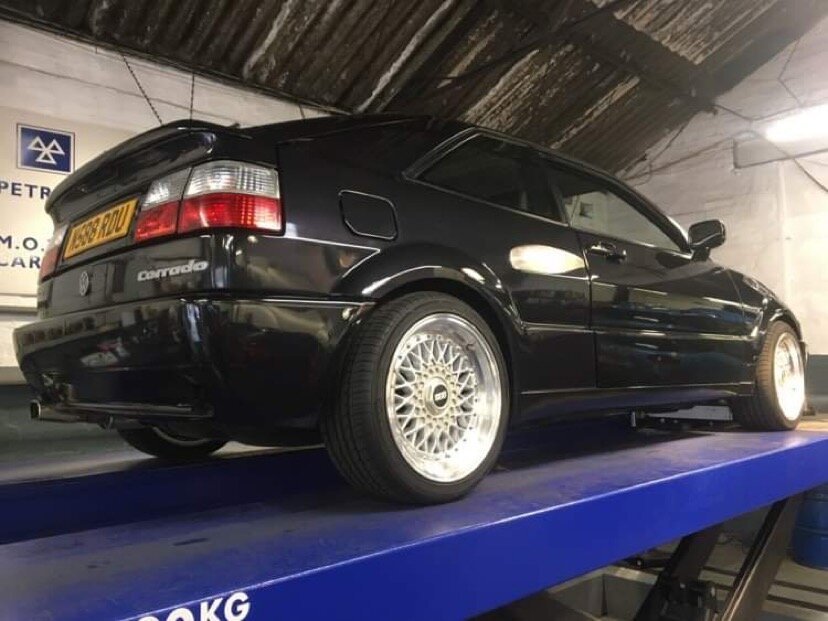

Hey guys and gals, just want to say thanks to everyone who offered support on my project. It’s been a couple of years in the making, but finally completed everything last year! Literally everything has been replaced! Full respray, rebuilt 20vt, Ko3s turbo, stage 2, wiring loom by Dubnutz, all new belts, new cambelt, auxiliary, water pump, alternator, tensioner, battery, Brembo brakes (+G60 calipers), discs, pads, wheel bearings, abs pump, all wheel sensors, leather seats, new headlining, all sensors, knock, water, oil, air, aem AFR, new intercooler and pipework, hybrid shallow sump + new oil return pipe, full stainless power flow exhaust with track-slag down pipe, all fluids changed, new wheels, tyres, new windscreen and the list goes on!… really looking forward to catching up with likeminded enthusiasts this year and any corrado owners up for meeting up in the East Midlands for a convoy and a cruise feel free to link me up! cheers, Luke -
