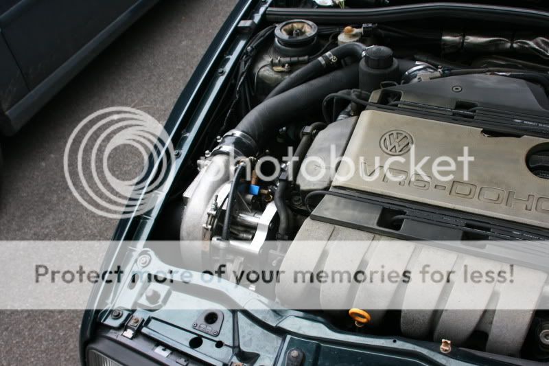

OK, just a quick update as I now have the car back plus supercharger!! What a bit of kit!! Stealth managed to tease 296.5bhp out of it with 244.5 lb/ft of torque and it makes one hell of a difference!! I'll get some graphs up at some point but to be honest, I'm not too worried about what the numbers are....it's quick, makes me smile and I would recommend it to anybody!!
The perceptive ones out there will notice the Schrick did not get fitted as the supercharger kit was piped and ready to go on a standard manifold. The Schrick is therefore up for sale (see below)
The remarkable thing is, it's completely usable!! OK, in first you can't bury your foot straight down (I tried this and there was muchos squeeling!) but get into 2nd and especially third and the thing just takes off!! I was slightly concerned that I was going to have a completely unusable car that was going to overheat, rip my tyres to bits and make hideous noises but it makes all the right noises, holds around 100 degrees (I haven't caned it yet) and goes like stink!!

The only problem when you do these things is that you're teased by seeing what else is available when you pick your car up. On show at Stealth on Saturday was Greg's turbo conversion. They'd just taken it out for a spin with the traction control system fitted and by the smile on Greg's face, I think it worked quite well!!
So, next on the list, turbo!
Good difference there, S/C always look at home in the VR bay. Thats also good news about the TCS. :norty:
