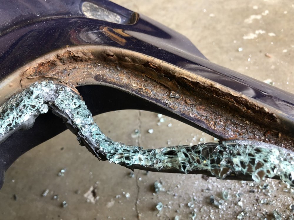

It may even be letting water in now mate, look what I found under my old hatch when I pulled the glass bonding up, it was horrendous under there just came away when I popped the glass. 6470FCD2-F8B2-401E-9BF6-252471FF75D6.thumb.jpeg.2026163d17685b25ebff8ed038641297.jpeg

Wow that was bad Shaun- I know someone who corrado was that bad he had to cut off the whole front part of a donor car roof and get it welded onto his car. Its that wire the window fitters use to cut out the glass it scratches all the paint and then the rust shows its evil face in secret below the seal.
The above is because a body shop was lazy. The prior owner has a rear wiper delete and glass out respray of the hatch, then refitted. 12 years later this is what you find. Painters are notorious for not wanting to bother getting all the old rubber off and prepping it properly. Like windscreen fitters, they figure by the time the rust comes through it won’t be your car anymore
