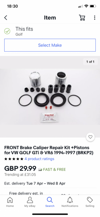

After all that, it looks like they used this calliper on the mk3 and mk4 with a 288 by 25 disc.
Then if it's what it is and I think you're right about this, as per another comment on this tread, maybe upgrading to the mk4 refurbish kit would be a good idea to eliminate the problem of the pistons rusting out...
Thanks for the link as well!
Fantastic! Thanks for your help on this, much appreciated mate!

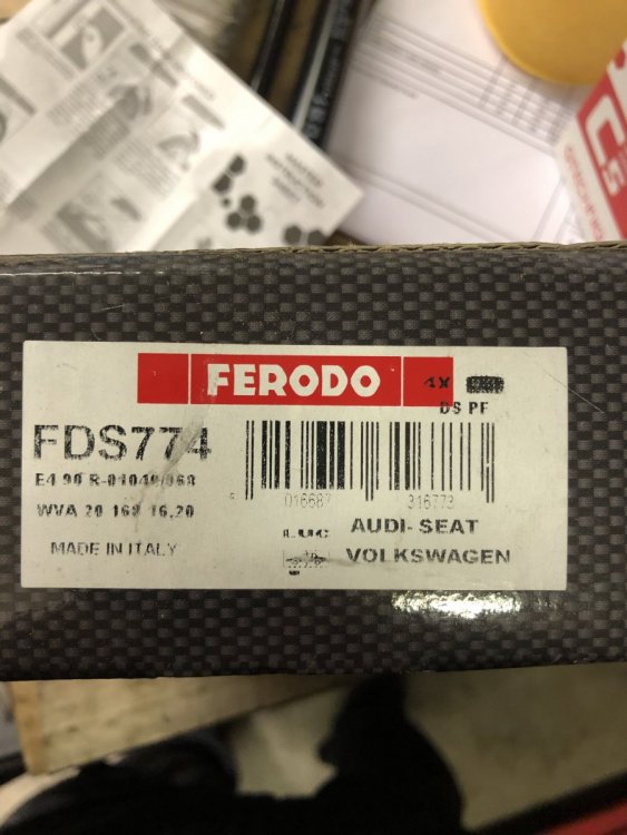

6 hours ago, 1xshaunx1 said:
I bet if you order the Brembo one an ATE one will come in a Brembo box
Possibly mate I have never purchased a set so could nt vouch for them. Have any of you got the 312 disc fitted to Mk4 callipers with the 6mm spacer ? I imagine Shaun you will need some serious brakes with the power you are  running. Whe I owned a Mustang S550 they had 6 pot and 4 pot Brembos but the car weighed  1720 KG with the 5.0 coyote lump in it.
Edited by Keyo
Standard set up on mine but with Brembo  grooved discs and the ferodo pads below.
A lot more stopping power and less fade
