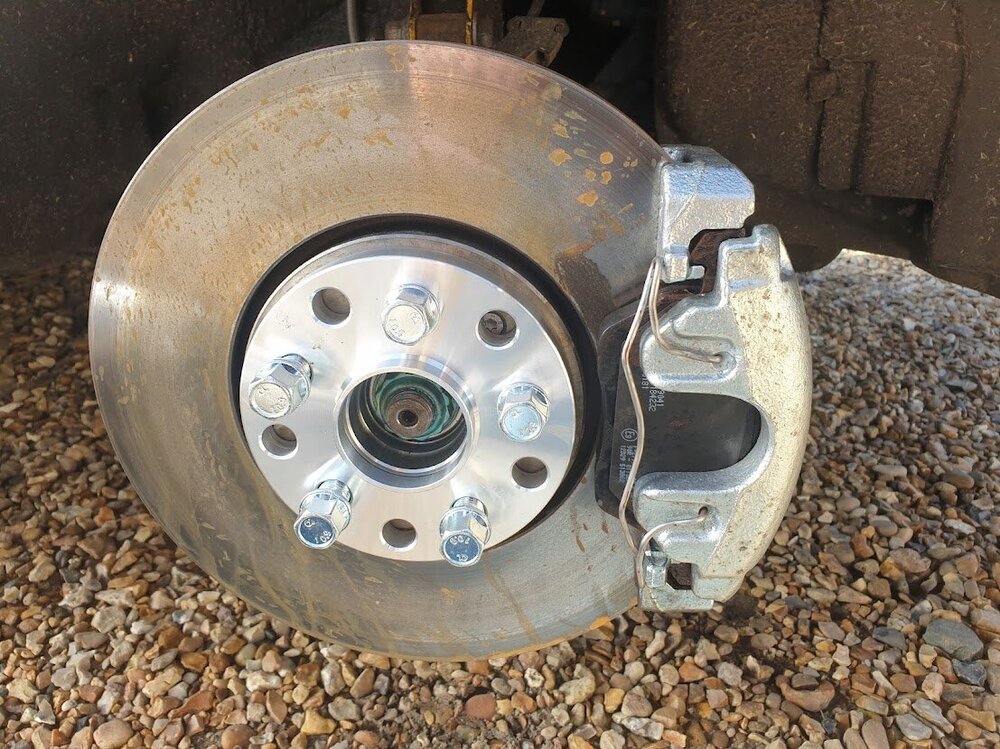

_Matt_ 20 Posted May 4, 2022 Hi, I'm getting an occassional clonk that reverberates through the spring. I can't make it do it by swerving on the road, moving about on the drive or by physically moving components with a breaker bar, but it seems to happen after the brakes have been applied and let off i.e. reversing off my mums drive - clonk, pulling out of a junction after coming to a stop - clonk. Initally, and before I noticed it was after the applying the brakes, I thought it was probably ball joint related so changed them last weekend. I suspected them anyway because I bought them second hand (unused) in a parts buy and the steering at speed didn't feel as tight as it did prior to fitting those parts. That steering issue has been fixed with the replacement ball joints but the intermettient clonk has not. Prior to all of this I had a bit of work done on the corrado last month after that work the clonk appeared - new top mounts, new ball joints, new bearings and the fitment of Big Redd refurb'd 288 calipers. Most of the other components have less than 3,000 miles on them (outer cv joints, inner and outer track rods, all bushes, shocks and springs). There is no movement in the usual 3-9 and 6-12 rocking and no play with a breaker bar on the bushes or any play on the shock / spring on side to side movement. Probably should have just done the work myself since I am having to do it anyway but was trying to save time and wanted the car nice for summer, plus having faught removing the driveshaft from the hub on a mk3 5x100 car i did not want to be in the same place with the Corrado - they glue them in from factory! Anyway history over - I am now suspecting the calipers and pads not retracting properly causing the clonk on release. Anyone had this - is there something better than copper grease for the ears of the calipers assuming it that? Cheers Matt Quote Share this post Link to post Share on other sites

Dox 18 Posted May 4, 2022 The spring thingy is fitted to the outside of the caliper? Quote Share this post Link to post Share on other sites
_Matt_ 20 Posted May 4, 2022 Cheers! The springy thing - ah yes it is now BUT I forgot to take it with me to the garage so had to drive back 80 or so miles without it. I went to Stealth as they did lots of work to car previously and wanted a once over as well, I know seems mad driving that far for this type of work. I'll grab some ceramic grease in the meantime as it sounds like its time to strip them off and refit. Mayve the pads shifted out of shape without the springs in place now you mention it. Quote Share this post Link to post Share on other sites
fendervg 24 Posted May 4, 2022 Check none of the pistons are seized - the front pads should also have a spring clip with 3 legs attached on the pad facing the piston that sit into the pistion seat itself. Also the calliper sliding pins should move freely, especially on the rears. Quote Share this post Link to post Share on other sites
_Matt_ 20 Posted May 4, 2022 Is that on the 280s fen? I don't think the 288s have he spring clip like that. The calipers them selves are freshly refurbished by Bigg Redd, i will check the slide pins for good measure but hoping they've done their job right! Quote Share this post Link to post Share on other sites
Dox 18 Posted May 4, 2022 288s will have the clip into the piston. The carriers hold the pads, were thes refurbed / new? Quote Share this post Link to post Share on other sites
_Matt_ 20 Posted May 4, 2022 (edited) Yeah refurbished at Bigg Red but they were used before hand. I'll strip the off and reinstall as next game plan - those front springs were not installed for the first 80 miles and I can see the piston section could rotate without them. Maybe that has happened and they are out of alignment. Edited May 4, 2022 by MJA Quote Share this post Link to post Share on other sites

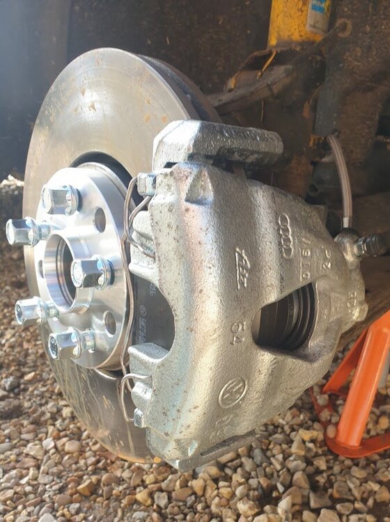

_Matt_ 20 Posted May 4, 2022 another pic - this was taken when i got home and put the springs on Quote Share this post Link to post Share on other sites
fendervg 24 Posted May 4, 2022 Yeah, the 288s should have a spring clip bonded onto the back of the inner pad that sits into the piston. Are those spacers on there? Just wondring if they coudl be causing an issue with clearance, but unlikely - assuming you are runing 16/17s Quote Share this post Link to post Share on other sites
_Matt_ 20 Posted May 4, 2022 Ahh i see, i'm not on the locating lugs assume so - Vince/team fitted them. They are 20mm spacers matching bolts for oem speedlines. The wheel weights were hitting the calipers intially so tthat and aesthetics was the reason to fit. I do have 16s as well that don't require the spacers - worth a try to swap them over as well. I do torque the bolts to 120nm. Quote Share this post Link to post Share on other sites

fendervg 24 Posted May 4, 2022 (edited) I run 15" OEM Speedlines with 288s with no fouling issues - it's tight, but the tyre shop just used a different profile balance weight and put somewhere else on the rim. Edited May 4, 2022 by fendervg Quote Share this post Link to post Share on other sites

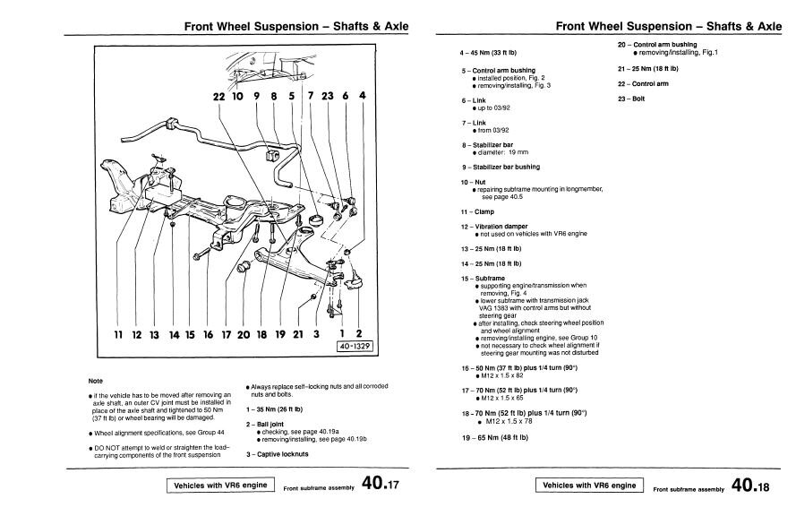

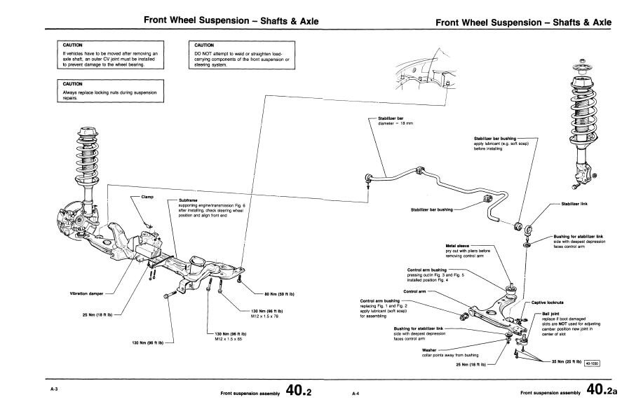

fendervg 24 Posted May 4, 2022 Some torque settings to be found here: https://wiki.the-corrado.net/torque_settings_and_bolt_sizes.html Quote Share this post Link to post Share on other sites
_Matt_ 20 Posted May 4, 2022 Cheers I'll check the torques and play - i don't think that link has the torque for the wishbone bushes unless I am blind (could well be.. ). Quote Share this post Link to post Share on other sites
fendervg 24 Posted May 4, 2022 (edited) For 4-cylinder cars Edited May 4, 2022 by fendervg Quote Share this post Link to post Share on other sites
fendervg 24 Posted May 4, 2022 (edited) This one for the VR6 "plus-achsel" wide track suspension Edited May 4, 2022 by fendervg Quote Share this post Link to post Share on other sites
Dox 18 Posted May 4, 2022 I've seen bushes that literally fall through wishbones being slightly undersize causing a knock on a neighbours A3. Toby can have issues with people reproducing diagrams from manuals (not naming names as their searches look for such names). Quote Share this post Link to post Share on other sites
fendervg 24 Posted May 4, 2022 I can remove if needed - I think one or two pages should be fine for fair use, it's not the whole book after all. Plus I can prove I own one and paid for it. If it's an issue let me know. Save as Quote Share this post Link to post Share on other sites
_Matt_ 20 Posted May 4, 2022 (edited) mega thanks on that - took copies if you need to take it down. Interesting so it's 18 i am referring to 70NM + 90 degrees but on the mk2 it is 130NM for all wishbone bolts. That is quite some difference. I'll check everything on my Corrado for torque with this info. It is going give me a headache on my mk2 16v (ABF block, KR fuelling) where I am installing a mk3 subframe with 4x100 arms - i guess i will take the 130NM route. Having fouling issues with bonnet and mk3 rear engine mount can be chopped down if needed to aid clearence. Edited May 4, 2022 by MJA Quote Share this post Link to post Share on other sites
