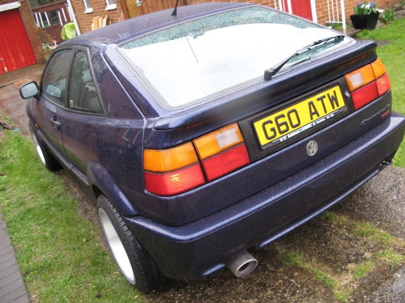

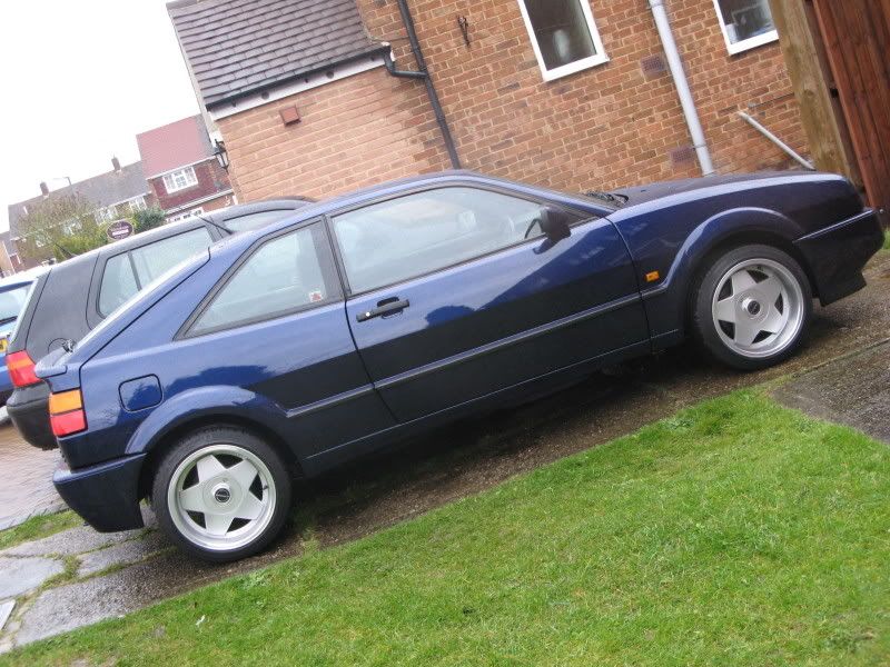

andyzplace 1 Posted March 20, 2008 Im confused about this too. I picked up some Borbet A's last weekend and im getting confused about tire size choice :? I had a good search last night and finally got set on some 205 / 40 / 16s all round but after reading some old topics it seems they could be dangerously narrow for the 9" rears :S Oh, and if anyone could let me know if the FK AK coilovers fit with no rubbing then that would be great cheers. (the offsets are ET15 rear and ET20 front and there going on a valver) Andy Quote Share this post Link to post Share on other sites
Guest Posted March 20, 2008 I just fitted 9j Borbet A`s all round on my G60, i have had the rear arches rolled at the top part but not pulled, and there seems? at its current height (standard suspension) to be stacks of room front and back, im only dropping mine 30mm on Eibachs so clearance isnt really gonna be an issue for me. as for the FK and other coilover kits it does say on a few of them that the suspension may touch the inner part of the rim on really low settings and you need to space the wheels with 5mm spacers? personally i doubt you will get it low enough on 9j all round to have a clearance issue!! the 9j rims with a 215 tyre are Mahhhhhhhhoooooooosive! I have 215 40 16 Continental sport contact 2 tyres (bought from Eastcoasttyres at a superb price of £260 for 4 off Ebay :) ) once its dropped it will look better, but here it is at the moment :wave: Quote Share this post Link to post Share on other sites

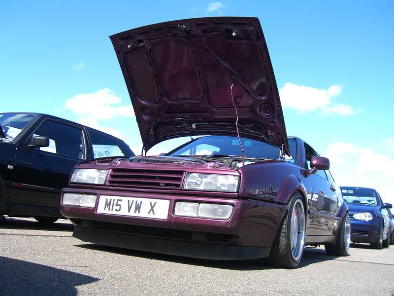

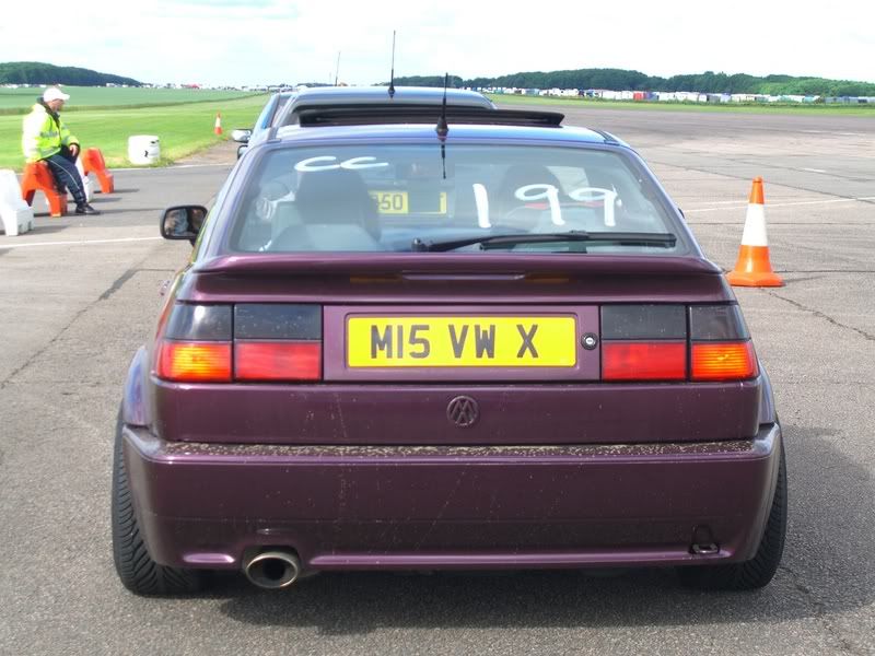

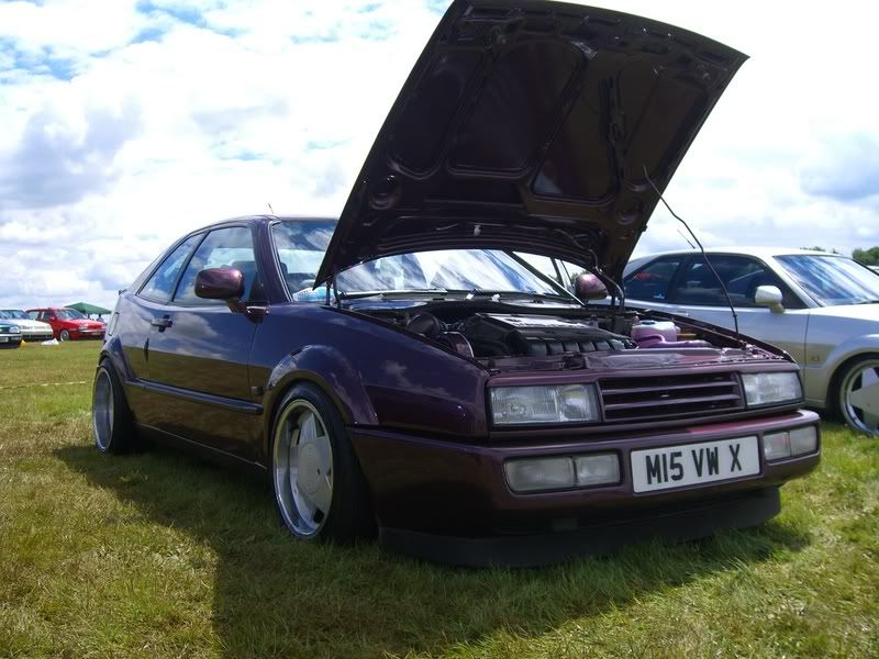

M15 VW 0 Posted March 22, 2008 Right, I think I've decided on the above wheel. I've done a few searches on here and found a few differen answers. Would I fit the 9 x 16's all the way round or do I need 7.5 x 16's for the front? I'll be on a set of coilovers of course! Also would a 205 stretch over the 9" rim? Depends what model corrado you have got - vr6 or 4 pot? and it depends on how low you want to go on the coilys? yes the 205 will stretch over the 9. I have 195/45/16 on the 7.5s on the front of my vr and 205/40/16 on the rear 9s on the back of mine. If you have a 4 pot, you can get 9s on the front, depending what drop you have got. If you have a vr, you can get 9s on the front but it is a hell of alot of work. I skimmed the rear disks which have the 9s on by 3mm and had the rear arches pulled an inch either side and skimmed the caliper carriers on the 7.5s on the front to get rid of having to use a spacer to get the wheels over the calipers. Quote Share this post Link to post Share on other sites
