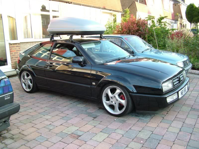

Which roof box is that, BTW?
It's a Halfrauds jobby... Can't remember the size, but it's one of the smaller ones they do. Peeled the 'Halfords' stickers off it the day I got it!
