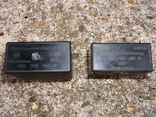

wilson 0 Posted August 3, 2006 Hey matey, the unit you lent me is different to the one on mine as per pics below Yours has A at the end of part no. mine has B. so didn't really get anywhere. but I have taken a copy of your book, that is real helpful, and if I can get the right part I'll have another go.. has anyone got a spare B with the spades below that I can borrow? Thanks mate, I'll get my g/f to take yr bits back to work and then we'll go from there. Thanks again Quote Share this post Link to post Share on other sites
2cc 0 Posted August 3, 2006 Was looking to see how you were doing, but this says it all Yep, deffinetly a Corrado... :lol: Quote Share this post Link to post Share on other sites
wilson 0 Posted August 3, 2006 Was looking to see how you were doing, but this says it all Yep, deffinetly a Corrado... :lol: Doesn't it just :lol: Quote Share this post Link to post Share on other sites
Supercharged 2 Posted August 3, 2006 Oh - yeah that is a bit different, must admit I thought there was only one type... Quote Share this post Link to post Share on other sites
