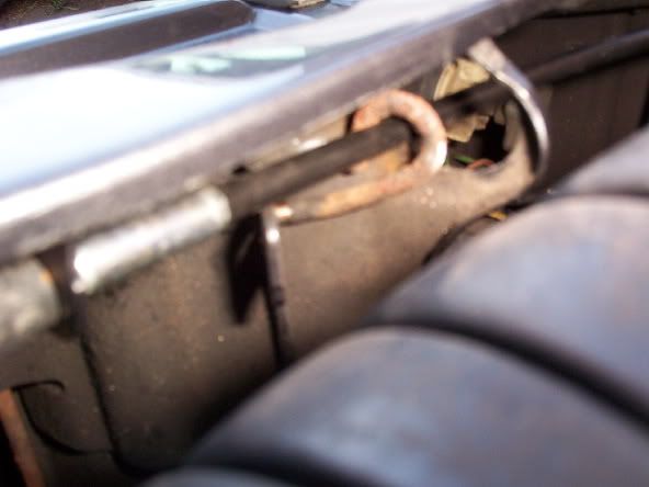

i bought the corrado and it didnt have one fitted, (must have broke and was removed) ive bought a new one and i could get it to work the n/s release but havnt got a clue how it works the o/s release, (i think i have something missing), can one of you lot take a pic of yours so i can see where im going wrong??, heres what i mean:'
o/s behind charger, i know this is wrong is there something missing??
n/s i could get this to work if i bent the cable back and crimped it but how is it supposed to be done??
any help appreciated as i cant close the bonnet or i will be stuck.

Yeah i think youre suppose to have a plastic bit on the end of the wire goes through the small loop the wire feeds through. Its tapered and can be tightened or loosened to adjust. look on ETKA
Yes m8 you have bits missing.
Have a look in the Knowledge Base, Clutch & Timing Chains Pt2, near the end, there is a pic of "Bonnet Release Cable"
But you will still need to source the bits, either new or a wreck. Expect goof uses the same bits so should be loads around
