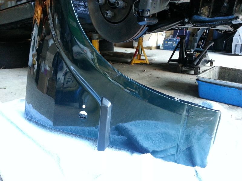

Jim Bowen 1 Posted September 7, 2012 Hi again internet. Put some more bits on the car, new brake shields Then fitted the brakes, Didn't bother doing anything about the rust on discs, rebuilt the calipers again with fresh paint Started repairing the wings now, all the holes and bits have been welded up, i've just got to do some paint Quote Share this post Link to post Share on other sites

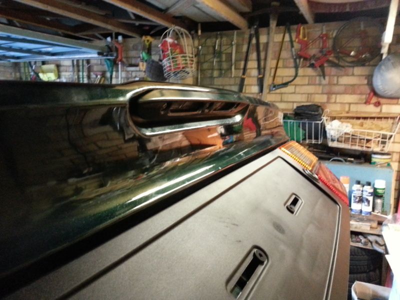

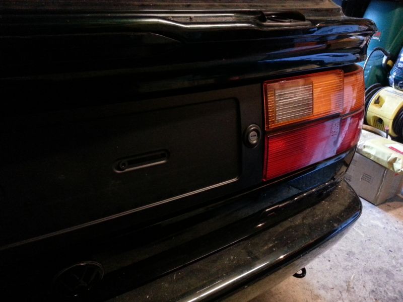

Jim Bowen 1 Posted September 20, 2012 Some more photos, nearly there now, looking forward to having it back. Wings are both repaired now, and rust free, i did stick them back on car but not taken a photo for the album yet Tailgate is also finished Quote Share this post Link to post Share on other sites
