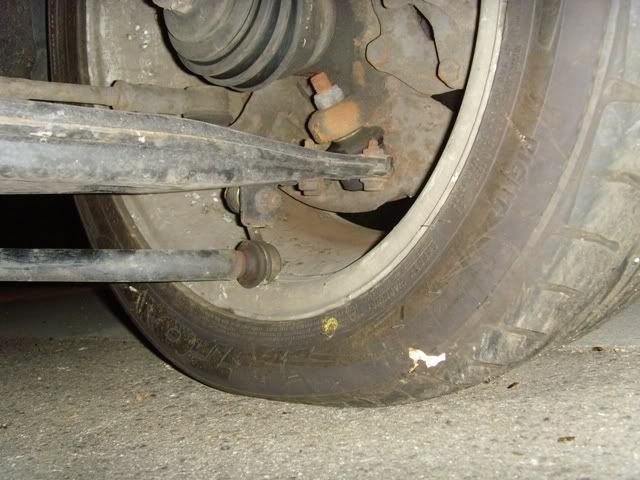

chichee 0 Posted April 27, 2007 just posting some pictures to show exactly what i mean. what i think and looks like the droplink is clearly in contact with the wheel. unless anyone has other suggestions? having checked the car when i have the 17s on, that bar at the very bottom does look very low and makes me think that it should be that low. someone has suggested to me that i could perhaps get around the problem by using the spacers to place the wheels out a little further. is this a wise suggestion? Quote Share this post Link to post Share on other sites
CazzaVR 0 Posted April 27, 2007 Looks like the droplink is on upside-down! :shock: The ARB should be above the wishbone! Quote Share this post Link to post Share on other sites
chichee 0 Posted April 27, 2007 oooooooooooook.....that will explain it then.......can anyone else confirm this??......if this is the case....off to GSF to get new discs/pads/braided hoses and new droplinks for the car to be fitted tomorrow. or can i reuse the drop links or better to get new ones?? Quote Share this post Link to post Share on other sites
CazzaVR 0 Posted April 28, 2007 Might as well get new ones as they're pretty cheap. Quote Share this post Link to post Share on other sites
chichee 0 Posted April 30, 2007 Looks like the droplink is on upside-down! :shock: The ARB should be above the wishbone! so according to this, the droplink/ARB should be where the yellow circle is?? Quote Share this post Link to post Share on other sites

chichee 0 Posted May 1, 2007 thanks for the picture......well my neighbour was kind enough to fit new ones on for me today and to set them up the correct way. so now the wheels are on!!!!! Quote Share this post Link to post Share on other sites
CazzaVR 0 Posted May 1, 2007 Nice neighbour! Glad it's sorted :) Quote Share this post Link to post Share on other sites
