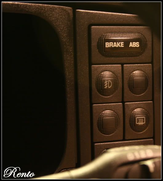

Here are the foglight pics at last :)
The interior pic shows the switches.
One on the left does fronts only.
One on the right does front and rear.
Hope this helps you guys.
Have a nice day :)

Thanks. I'd like pics as we were wondering what they look like. We have a few tutorials layinf around but not enough people have sparked interest in doing the modification.
Also, we do not have a switch for the rear fogs, however our Corrados came pre-wired for them.
Are you sure? I bought the Euro fog switch...I didn't notice any extra wires when I hooked up the fogs as brake lights.
Yeah, i'm not sure... a lot of places I read you gotta run another wire or something.
But you're saying your C came 100% wired and everything? All you had to do was install the euro switch and done?
My car had no such wiring. I used the fog light sockets and wired them up as extra brake lights.
I don't think US cars come prewired. The tail lights have the sockets for the bulbs, but no wiring is present.
