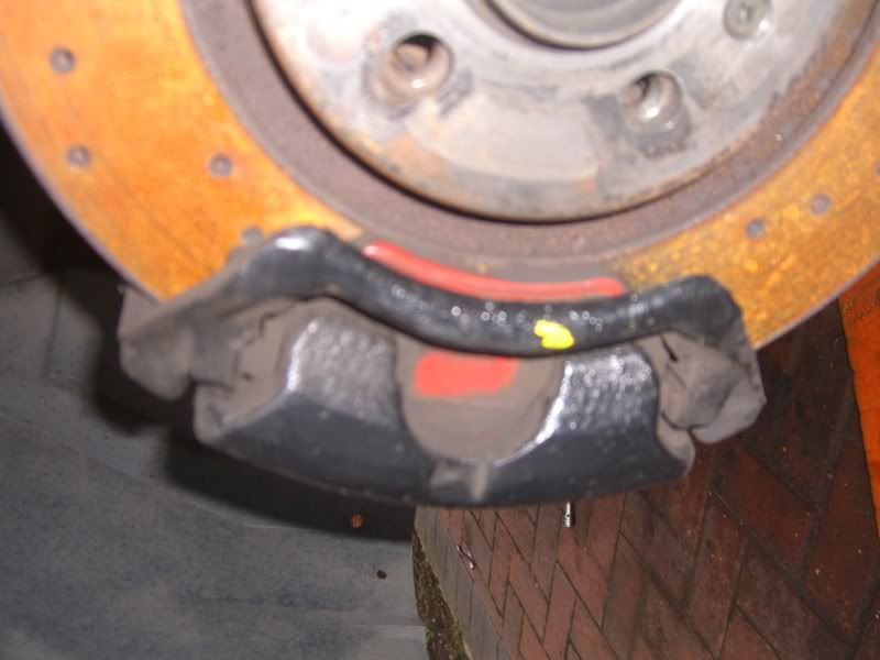

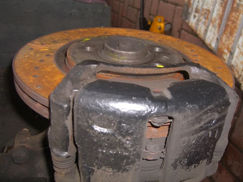

on my calipers it has a bar that gose from top to bottom of the caliper which is causing my problems, ive highlighted it here :lol:
is that what you shaved ?
The bar needs to be shaved about 2mm lower than being flush with the caliper. Then take that 2mm off the face of tat caliper also.
an that will be safe :shock: if so, thanks very much :D

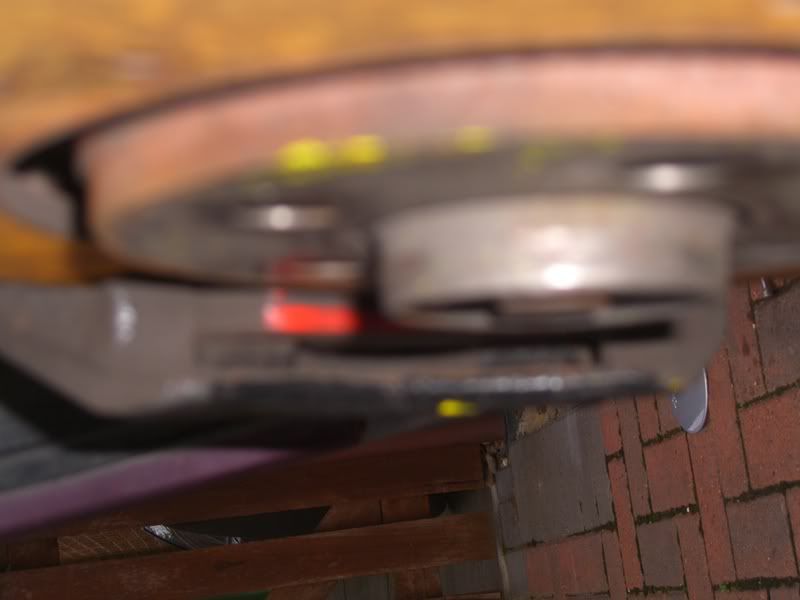

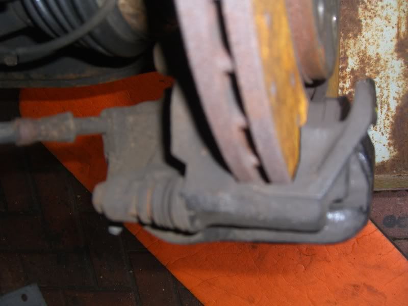

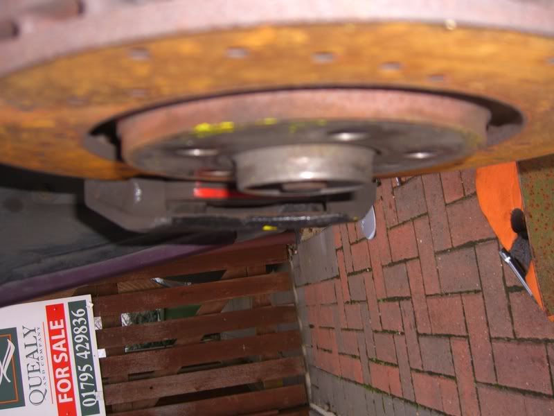

well ive done on side :lol: took me a few hours as a lot of trying the wheel shaving the caliper was repeated
but these are the results :shock:
before
2222693703_44fe326e93.jpg?v=0
now :lol:
2222693681_db7b39ff9b.jpg?v=0
but it fits now, although there was a little catching i have to sort.
