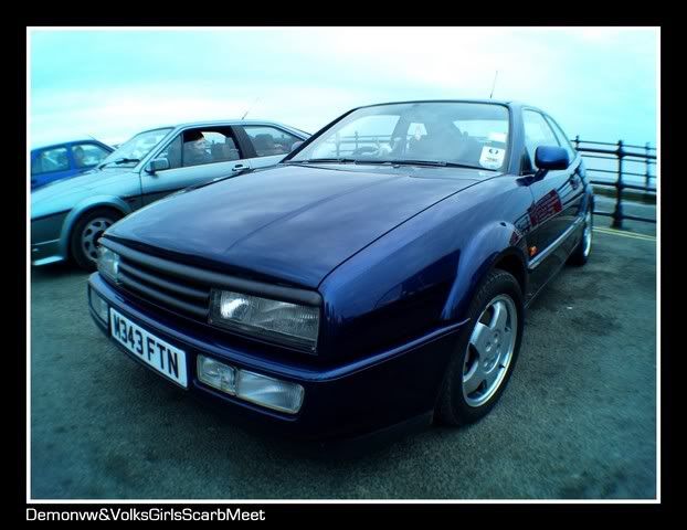

Pic from top and close up, have you got any pics of have your looks?
this is the only one i have, to me it just looks as if its not sitting right, as i say if it looks right then thats fine ill just have to stick it in a bit better, then ill have to decide if i wanna spray it or leave it this colour before i stick it down :)
I think the Reiger 3 slat looks different on a VR6 and makes the VR6 look different..
I have often thought this, I reckon its cos the VR6 is a 'Fatter' car. The bonnet curve n heavier wings don't give it as sleek a look as the earlier 4 pot cars.
Its prob sitting pretty well, maybe best to look at other Vr's to compare like for like.
