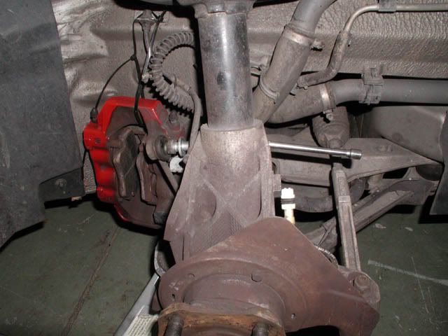

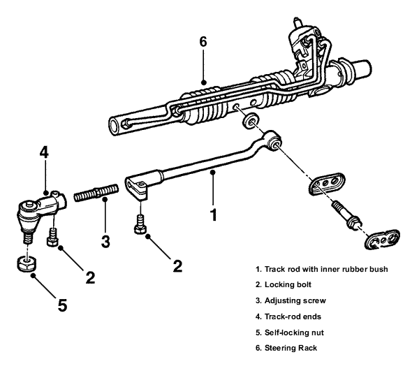

cheers guys i wasnt sure if it looked like this or anything?
found this pic on the web and it confused me a lot!
i dont need any tools or anything then i just undo the track rod end at the hub and slide the old boot off and put the new one on. i take it it looks something like this??

Firstly, that definitely isn't a Corrado steering rack! the track rods come out of each end. Stick your head under the car and you'll see what I mean.
if you're taking the track rods completely off you'll need a ball joint seperator and some decent spanners to get it away from the track rod.

scratch all of that, the wheelarch picture you posted doesn't look like a corrado one, at least the hubs are different? very odd.
More info needed cardboard!
lol sorry the car is at my parents currently so was unable to have a look. i just pulled those pictures of the web.
