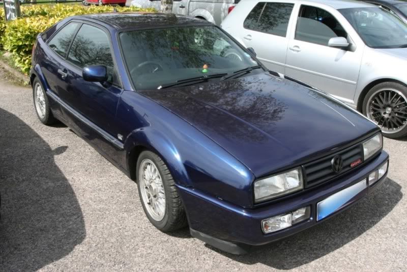

here we go some pic's :
(even though the images are only 800 wide they seem to be getting cropped so I have left a link as well)
rado3.jpg?t=1221077887
http://i266.photobucket.com/albums/ii274/hawky84/rado3.jpg?t=1221077887
only thing that has changed since this pic is the G60 badge is now black

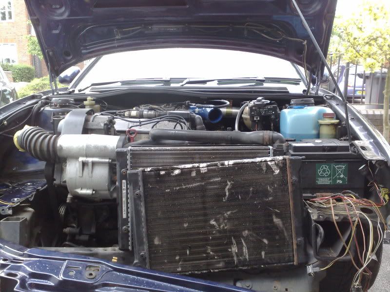

fairly dented but working and massive second rad
18062008373.jpg?t=1221077891
http://i266.photobucket.com/albums/ii274/hawky84/18062008373.jpg?t=1221077891
sweet fitting of second rad leaves inlet and outlets with plenty of room
18062008375.jpg?t=1221077890
http://i266.photobucket.com/albums/ii274/hawky84/18062008375.jpg?t=1221077890

first fit of charge cooler pipe work
18062008378.jpg?t=1221077888
http://i266.photobucket.com/albums/ii274/hawky84/18062008378.jpg?t=1221077888
charge cooler set up for now still with cr@ppy pump and no header tank
need some advise from any one with a charge cooler set up as to what pump to go for?
I have seen a nice meziere 30GPM 12v pump but that is $500 which is a little too much for my pockets
I have also found a place selling the R32 Aux pumps for $100 so with postage customs n all that it seems like the best option, does anyone know how much and where to get them from here in the UK?
Also does anyone know a good rad company? I'm looking for the same size as the 1.6 golf one I'm using at the moment but want to use larger core with bigger gaps between for better air flow to the main rad, just like a intercooler design.
last but not least, anywhere that is any good at alloy fab to make a custom header tank to go in the scuttle?

Cheers JMC I'll try and dig out a couple more shots of the rest of the work at some point, yeah I really want to get the charge cooler set up properly, the pump is the main issue as the current one just doesn't flow enough water, header tank is just a nice to have really.
There's a company near Glos called Allisport. They do alloy fabrication.
I'm really interested why you have chosen to go for a charge cooler instead of an intercooler. Surely your setup will weigh a hell of a lot more than just a front mount intercooler, due to the extra parts and the water? Whats the benefits of it? :scratch:
throttle response is very good and to be different :D plus it wont weigh as much as a VR engine :) I'll take it all off and weigh it (including liquid) and I think you will be supprised that it isn't an extreme amount of weight. Plus there are no sharp bends in the flow from the charger to the thorttle body. The main reason though was because I got it dirt cheap and it is far better than the original intercooler, it doesn't feel slow I can asure you of that.
