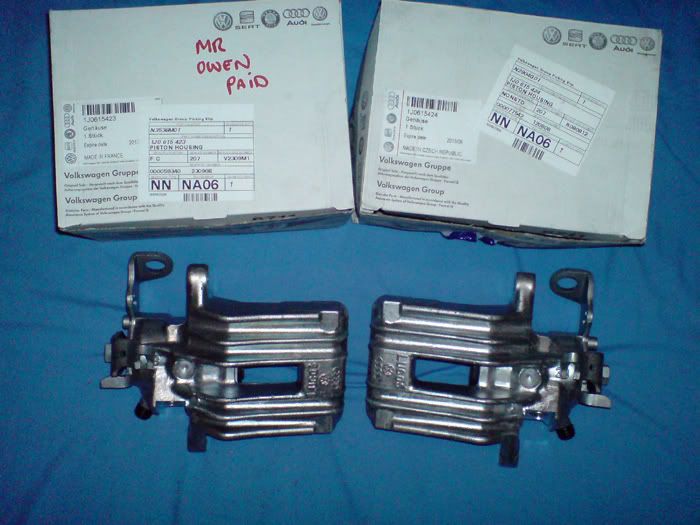

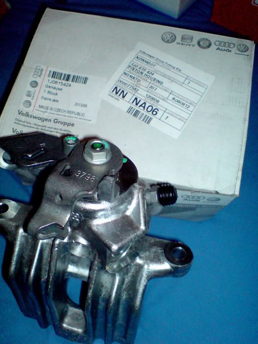

Jim Bowen 1 Posted September 25, 2008 (edited) As with the front brake thread, i'm still in the middle of doing this, hoping to fit everything next week. Just wanted to compile all the info i've found out with your help. Should help others and they won't have to make 100 threads like i do :lol: I was refurbing some corrado rear calipers i bought, but halfway through discovered how naff they are and prone to seizing, i've had lots of annoyance with my handbrake and been informed the mk4 calipers are much better. WHAT YOU NEED: Mk4 Golf Calipers = VW Part numbers: 1J0 615 423 & 1J0 615 424 = £76.50 + vat each They fit the standard corrado carriers, so no need to change them, but you may want to get some slider pins (depending on condition of yours) these aren't availiable seperately, you have to buy the whole carrier. I got a 2nd hand set in good condition, so i can reuse the best out of the 8 i will have once i've taken old brakes off car. (note the two different types, one type has a flat area running down The golf calipers also use the standard corrado discs and pads, so just buy them to suit your car. DISCS -To suit Standard corrado, non vented discs. PADS - To suit Standard corrado pads REAR WHEEL BEARINGS: Not sure these have to be done, but they are pressed into the discs so easier to replace then messing around getting old ones out. VW Part number: 191 598 625 = £16.32 + vat each (you need 2no) REAR BRAKE HOSES: The golf calipers don't use the same fittings as the corrado, so you need a Goodridge hose set, called a mk2-mk4 conversion kit, meant for a mk2 golf, and are a banjo fitting instead of the screw in hoses. Goodridge Part number: SVW0506-2P HANDBRAKE CABLE: Optional really, but i'm getting new as i'm doing most other stuff. VW part number: 1H0 609 712E = £11.32 + vat each (you need 2no) If i've missed anything or got anything wrong feel free to tell me, as i'm no expert Edited March 19, 2012 by Jim Bowen I moved photos on photobucket, so fixing the broken links Quote Share this post Link to post Share on other sites

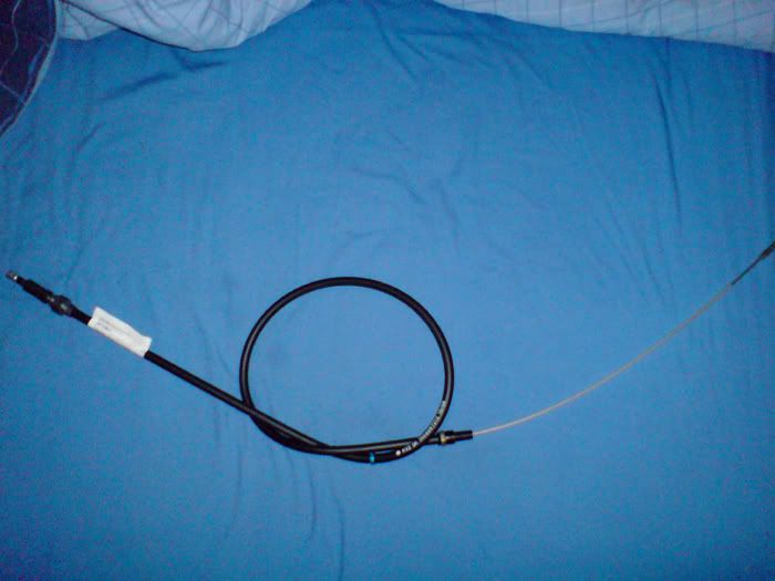

Supercharged 2 Posted September 25, 2008 ABS rings MK3 Carrier and standard caliper bolts MK4 Clip for the handbrake cable Maybe brake sheilds and stub axle bolts and bolt cover? Quote Share this post Link to post Share on other sites
Jim Bowen 1 Posted September 25, 2008 whats the mk4 clip for the handbrake cable? will i need them? :lol: ffs :( am not doing the ABS ring.... also whats the mk3 carriers and bolts for? don't tell me i need them aswell :( Quote Share this post Link to post Share on other sites
BigTartanJudge 0 Posted September 25, 2008 Feck, £179.78 just for the calipers, surely they can be had cheaper from elsewhere other than VW ?? I have all the bits bar the calipers and the carriers ? Can the carriers be bought new direct from VW and any idea of prices mate ? Called Big-Red and they can do new ones, fully powder-coated in red or other colours for £165 delivered (as long as you send them old calipers back) or £205 delivered (if old ones not set back). Black ones are £125 delivered (no surcharge) or £165 (surcharge inc.). Standard finish (electroplated) are £140 delivered per pair (no surcharge) or £180 delivered (surcharge). Think will end up getting the Big-Red powdercoated red ones, if I send them back my G60 ones and a spare old MK4 one I have lying around will only be £145 delivered which is not too bad really, compared to VW price. Quote Share this post Link to post Share on other sites
Jim Bowen 1 Posted September 25, 2008 i looked around for alternatives to buying from VW, phoned biggred and they had one new one and one refurbed one, and wanted £156 for them, without sending anything back ebay only turned up some that looked non-genuine to me. i asked about the carriers and they were £60 each iirc, thats with the pins and boots. I didn't want to spend any more money so didn't get them still can't undo the brake line on the front where it joins to car, think i've buggered the nut up now :( Quote Share this post Link to post Share on other sites

BigTartanJudge 0 Posted September 27, 2008 3corsameal, what model of MK4 Golf do those part nunbers that you posted up correspond to ? Can you use MK4 calipers from ANY MK4 Golf ? Just want to try and get them a bit cheaper than from VW or BigRed and have seen some for £55+VAT each but they have no part numbers just model type, Cheers Quote Share this post Link to post Share on other sites
Jim Bowen 1 Posted September 27, 2008 i'm not sure, i just got the part numbers given to me on here by supercharged (i think) when i went to VW originally the chap told me there was several different ones, i guess the later the letter in the number the later the model of car, maybe they kept revising the brakes? as i found ones starting with 1D0, 1H0, 1J0 etc ordered a nice brake line flaring tool, a skyes pickavant one, better be good as that was another £100 :( Quote Share this post Link to post Share on other sites

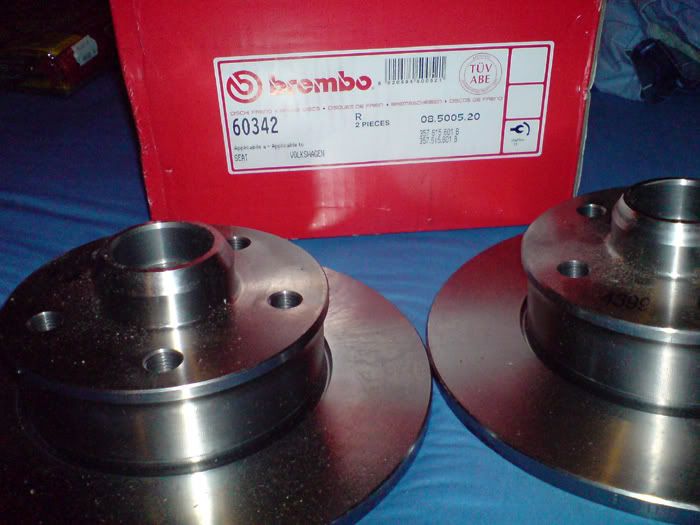

BigTartanJudge 0 Posted September 30, 2008 Just ordered a pair of alloy MK4 calipers for £103 delivered which was good price, and will paint them red myself. And seeing as I saved money here, ordered a pair or new caliper carriers and slider pins from VW for £127.04 delivered. So brake spec now will be as follows: Brembo 4-pot front calipers with alloy carriers 305x28mm front brembo slotted discs Brembo pads MK4 alloy rear calipers New VW G60 rear caliper carriers Brembo rear discs AP Racing rear pads Also have new bearings front and rear and new handbrakes cables to fit as well, should be a massive improvement ! Cheerds Quote Share this post Link to post Share on other sites

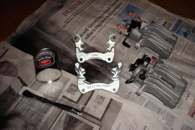

BigTartanJudge 0 Posted October 21, 2008 Mmmmm, new brake bits goodness, see below: BEFORE Going to attempt to paint red tonight, should look ok, will post "after" pics when done Quote Share this post Link to post Share on other sites
