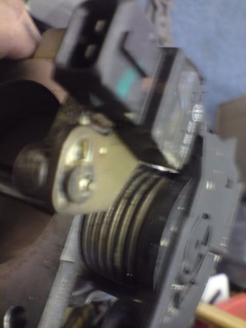

My car is running a custom chip from g-werks and was wondering if the WOT switch is still needed as i hear its normally mapped out?
Reason i ask, is im about to try and mod a singlebutterfly throttlebody from an ABF by welding a boost return butterfly in, and the ABf throttle has an idle switch but no WOT switch
What you reckon?
connection for ABF switch
I have just had a Chip at G-Werks and the guys there tested my Idle and WOT switches when they set up the car, so from that I assume they must still be used.
