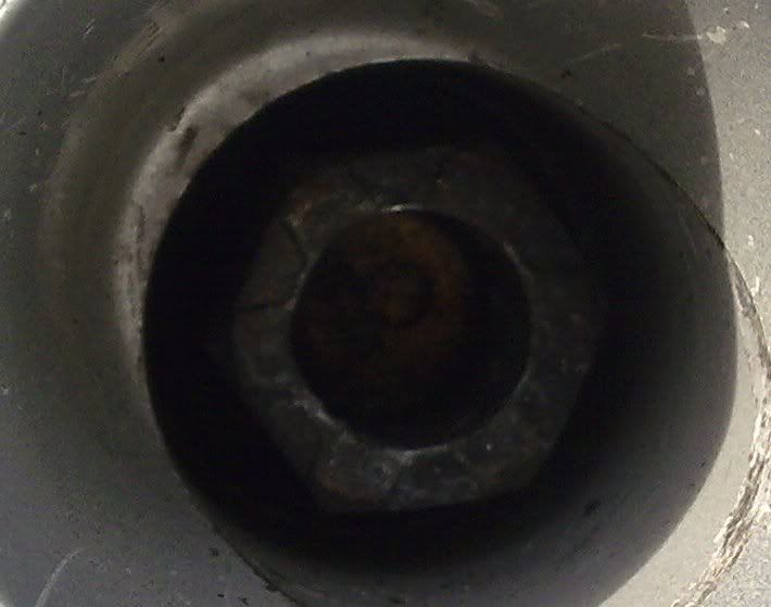

jonybravo 0 Posted April 8, 2009 Not sure if this is any help, I've managed to post a picture of one of the nuts Quote Share this post Link to post Share on other sites
BILLCOR 1 Posted April 8, 2009 Looks to me to be a standard 17mm VW wheel bolt, is your socket fitting right on? there doesn't look to be a lot of room around the head EDIT: just noticed your using a wheel wrench which will be pretty chunky? get a socket Quote Share this post Link to post Share on other sites
jonybravo 0 Posted April 8, 2009 ok, i'll try a socket, many thanks for the resonses Quote Share this post Link to post Share on other sites
Critical_Mass 10 Posted April 8, 2009 ok, i'll try a socket, many thanks for the resonses got this problem with the wheels i have on mine. A socket will def get them off, the wrench is too chunky to get deep enough into the hole (oo eer) and also tapers for the 19mm side. Quote Share this post Link to post Share on other sites

jonybravo 0 Posted April 14, 2009 managed to remove the nuts, used a 17mm socket in the end as suggested, cheers all :clap: Quote Share this post Link to post Share on other sites
