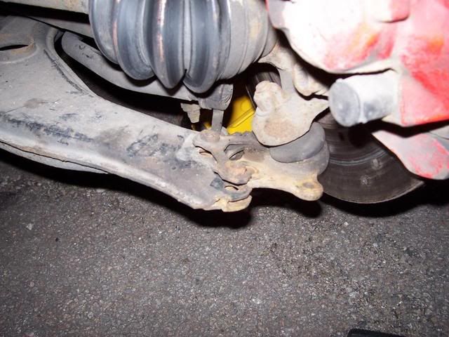

GaVR6in 0 Posted April 21, 2009 This is the problem see pic Does the bit at the end of the wishbone which has come apart come with the wishbone or is it a seperate item I need aswell. Quote Share this post Link to post Share on other sites
yeti 0 Posted April 21, 2009 the bot at the end is bolted to the lower part of the hub carrier and the wishbone and does come off and is easily replacable. use a see saw type ball joitn splitter (sorry dont know the proper name!) and it'll seperate off so you can slide it out - might need to relax the driveshaft though in order to pull it out from the wishbone! Tbh though when i've done this quite a few times in the past its a pita to get the ball joint out fron the bottom of the hub so what i've done in the past is taken the track rod off, driveshaft out and brakes off and pressed the connical shaft of the ball joint from the hub carrier Quote Share this post Link to post Share on other sites

GaVR6in 0 Posted April 21, 2009 Does anybody know the name of the part and do I need to replace the wish bone aswell Quote Share this post Link to post Share on other sites
yeti 0 Posted April 21, 2009 it really shouldnt be too bad, you will need the ball joint splitter if the wishbone ball joint has gone, if you want to keep this and just change the wishbone then its just nuts and bolts (and if i remember right the vr6 needs to be lifted slightly as it stops one of the botls coming out it might be a good idea to check out nomads mate, we're a friendly bunch of vw nuts and most people live in/around hertford/hemel, if you check out http://www.nomadsvw.co.uk there will probably be someone on there round the corner who might be able to have a look for you or come and lend you a hand - i would but i can this weekend! :camp: andy Quote Share this post Link to post Share on other sites

boost monkey 0 Posted April 22, 2009 Yes, those ball joint bolt plates are separate. They are called lock plates and are VW Part # 1J0407175 :salute: Quote Share this post Link to post Share on other sites
GaVR6in 0 Posted April 24, 2009 Well I have just finished replacing my ball joint and wishbone and to some that is probably like taking a slash but I am a novice so am quite pleased with myself. all in all I can see that it is an easy job really but it did throw up its complications for me but all done now. Quote Share this post Link to post Share on other sites
