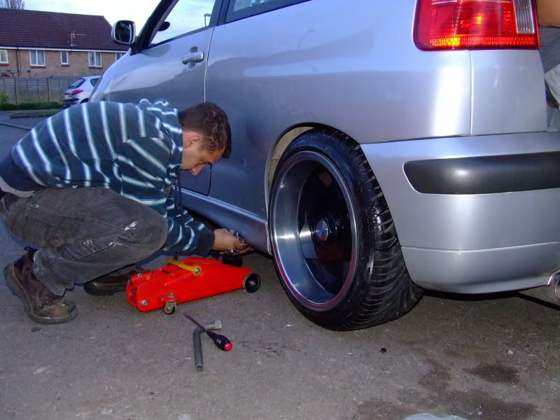

me and some mates done some borbets there where bad we only done the edging and took us allday and there didnt look as good as a professional but there looked ok :( ill upload photos
not a very good pic but im going to polish some engine parts next so get aq before and after
