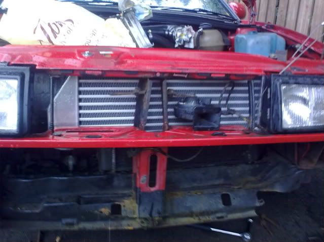

manps 0 Posted December 26, 2009 mimjed, i compared the iron it seems fine, i even used the old iron, still no luck, you know the front valence with is the metal plate that come towards you, it supports the rad at the bottom, should the bumper sit in between that or above, if i slip it between the bumper, the lower grill wont fit, i really need a pic of someones bumper with the lower grill moved, so i can get a good look where the valence should be sitting, if any1 can help, much appreciated Quote Share this post Link to post Share on other sites
mimjed 0 Posted December 26, 2009 sadly the most useful pics i have; all i have ever done with any front bumper is shove the irons in the holes (pic 2) and make sure the plastic rails inside the bumper slide on correctly near the wing. maybe you can highlight where the prob is to help get an answer Quote Share this post Link to post Share on other sites
manps 0 Posted December 26, 2009 hello mimjed, if you look at pic 1, you see the bottom. there is a metal lip that is coming out towards you in black, its to hold the reinformcent bracket and spolier together. that lip, how should that sit with the bumper on, should it go in between the bumper guard or above, Quote Share this post Link to post Share on other sites

Philmo 0 Posted February 11, 2010 Guys, where are these 2 bolts either side?! :confused4: They screw vertically up into captive nuts in the box beam each side of the bay. There's one each side of the smaller centre bolt which locates/attaches each end of the cross beam. If the centre bolts are in any way suspect, as recomended above, support your engine/gearbox. Best of luck! Quote Share this post Link to post Share on other sites
VR6 0 Posted February 11, 2010 http://www.the-corrado.net/.archive/forum/downlo ... &mode=view Quote Share this post Link to post Share on other sites
V-Dubstar 0 Posted February 11, 2010 http://www.the-corrado.net/.archive/forum/download/file.php?id=105&mode=view Brilliant thanks guys, VR6 that's pretty much exactly the same as the photo I was gonna upload!! Quote Share this post Link to post Share on other sites
