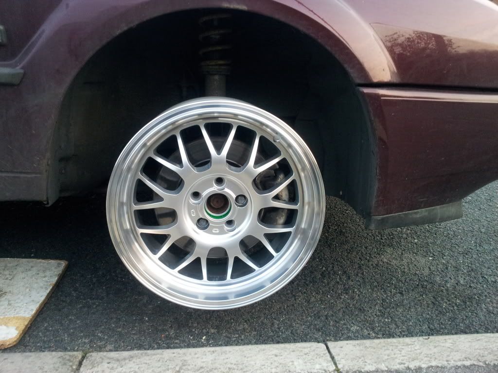

Critical_Mass 10 Posted March 20, 2012 Well im a little annoyed. Went to do a fitment check on the wheels on the car, before i went to go get the wheels swapped over and its a damn good job i did... as, yes youve guessed it... they DONT FIT! GRRR!!! :( The box on each wheel says 5 x 100 ET35! When i went to fit them they wouldnt go onto the hub as the brakes stopped them - looked on the back of the wheels and they say ET30. So they're going to have to go back.. and they better send the replacements out on next day delivery. Its a damn good job i didnt go to the tyre place to get the tyres changed over. Redborbet - looked at those wheel nuts again and found they fit perfectly in the 17mm wheel wrench socket, so looks like they're ok, just a different shape. The box they came in does say HEX on them, so im guess its just for looks. The hex socket can still be used on them. Quote Share this post Link to post Share on other sites

owen g60 10 Posted March 20, 2012 ummm... I think youre going to need some spacers as it is the mounting face that is fouling. raising or lowering the ET of a wheel just moves the mounting face and 'spokes' inside the rim, these generally move together giving more or less dish. I would look at some hubcentric spacers and longer bolts to move the mounting face away from the hub thus moving the 'spokes' away from the brakes Quote Share this post Link to post Share on other sites

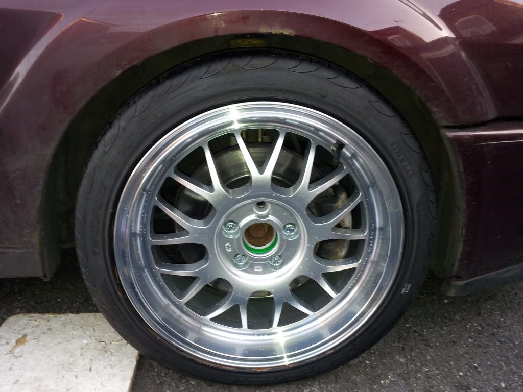

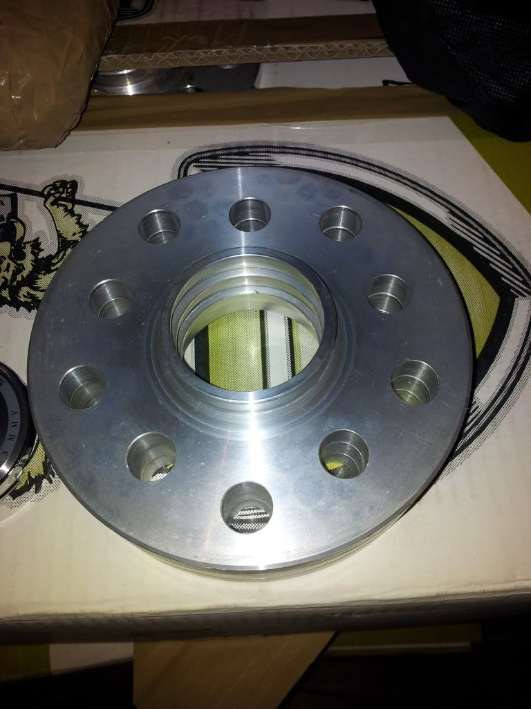

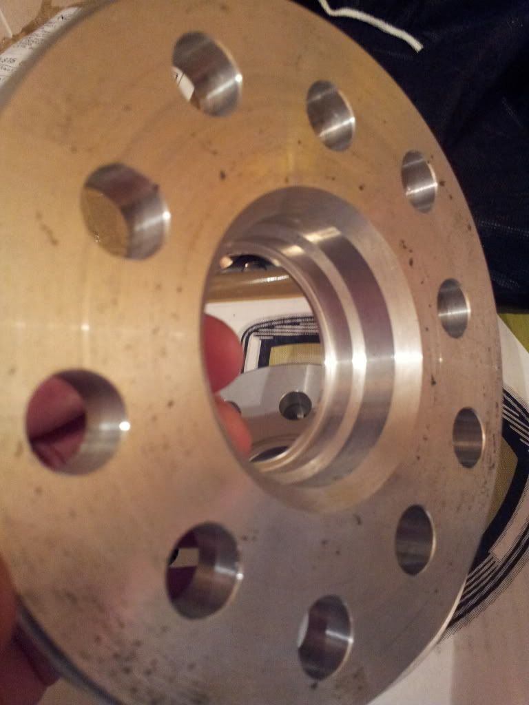

Critical_Mass 10 Posted March 23, 2012 (edited) Hi Guys, Got sent some 10mm hubcentric sent to me. The wheels now clear the brakes, by a good 5mm. Though now i fear, the wheel sticks out a tad too far, not alot but more than i would. Ive attached some pics. In the pics the wheel is turned ever so slightly to the right, so may account for some of the apparent poke. But its hard to tell without the car being on the floor which i cant do until the tyres are fitted, which i dont want to do until i know the wheels fit ring :lol: its a vicious circle. Im tempted to get maybe 3mm machined off the spacers. Edited March 23, 2012 by Critical_Mass Quote Share this post Link to post Share on other sites
owen g60 10 Posted March 23, 2012 That poke will be fine You may have to put a slight stretch on the tyres to get them within the arches As you can see from mine Quote Share this post Link to post Share on other sites

Critical_Mass 10 Posted March 24, 2012 right, this morning i went and bought some 5mm spacers and test fitted the wheel again ontop of the 3mm spacers i already have. Ive discovered i need 8mm spacers minimum - wheel is about 1-2mm clear of the calipers. So im thinking of just going with the 10mm spacers i was sent, which are also hubcentric. Though now looking at the wheel bolt im not sure its long enough. I have 35mm extended wheel bolts for the current wheels and including the spacer about 12mm sticking out the back. Am i right in thinking this isnt enough? Ive done a search on here and found as long as the length of thread sticking out is at least the diameter of the bolt it should be fine, but just looking for confirmation. Quote Share this post Link to post Share on other sites

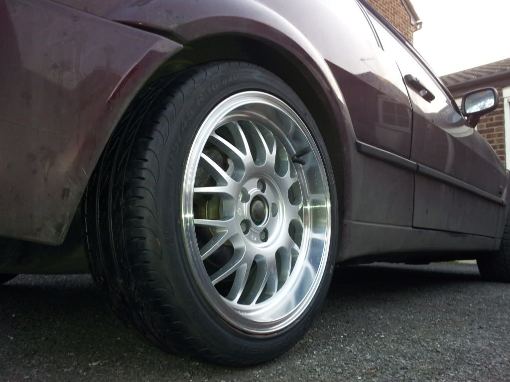

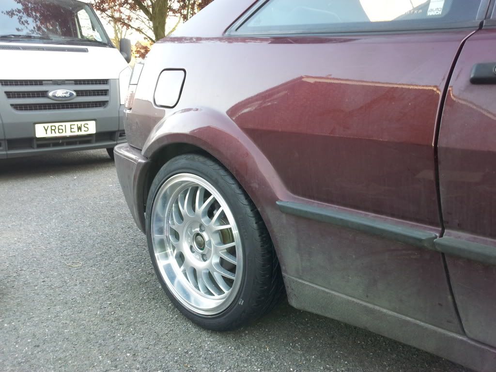

Critical_Mass 10 Posted March 27, 2012 Today i got a cheap part worn tyre fitted to one of the wheels, to see how the wheel sat with a tyre on and it on the floor. Went for a 195/45/16 tyre. Ive got to say the wheel look to fit alot better now it properly fitted. Havent taken it for a drive for obvious reason, so no idea if it will scrub on the front. But the rear looks fine. I will get some proper pics up once they're all fitted and ive given the car a much needed wash and polish. :oops: Here's a bit of a teaser for now - Quote Share this post Link to post Share on other sites
