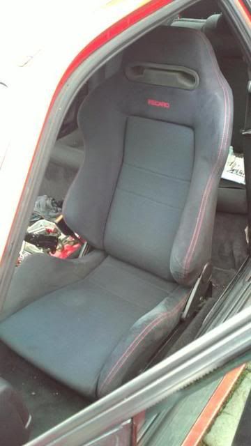

Just fitted black Honda Integra DC2 Recaro Speed's to my Corrado...

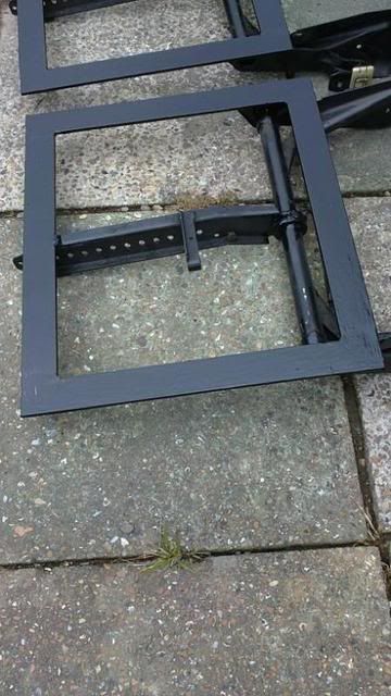

First one is to use your existing Corrado seats, this will involve cannibalising them so if youve got a mint seat of Corrado leather find either a pair of front lower seat subframes or a pair of doggy front seats - your going to be cutting the f**k out of the them so you dont want to use anything decent.
Essentially you want to use the rear side runners and the front slider and the bit of frame that joins them, the lower seat base that is welded to the top is scrap, you will have to cut it off with a grinder

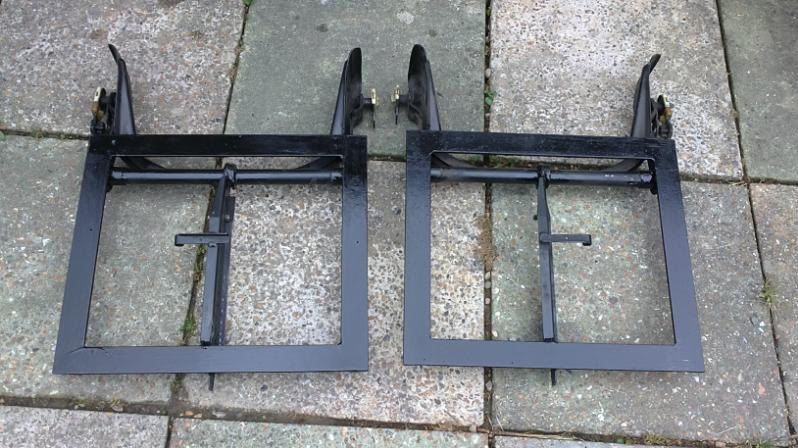

Esssentially this is what you want to end up with after youve had a mounting frame welded to the runners:-
Leads to this:-
Im going to get some more metal welded to the rear of mine as the seats need to move back about 2-3 inches, was difficult to explain to the fabricator on the phone as to where i wanted the frame mounted :D , bear this in mind when you get yours done, you want the frame to extend back over the rear rails a bit more.

choice is yours, my subframes cost me 50 quid to fabricate, i reckon another 20 quid to get the runners lengthened but obviously that was just trial and error.

reet verdict is in on the ebay specials and there toss :( . there way too wide to fit to my corbeau :( , they only fit cheap raceland seats. the welded is terrible and to my eye the level seems to be out in so many places. the sliders are kk tho lol, shame i already had them. they dont look safe to even put into the car in my honest opinion. the best way is to have them fabricated im goin to say, ive seen actual corbeau subframes for sale at 90+ quid for the corrado, has anyone used these or know of any one who has? might splash out if there a direct fit with no messing or if anyone has 2 seat bases avaliable hit me up with a pm. cheers
also tandino have u got measurements for the frame you had made just the length front to back as u needed yours extending, i know that left to right will depend upon your seats mounting points widths. :notworthy:
