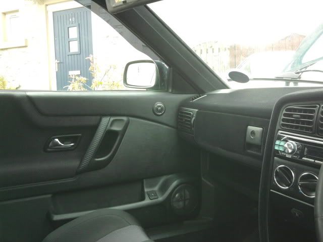

Pete 0 Posted May 19, 2011 (edited) I got the audio shop to throw in two sheets of the dynamat for half price with the speakers. Not sure about the Pyle kit? I thin for not much money you could get a set of components, like the Alpines I used for about £50 or something a little better like Infinity Reference/Kappa for 80-100 or so. You couid put the tweeters in the dash and the mids in the door positions.Will look nice and stock. Alternatively (and the way I would go) would be to mount the tweeters in the A pillar trim panels. It's a nice and flat panel, and you could use an angled tweeter mounting for a good soundstage. You can either surface mount them or sink them in if there is space. Beauty of this is that you can use the existing cable from the head unit to the door as your carrier to the crossover which is mounted inside the door, and then run new cable up inside the door to the mid and tweeter. No need to run cables from the door to the dash etc or try even touch the head unit install at all!!! Bit like this..... Edited May 19, 2011 by Pete Quote Share this post Link to post Share on other sites
Andy-H 0 Posted May 19, 2011 Aaaaaah, didn't realise you had beige leather. I think Pete's Idea is a good one for the tweeters, I thought of this myself but only after buying the components and they were the wrong type to mount that way :(. Quote Share this post Link to post Share on other sites
Pete 0 Posted May 19, 2011 Andy, must confess its not my car lol. I'm rocking the old-skool cloth at the moment, though the idea of caramel leather in my flash red car does make my fizz a little! I pinched this from t'internet. I went for these Alpines in my old Civic R, and was really happy with the sound. They were much better then the standard Honda coaxial's, and mounted the tweeters so they crossed the sound waves at head height above the gearstick. They were enough money to spend considering I didn't want to renew the cabling or even the Honda head unit and couldn't be bothered re wiring through the grommet into the back of the dash etc. Was a simple snip into the cross over and I stuck the xover to the inside of the door skin with some number plate pads and tape. The only evasive bit was the drilled holes in the A pillar but at £50 it's not like your going to be removing them when you sell the car! The other reason I like them is because the tweeters have no logos on them, so to the eye they look completely OEM ;) Useful living in Swansea and using the car as a daily driver! http://caraudiosecurity.com/shop/product/products_id/5324.html Quote Share this post Link to post Share on other sites

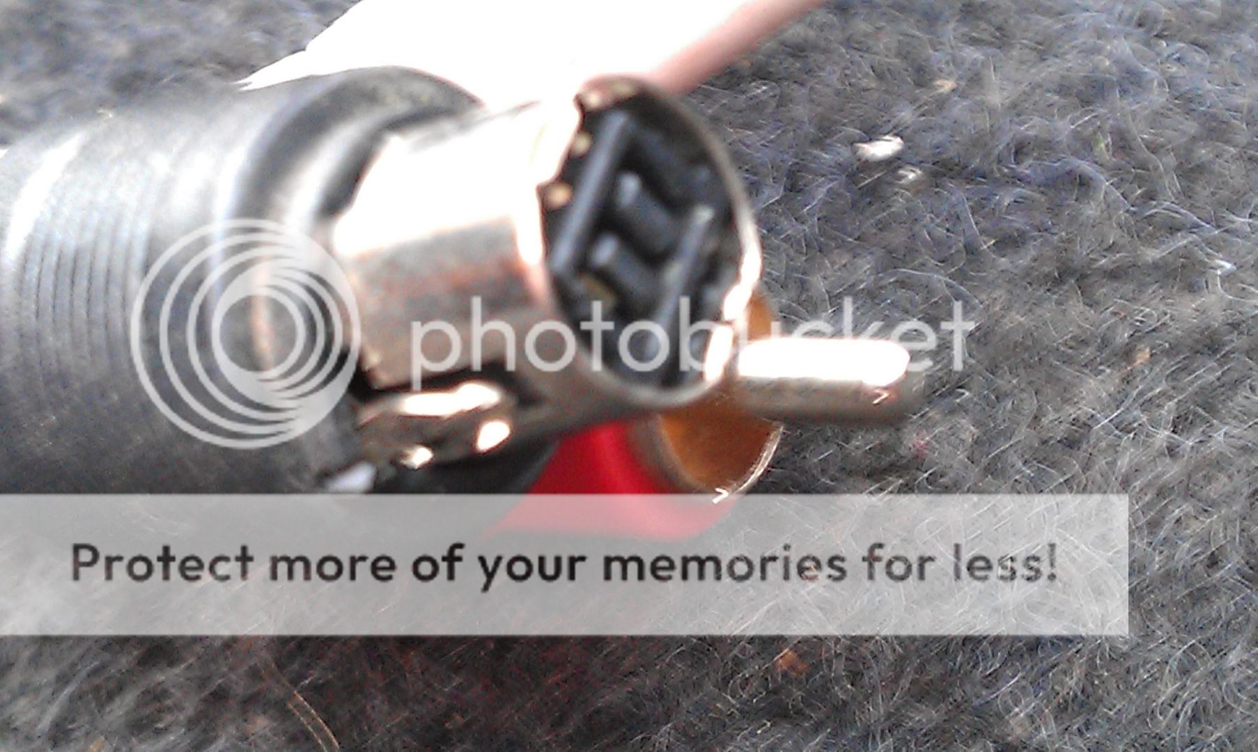

tony_ack 0 Posted May 21, 2011 I was planning to put the Pyles in today to see how they behaved, but I got hung up on swapping the tailgate. I've found the manual for the headunit, so I'm going to have a read through that too. Plan is... Try the Pyles first and try to adjust the sound output on the HU If it's still pants, then try some new speakers (Pioneers seem a good shout) If the HU can't cope with the new speakers, then try an amp (how much are you looking for mimjed?) ---------- Post added at 07:51 PM ---------- Previous post was at 07:36 PM ---------- Forgot to mention, I found this when the boot was stripped out earlier: Any idea what it is? Something useful, or a non-standard connector for something? It was accompanied by a L/R coax Quote Share this post Link to post Share on other sites
krishen 2 Posted May 21, 2011 The black lead looks like a cd changer cable. The red cable looks like a phono lead. Have a look around for a 2nd rca cable. Looks like there may have been a cd changer and amp in there at some point. Quote Share this post Link to post Share on other sites
Pete 0 Posted May 21, 2011 Agree with Krishen, it looks to me like a D-Bus for a CD shuttle. Quote Share this post Link to post Share on other sites
