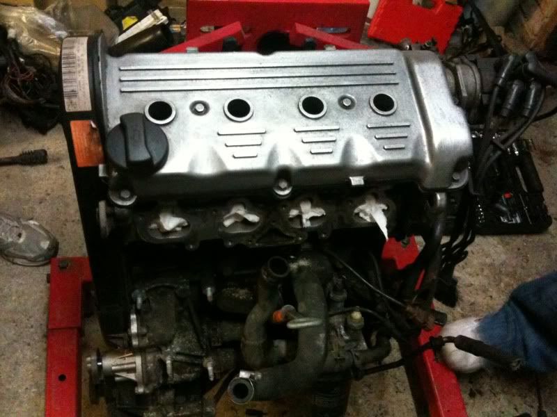

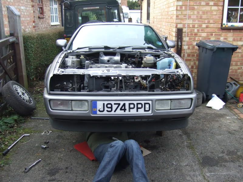

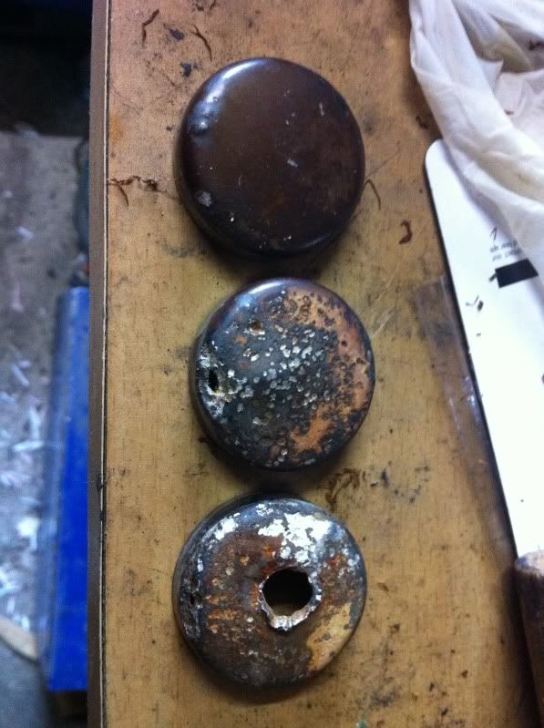

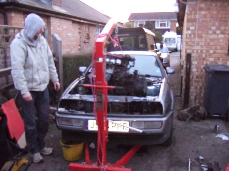

jacko 0 Posted November 23, 2011 So, a little update for you all... Last week on the way home from work in the cold and wet I noticed I had steam coming from under my bonnet and the temp gauge was rising rapidly, I was in the middle of nowhere and it was pitch black. I managed to coast it far enough to stop under a street light so I could have a look and see which hose had burst. After taking off and inspecting most of the hoses (and ruining my suit in the process) I discovered that they were all fine. Luckily, I always carry a 2 litre bottle of water in the boot just in case so I emptied it into the expansion tank to see it all end on the road shortly after. Somehow 1 of the core plugs had popped a 5mm hole in it, I’m guessing the previous owner of the engine didn’t put coolant into the system and just used straight water so it slowly rusted through. I didn’t think about changing the core plugs when the engine was replaced so it’s partly my fault. After spending several hours with screwdrivers, hammers, pry bars, bits of wood and a lot of blood trying to get the old plug out I gave up as there is absolutely no room to swing a hammer hard enough to make a difference to the shape of the plug to make it pop out, never mind getting the new plug in there. I thought, if 1 plug has rusted then the other 2 are probably on their way too so I arranged to borrow an engine crane and rip the while lot out and replace all 3 plugs. Started early Sunday morning, me and a couple of mates managed to get everything out the engine bay, replace the 3 core plugs and get it all back in and working again So here is a pic of the 3 core plugs... as you can see the 1 with the hole in it was the original failure which i made worse by trying to get it out the middle plug is close to failing too as there is a small hole at the bottom and the 3rd plug looks pretty new. It must of been replaced before i got the engine out of the mk3 gti. A job well done me thinks! 8 hours work for 3 little bits of metal that cost £6. Imagin the cost if i had taken it to a garage to get done! Quote Share this post Link to post Share on other sites
