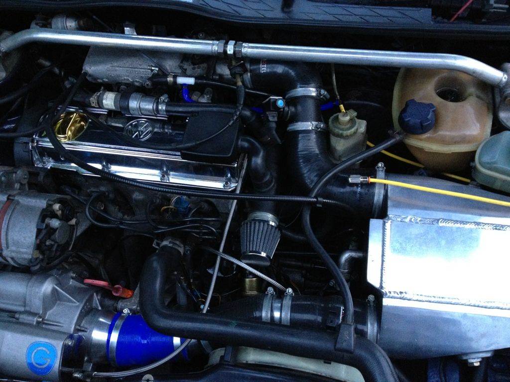

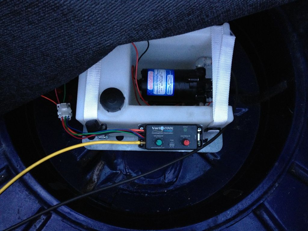

Finally finished the meth injection system, its set to begin at 9psi and be on full injection at 15psi and is currently on tune setting 1 of 10 which means at 15psi the pump is at 32.5% duty cycle.
I am running a 60:40 water to meth mix and this has a noticeable performance increase! It now feels like the engine has an added power-band when the pump kicks in and is just constantly accelerating.. It is pretty ridiculous to drive, but the g60 is in a 900kg mk1 golf and was fairly stupid on the gti gearbox as it was.
I am going to gradually increase the tune until I get to the maximum the engine can cope with. Others who have fitted these to G60's have said that at a certain tune level depending on engine mods the car seems to bog down at which point they drop it down to the previous tune level and keep it on that when I up it to the max I will post up what tune is best for others to find if they install the same kit with the same mods.
Heres some photos for y'all:

Forgot to mention the reason the hose is yellow is because I got some pneumatic grade hose from work that is used for high spec machinery so it is very durable and has no flex so the boost pressure should remain constant all the way to the controller and the meth/water pipe shouldn't spring a leak!
