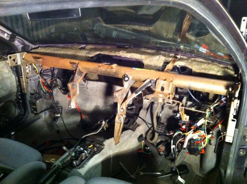

Awesome work Baz, ive just started pulling mine apart today, ive the whole inside out, and just starting on the engine!! Quite fancy the idea of a new dash, but dont know if i can be bothered at the mo!! LOL

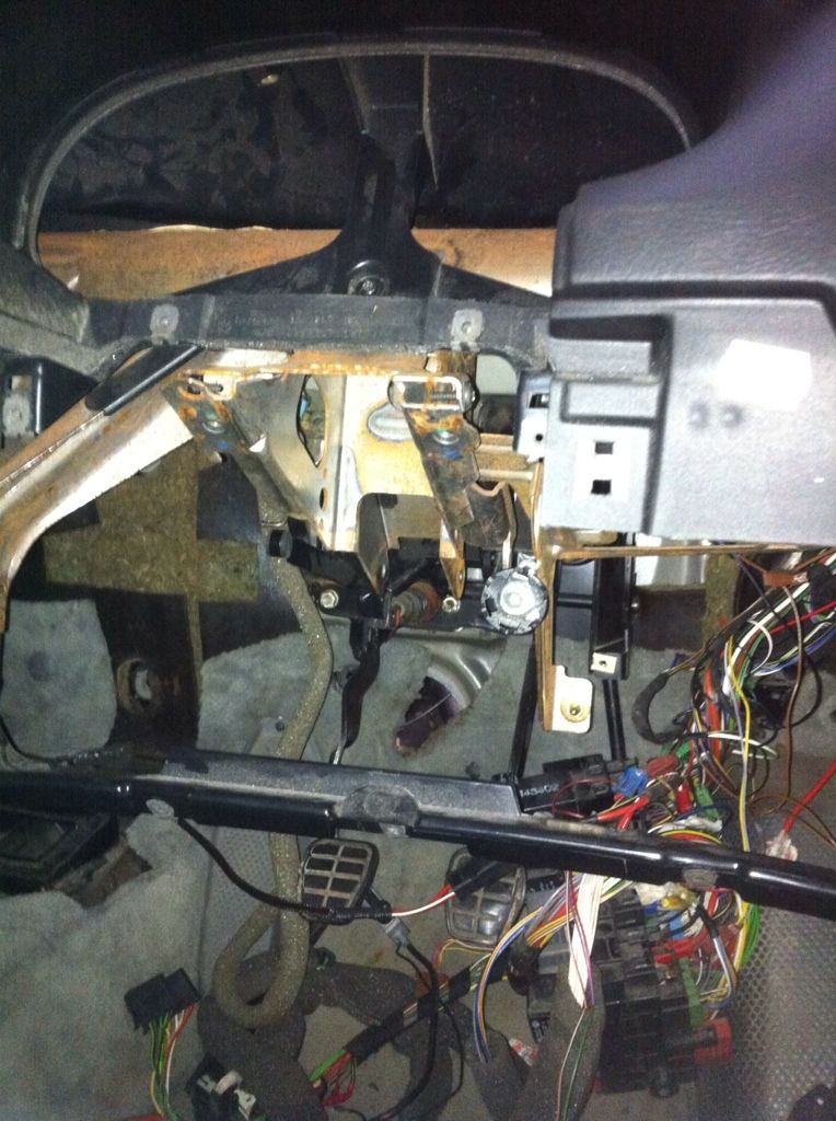

Didn't really get much done last night but here's a small update.

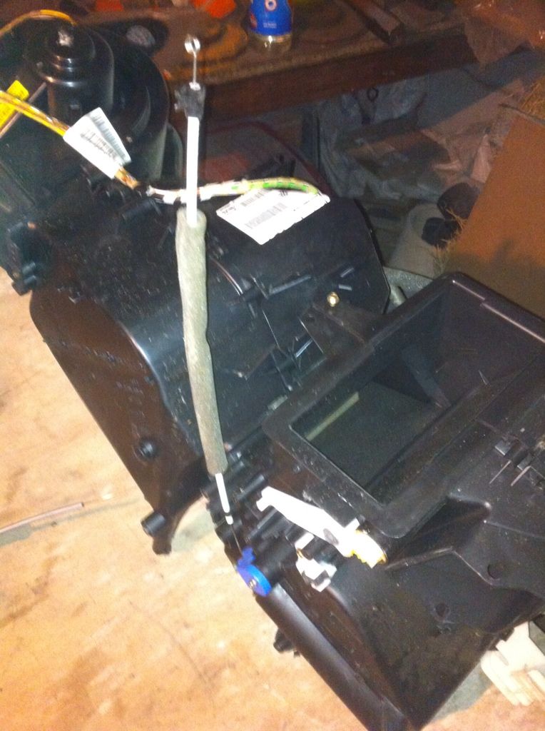

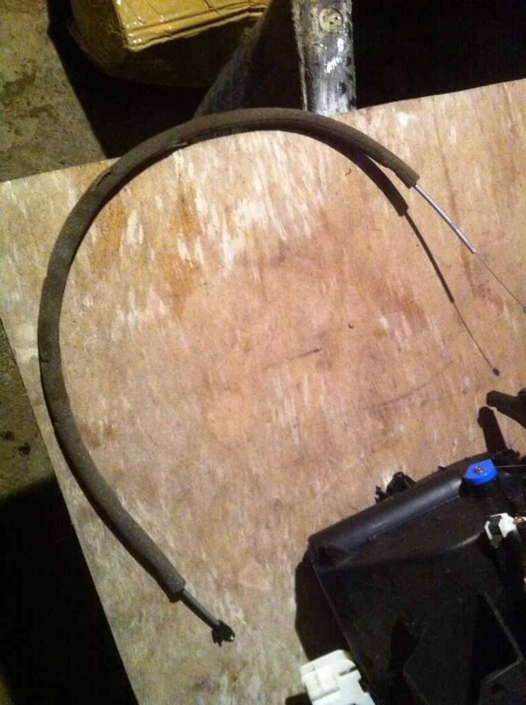

I swapped the cable for the temp control flap. This is the white one on the MK4 airbox that's too short for the swap. Now I could have used a corrado cable that was about 6-8 inches longer and it would have been a perfect length but unfortunately the cables aren't fixed the same as the MK4 ones to the controls. This is a major improvement of the mk4 controls over the mk3 ones. The MK4 cables have a permanently fixed fitting on the tubes of the cables at the heater control end. They're melted onto the tube. It's a simple T shape style fixing that slides and clips into the mk4 controls. So there's no metal clip snapped into place on the control end. We all know how brittle they can be on the MK3 controls and it means that the tube can be unfixed at one end and stops the flaps being operated properly.

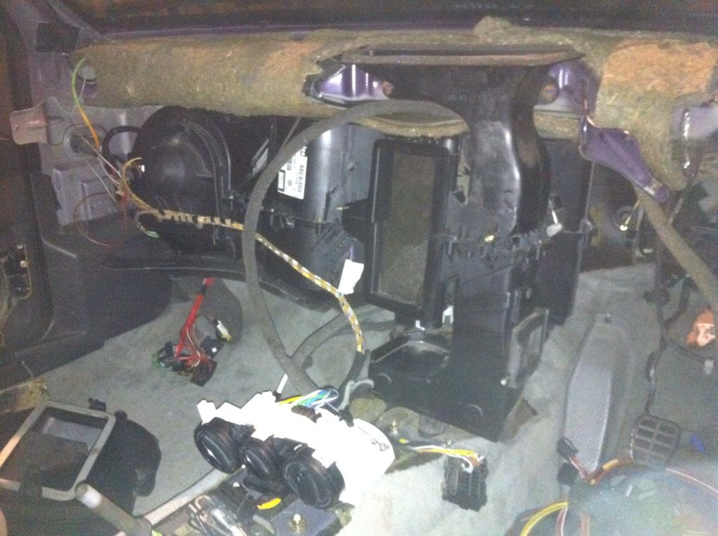

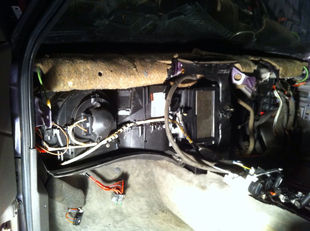

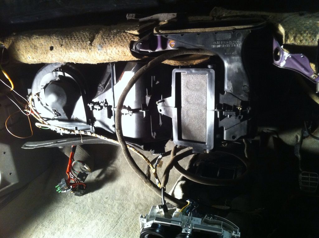

Here's how the entire box fits in place first as I noticed I hadn't posted pics of it yet.
And this is the spare MK4 airbox I nabbed the cable off. You can see the black clip-on fitting on the second pic at the end of the tube. I made sure it was long enough to make a bit of a loop out of. You'll see why a few pics down.
This is the cable fixed in place. Now you can see why the cable had to be long enough to loop. A shorter one with the clip on the end would have been better but this will work.
Here's the box in place with the loom and cables all connected.

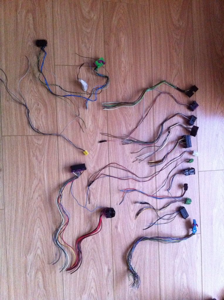

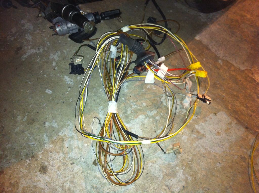

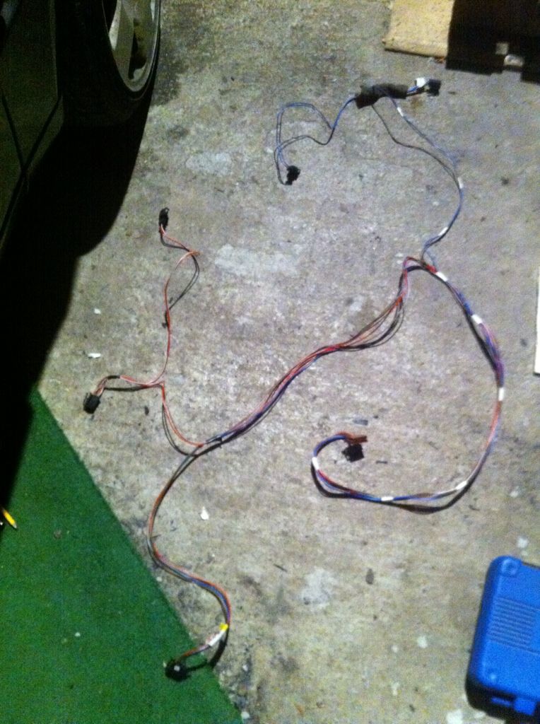

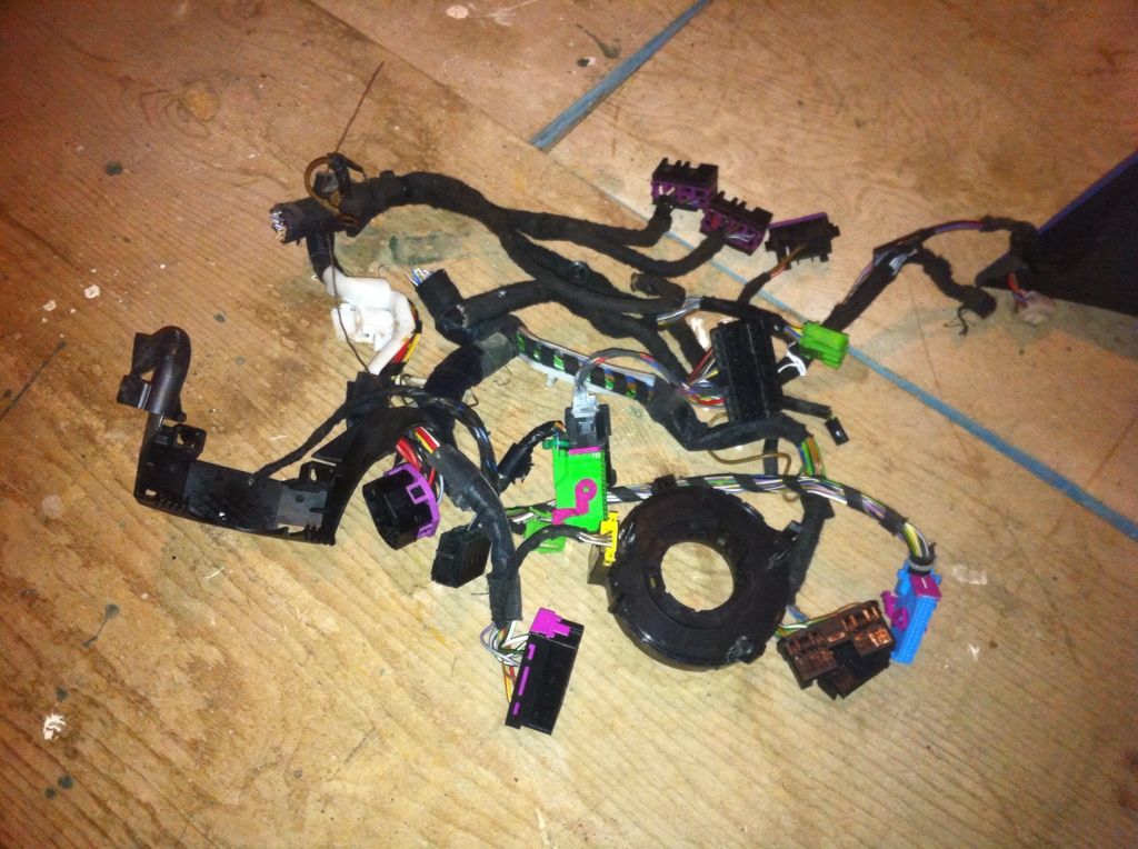

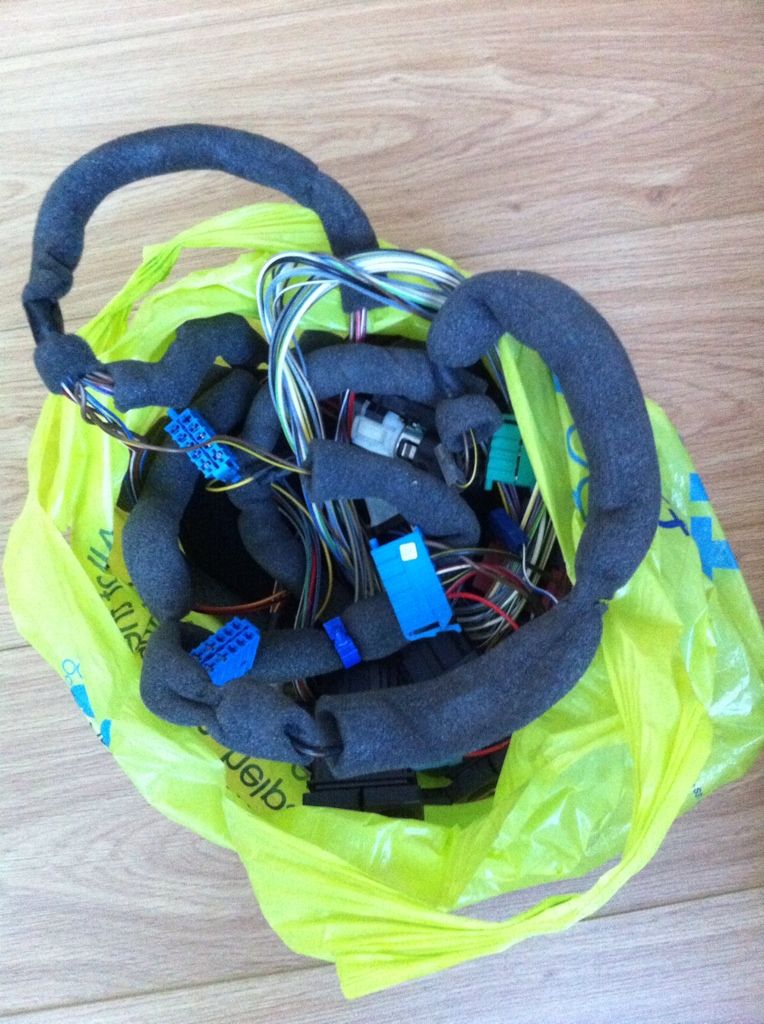

MK4 loom parts are all now stripped and cleaned. This is just to make it easier for me to work with them.

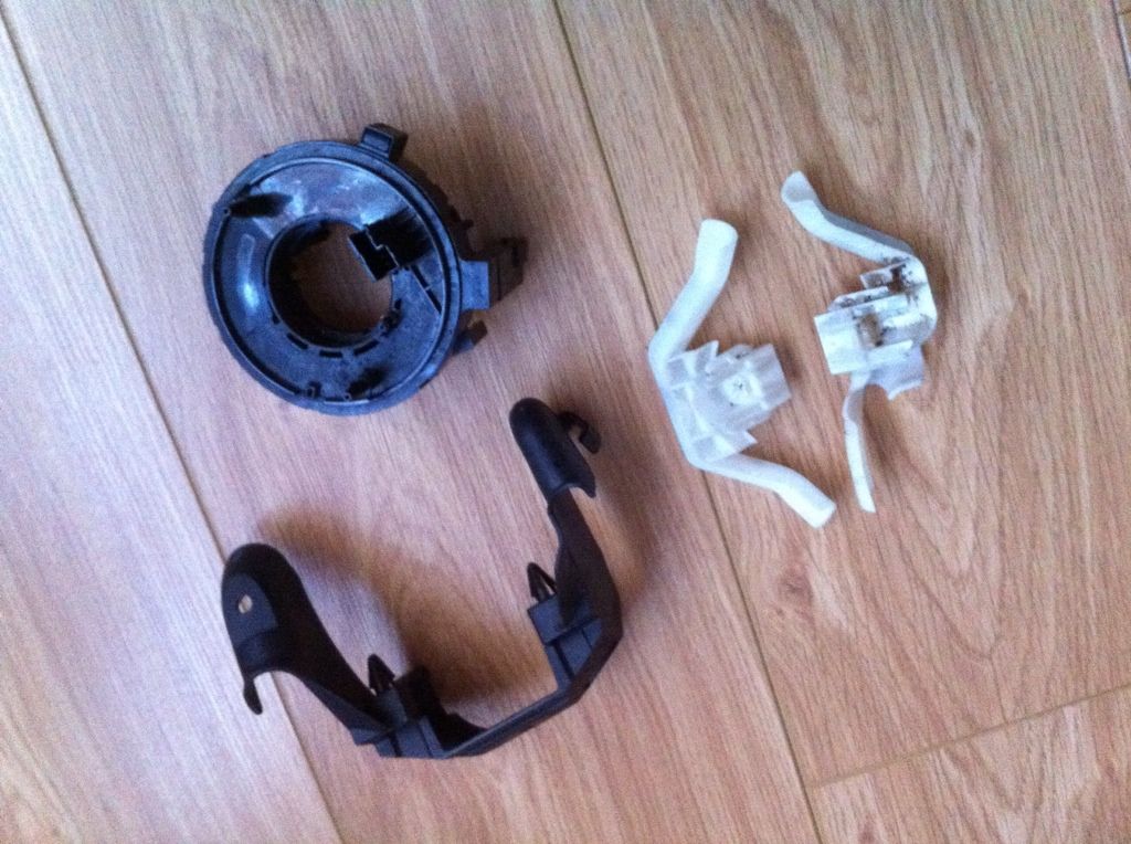

Here is a couple of partsv that will come in handy as well. The slip ring which contains the wiring connector for the horn and airbag. Obviously I'll only be using the horn wires. Also there are a set of 3 plastic brackets. The 2 white pieces screw onto either side of the part of the cross member where it comes up through the dash above the steering column and below the clock recess. The black piece sits across the top of the steering column in the same area and these are all used for wiring loom routing to keep it tidy and stop wires getting nipped by the steering column adjustment mechanism.

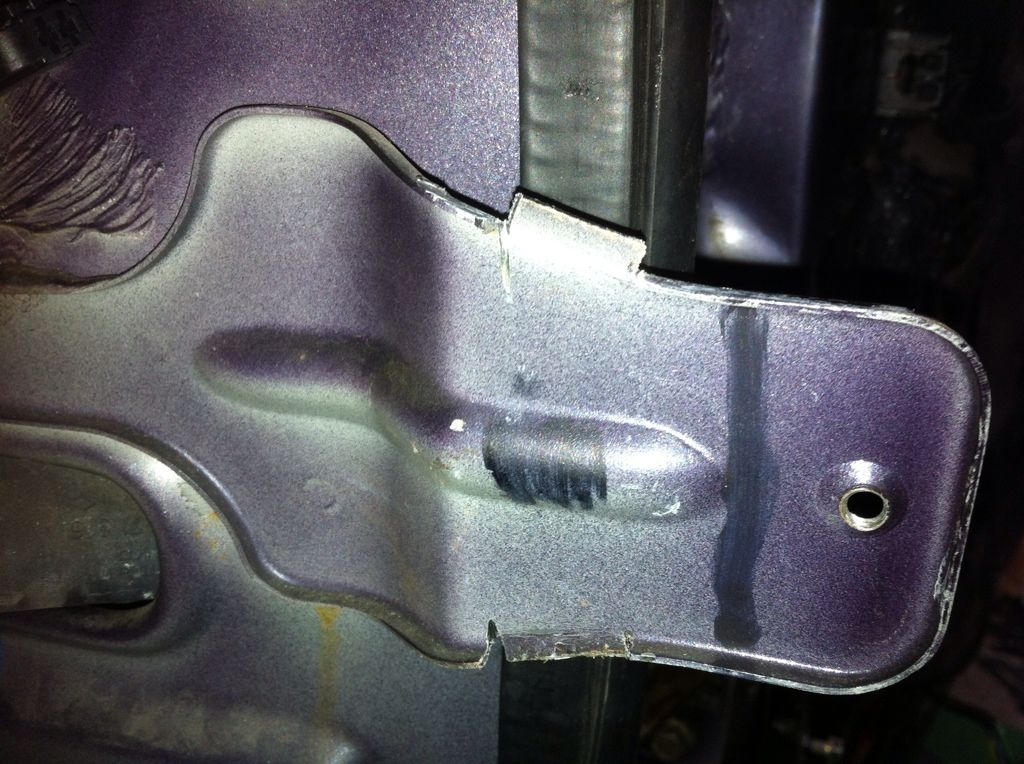

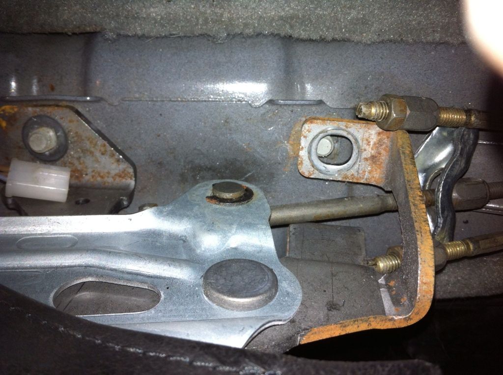

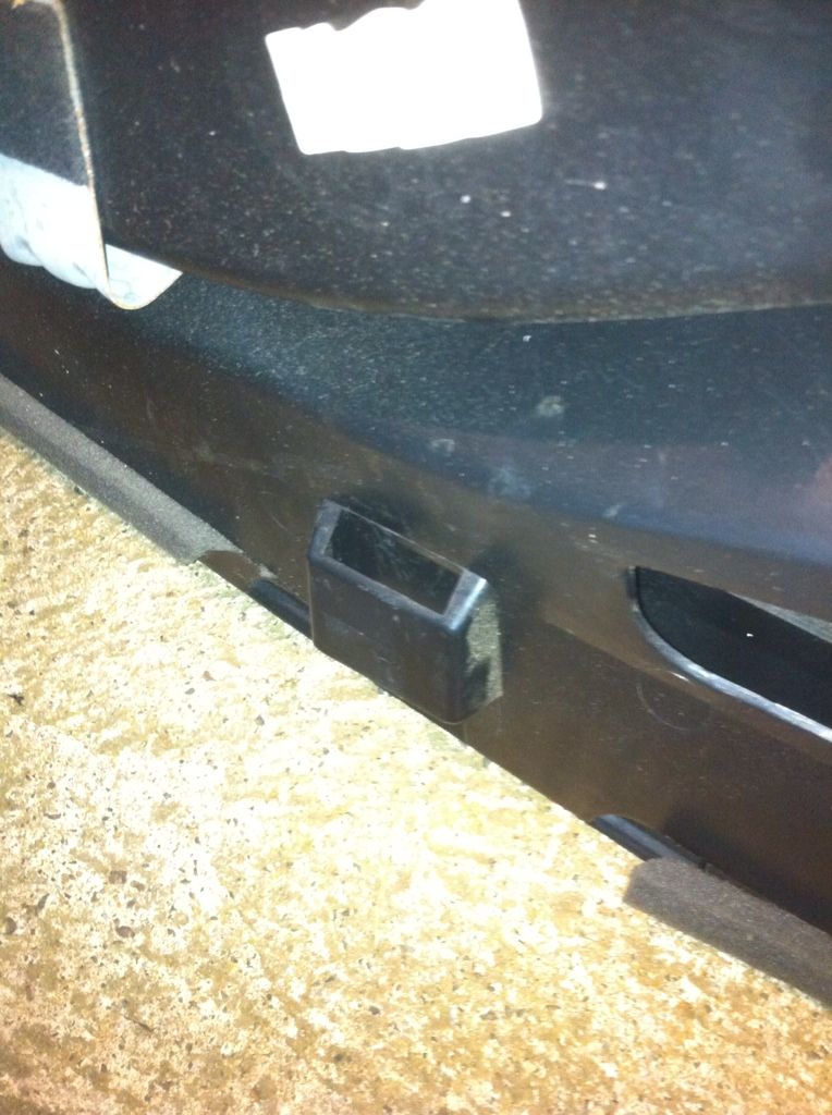

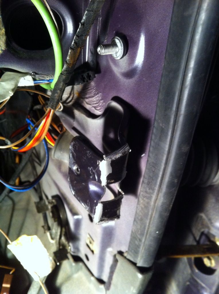

One more thing I wanted to point out was a pair of plastic humps on the underside of the MK4 dash. They clip into a pair of metal clips on the bulkhead of the MK4. I decided to keep them on the dash as they seem to do a good job of setting the dash at a good height to the glass on the corrado.
After refitting the dash crossmember to make sure everything was still lined up correctly and centered I test fitted and marked where the ends of the crossmember met the old brackets. I'll be honest, I haven't quite decided on the best way to fix the dash on properly yet but we'll worry about that soon enough. I just made a couple of crude marks on the brackets with a permanent pen.

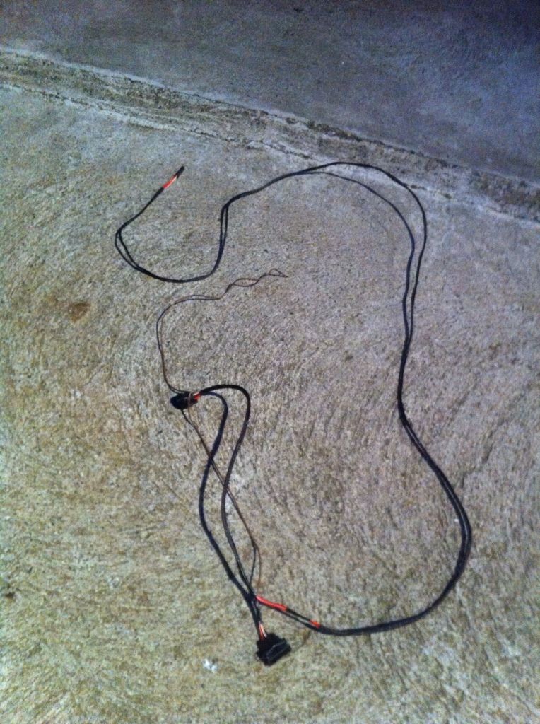

Then I moved onto the wiring work. I thought I might as well try and sort some of it out.
If you're going to work on VW wiring this kit below is essential. It's a Schwaben kit but as far as I'm aware Laser make the same or similar kit. Best £30 I've spent out of all my electronic gear. I can pop the pins out of CE1 (early vws) and CE2 onwards connectors with ease.
First thing I did was to remove the corrado airbox loom for the fan controls to the resistor pack. This isn't needed as we have the MK4 one already on the new airbox now.

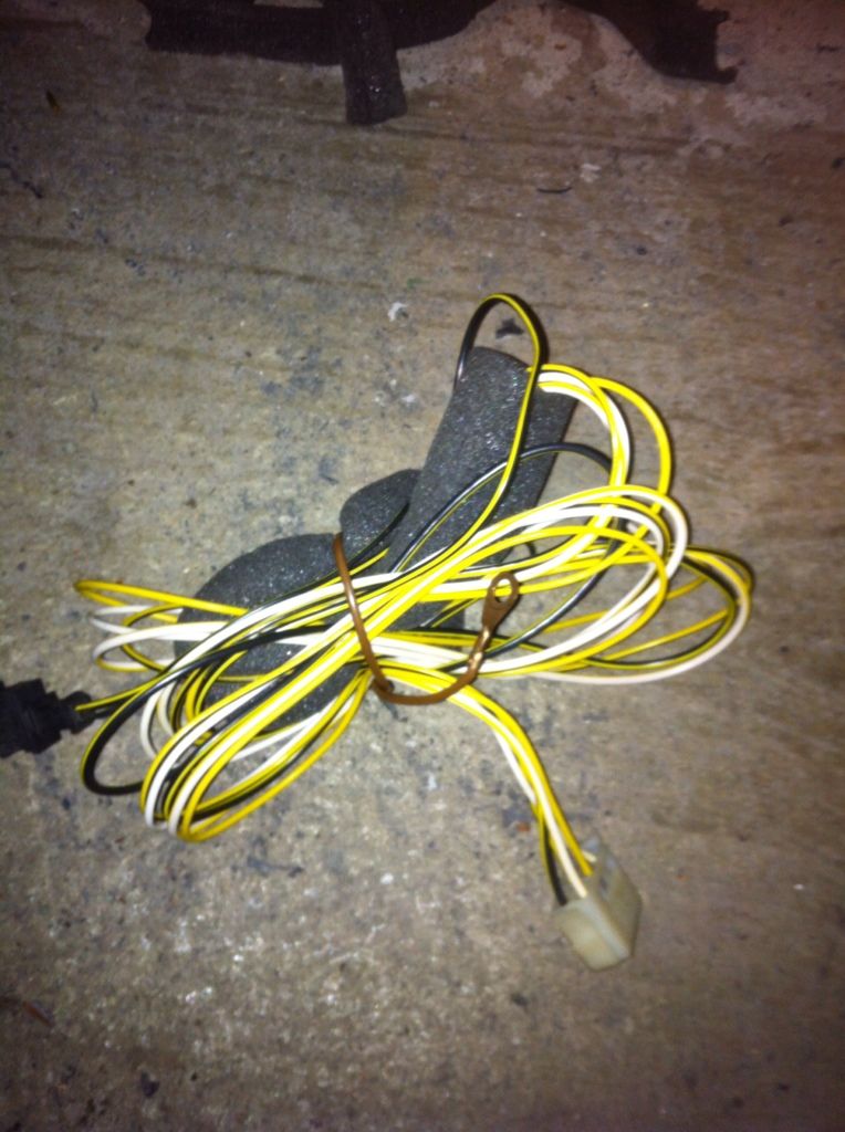

Then I moved onto the Speaker loom. I wanted to show this one as it's a basic example of a modification needed to suit the new dash. As you can see we have the speaker plug for the head unit, then wires running to the dash speakers on each side (blue is drivers side, red is passengers side), wires running from the dash speakers and to the connector for the door speakers on each side. There's also a connector there for the wires running to the rear speakers but we don't need to touch it. So what we want to do is adjust this loom to eliminate anything we don't need. As the MK4 dash doesn't have any speakers we need to basically cut off the connectors to and from the dash speakers and simply bridge the gap for the wires to go straight from the head unit to the door speakers.
The simplified loom. Easy as that. Now we just have a loom with a connector from the head unit (out of shot below) to the 2 door speaker connectors and the other one to the rear speaker connector (at the top of the pic) which runs down the passengers side.

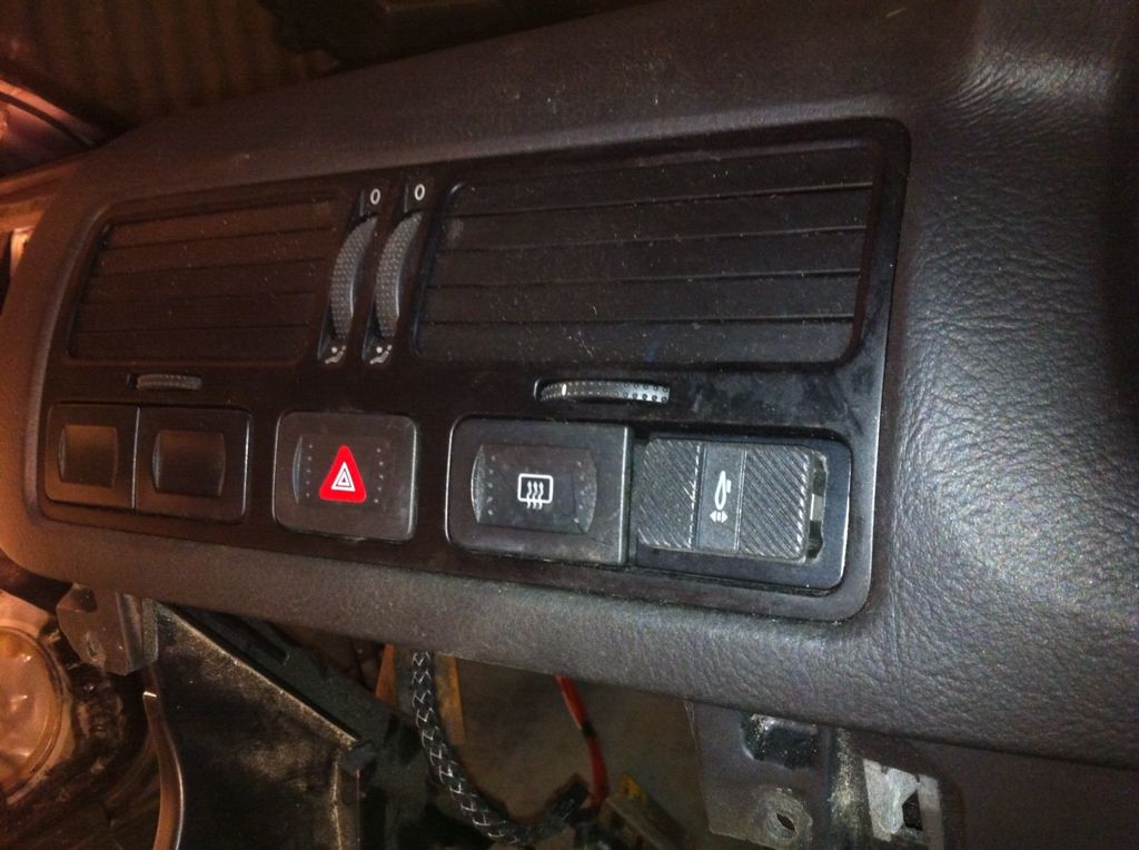

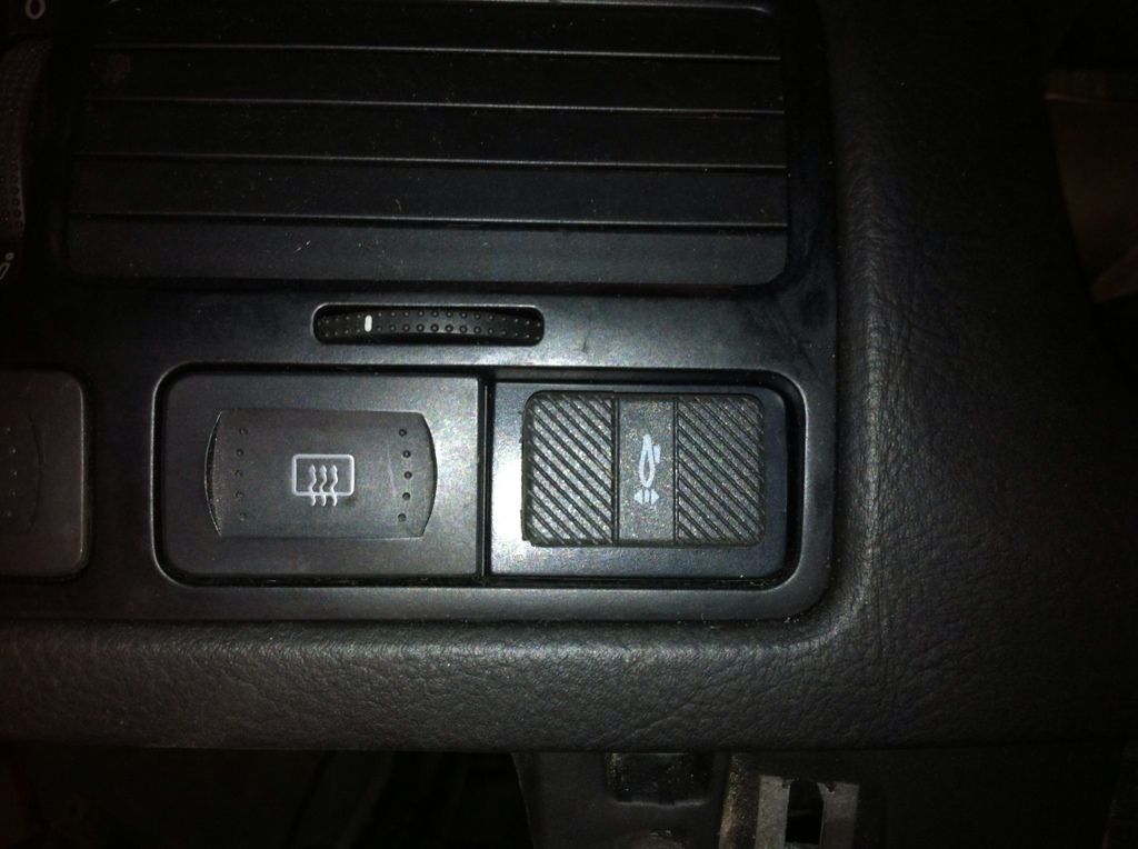

Hazard Light switch
Rear window heater switch

The other thing is the fuel cap popper. Obviously this isn't needed so I can always use the switch for something else. Might put the spoiler button on there.

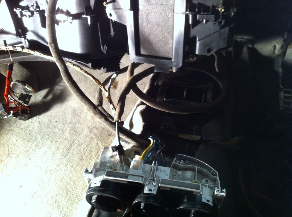

It'll be in and out a good few times before it's all done. The airbox can now be lifted out in about 2 minutes or less. lol.
All the stuff about the matrix is back a bit. At least it's easily sorted if it craps it's pants and I have about 4 or 5 of them from various different swaps and research.

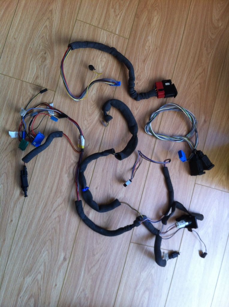

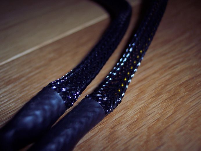

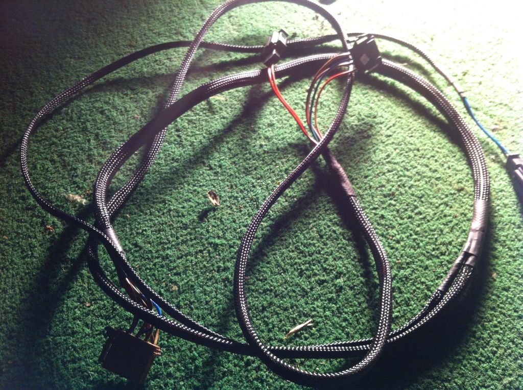

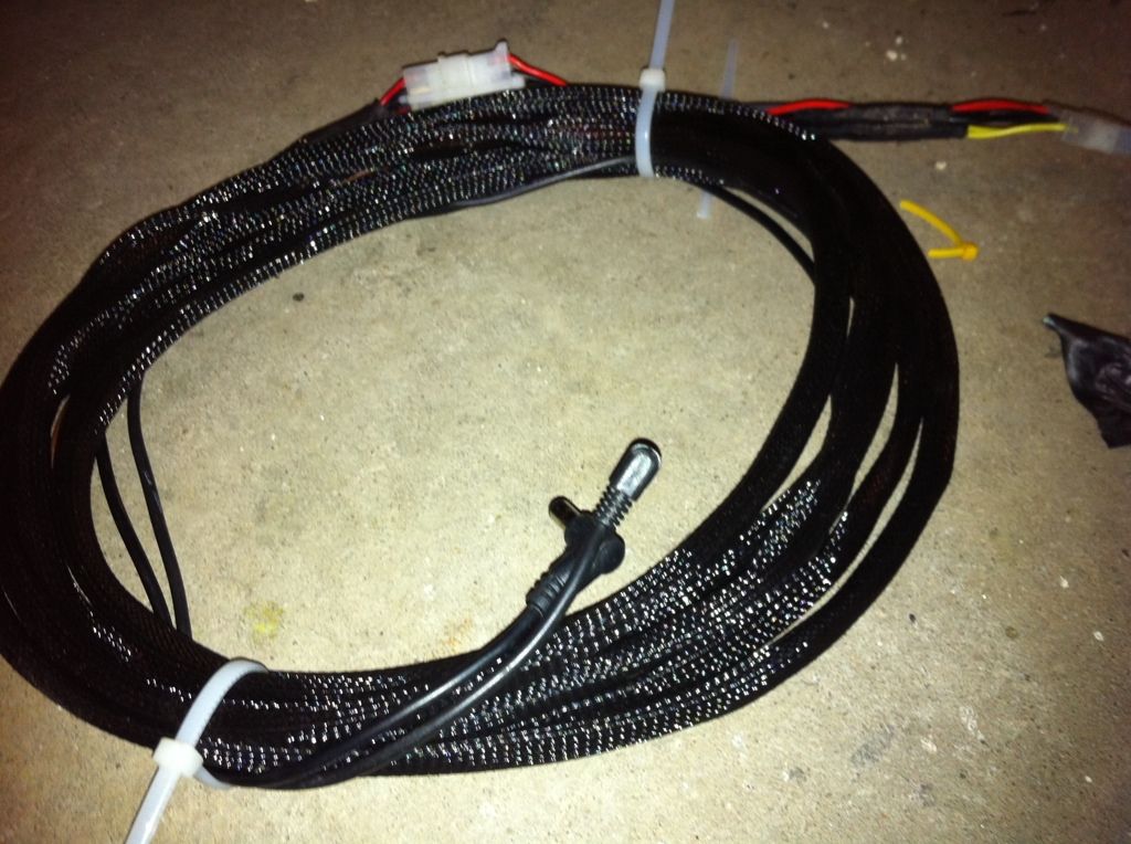

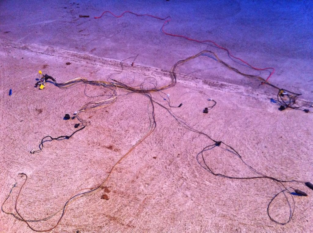

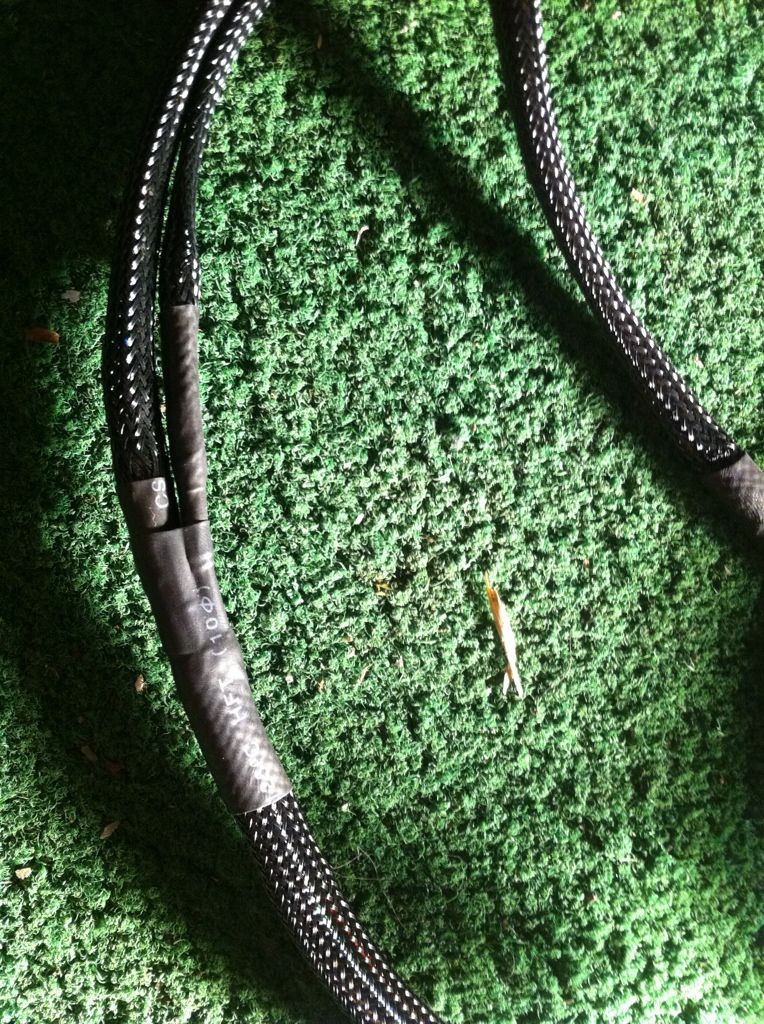

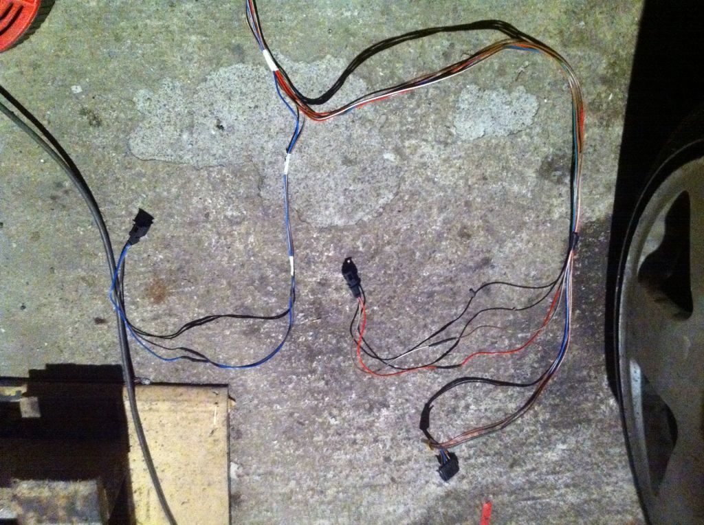

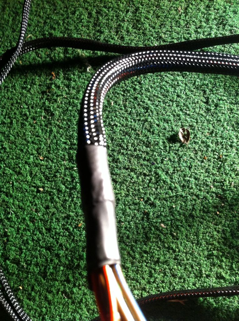

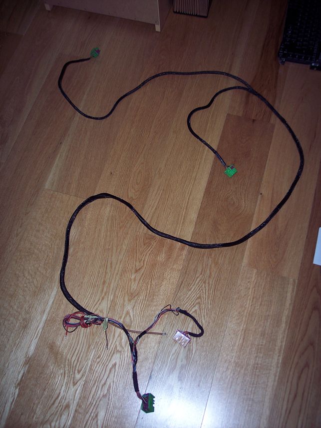

Got a little bit of braiding done tonight before running out of the sizes I need. it's a time consuming process.
Here's what I started with. It's the loom for the lighting, the horn, the washer bottle, coolant and brake bottle sensors, etc. They're not all seperated and ready for braiding.
Reduced to only the lighting section of the loom.
And this is the head unit speaker wiring finished.
I'll be back to get stuck into it properly this weekend again.
Wiring looms aren't actually too bad when you get them all seperated out.

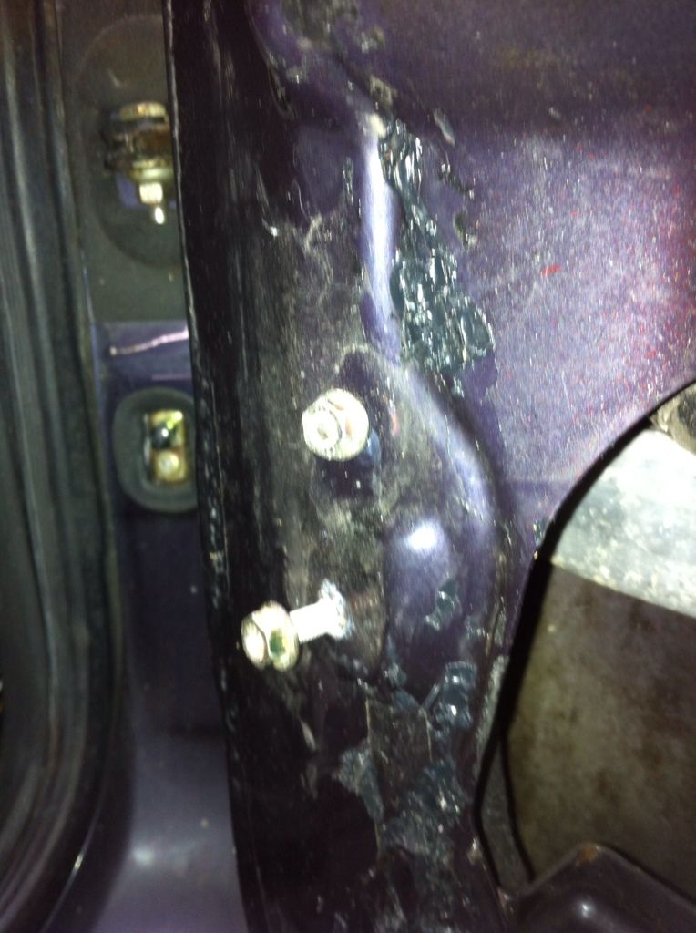

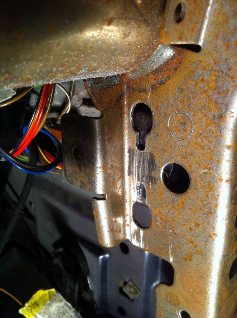

My first job was to sort out the 2 central mounting places. I had to make 1 small alteration to the top bar. As you can see below I've had to put another kink into it.
This means that it's about 3/4 of an inch too far away from the hole where the original dash was. Easily sorted with a couple of bits of plastic used as spacers. That's just bolted done with an M8 bolt, a couple of washers and an M8 locking nut.

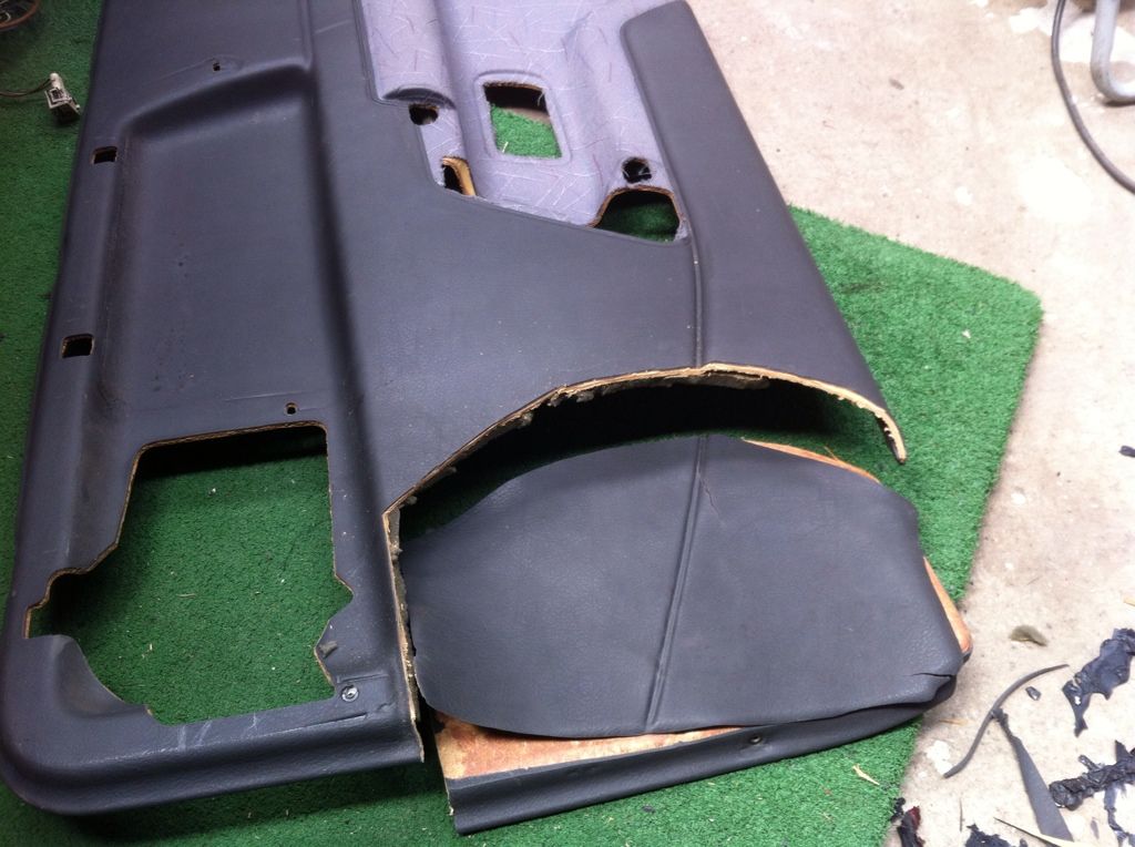

Next I cut the doorcards so they could be fitted to the doors with the dash in. I'm still undecided on how they'll be finished but I'll worry about that in due course. As you can see there isn't much room. This is why it's important to have everything centered properly.

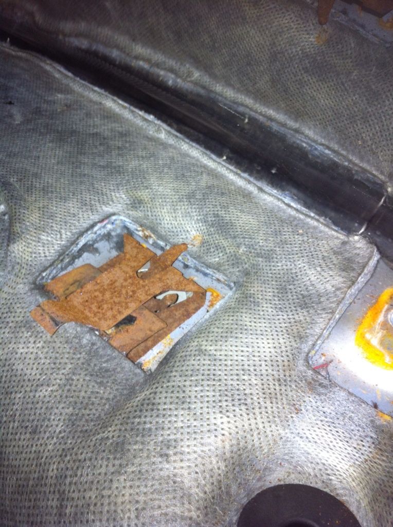

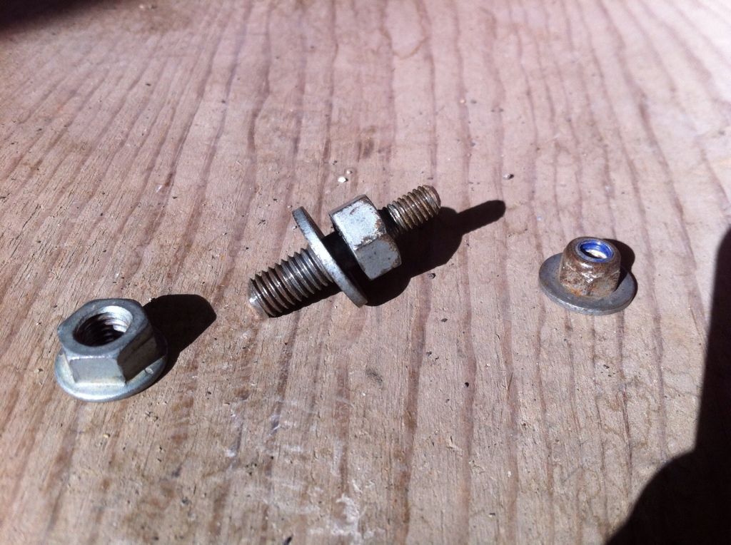

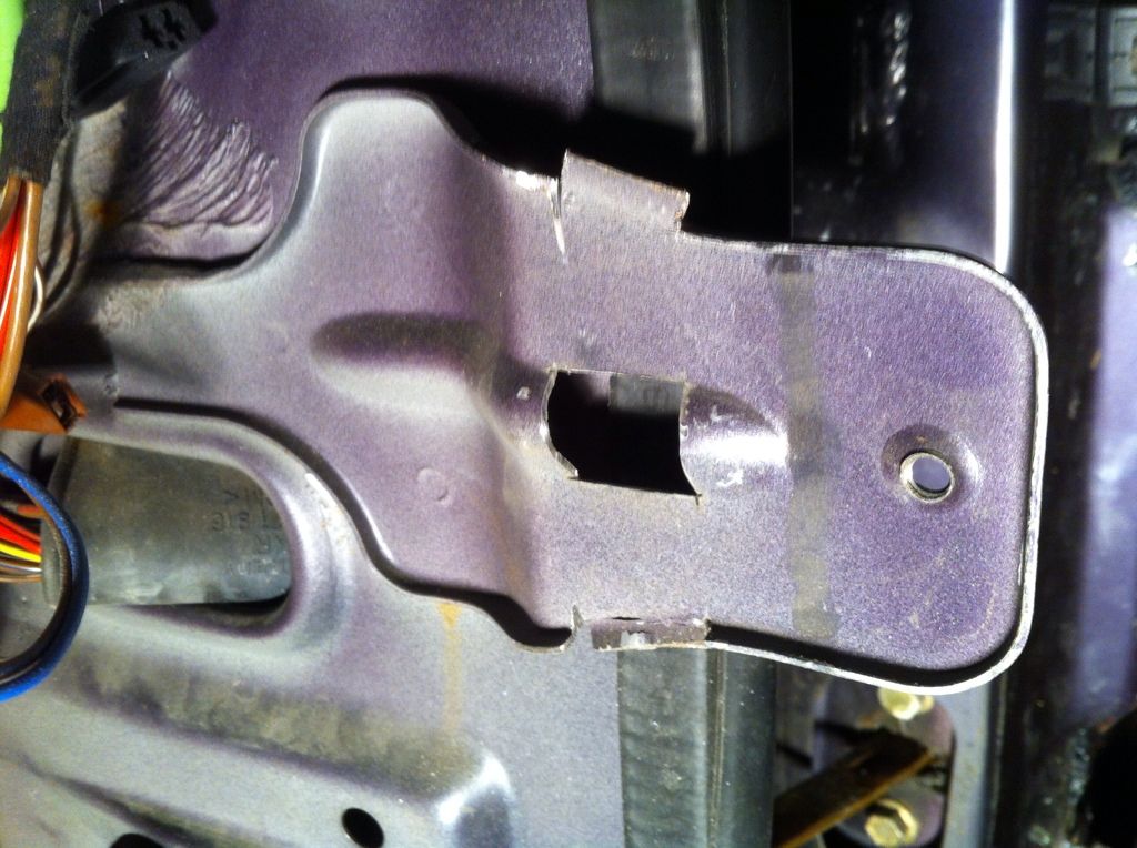

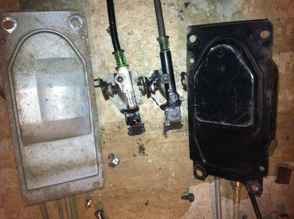

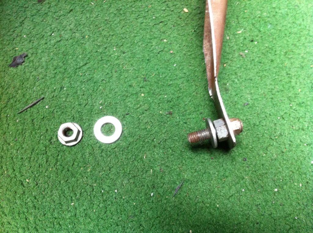

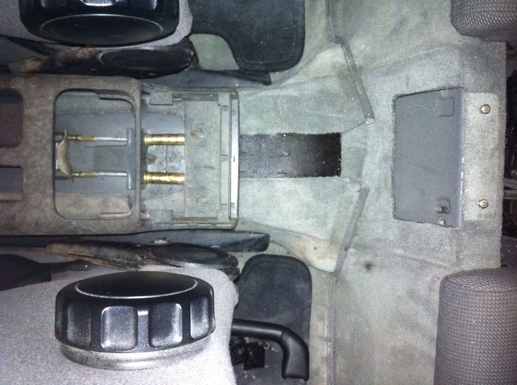

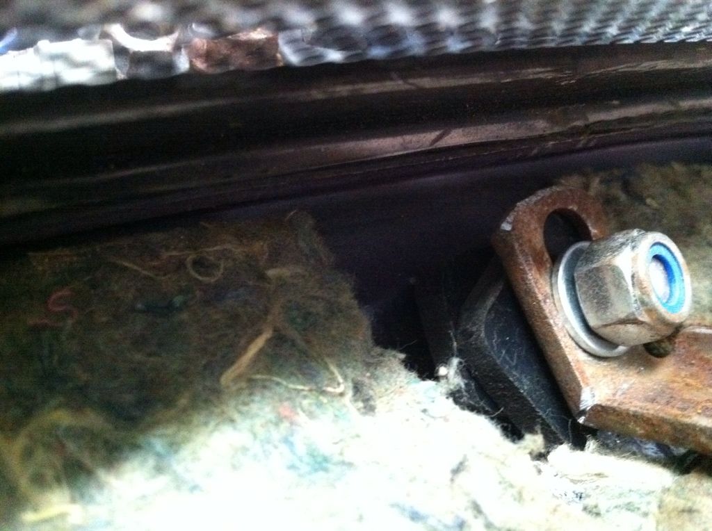

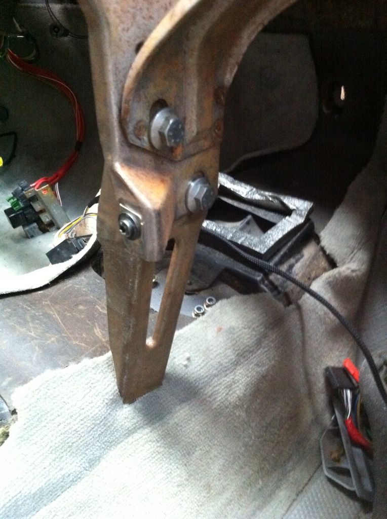

Next was to deal with the lower mount that attachs to the tunnel. I wanted to try and fit this with an easy option of removing it without having to drop the heatshielding under the car each time. Yes, you will have to take the front part down to fit the bolt or nut for this one.
I got a double sided threaded bolt here. I think it came off a gearbox or something, really can't remember. I shorted both ends to match what I needed as it only has to go through 1 sheet of metal on each side.
Hole drilled through the tunnel, bolted in and then the bracket fitted and the carpet with an 'L' slice to wrap it around.
Quick test fit before the proper head scratching started.

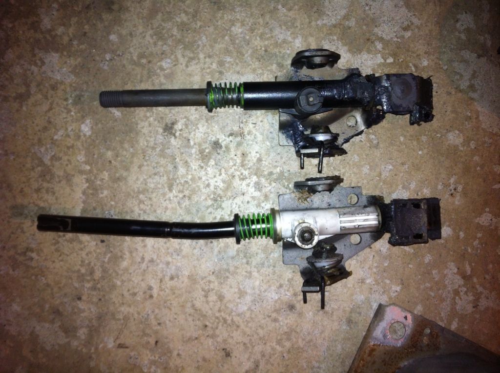

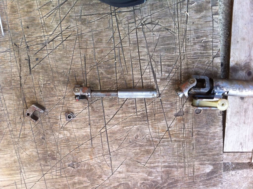

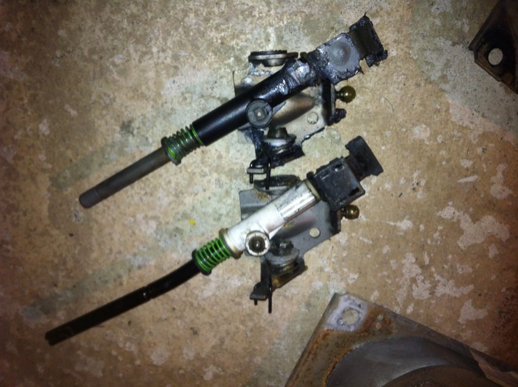

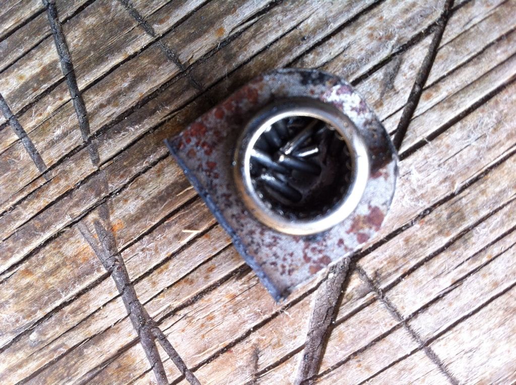

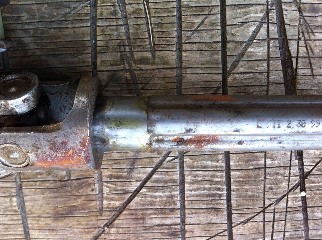

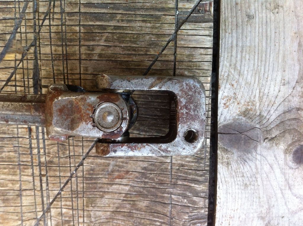

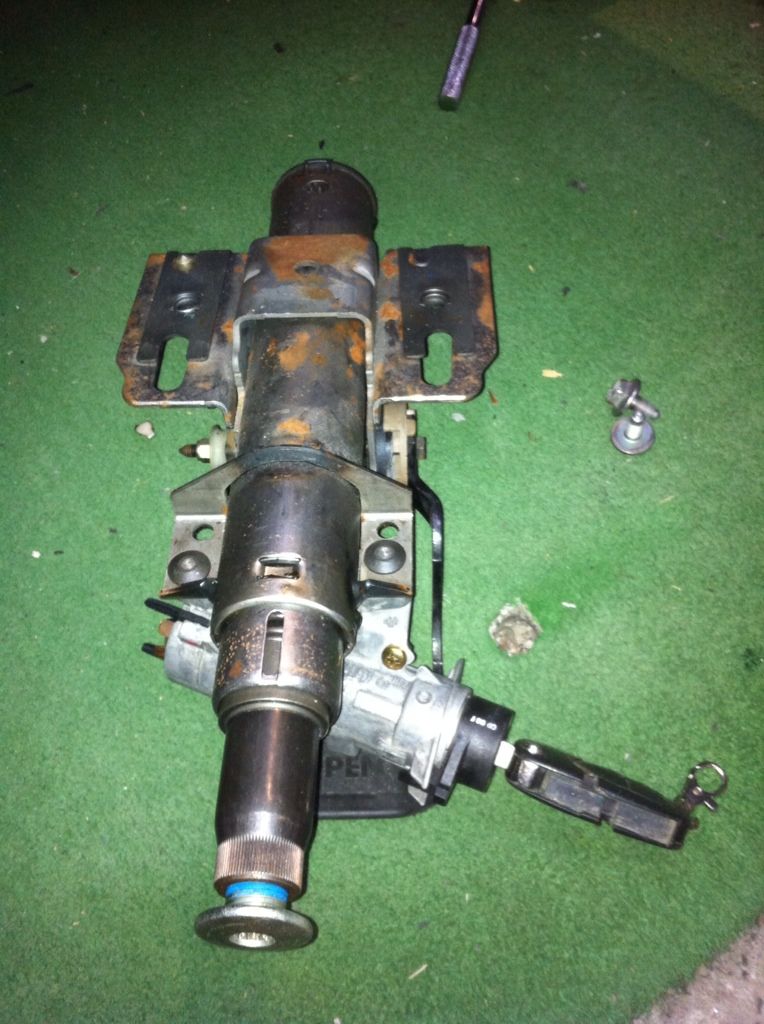

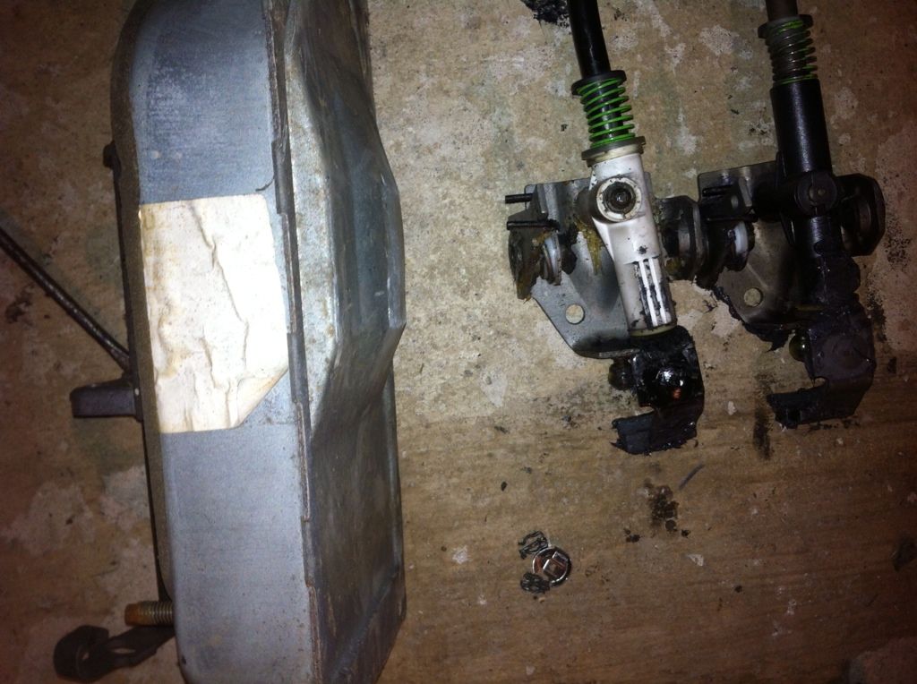

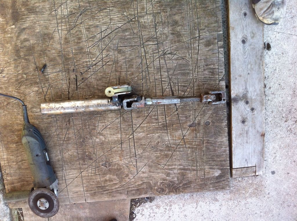

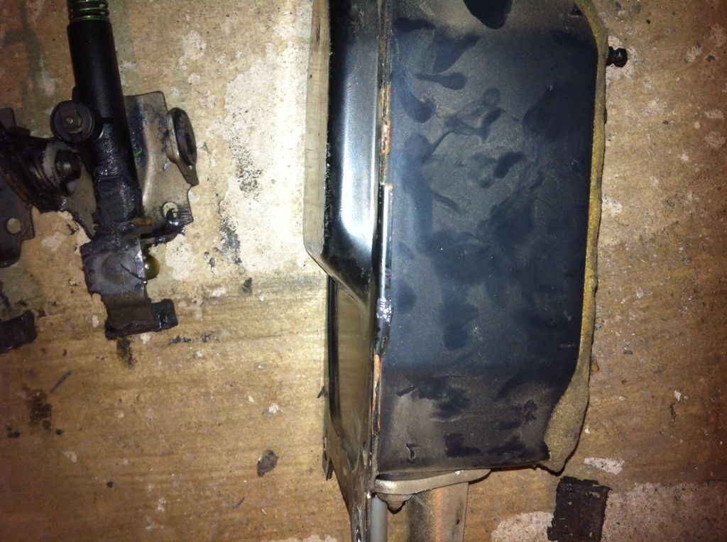

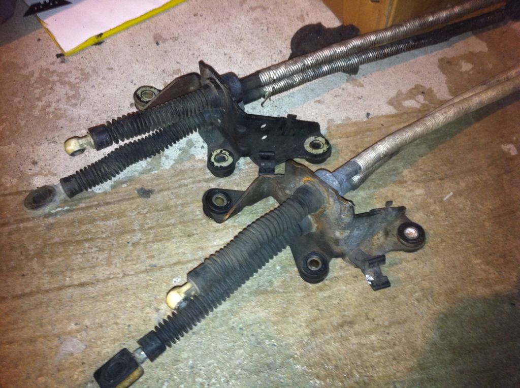

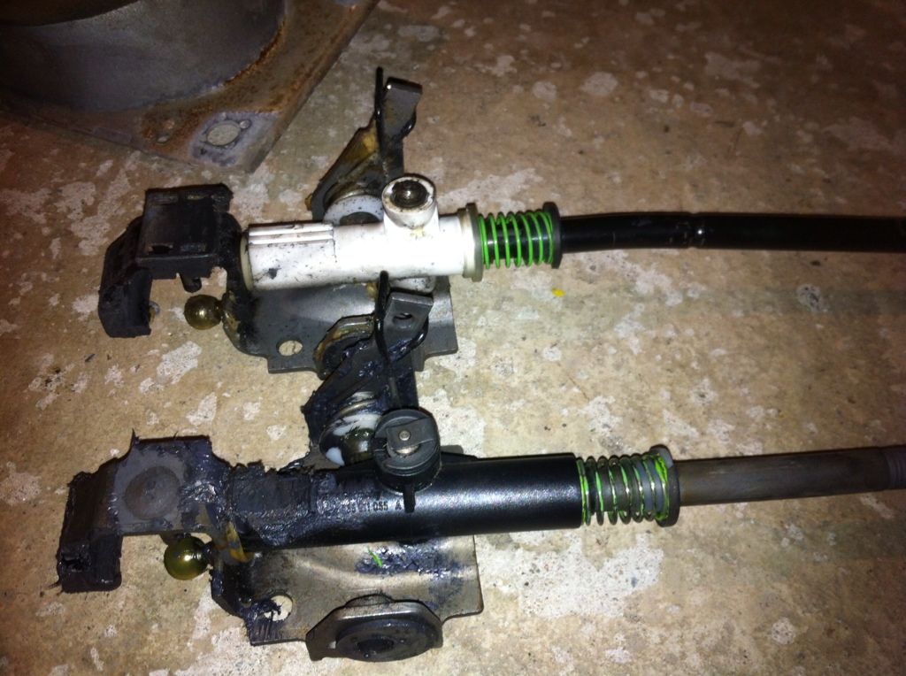

Then as I hadn't decided yet about the mounts for the sides, I went and done another part to keep me busy. I bought another lower mk4 steering column for £10 to experiment with.
I had to make the cuts where the column had to be extended.
This is the roller bearing on the inside of the U shaped bracket that attaches to the rack. Easy to put them back into place so don't worry if they fall out like this.
All done. This is ready to go to the engineer.

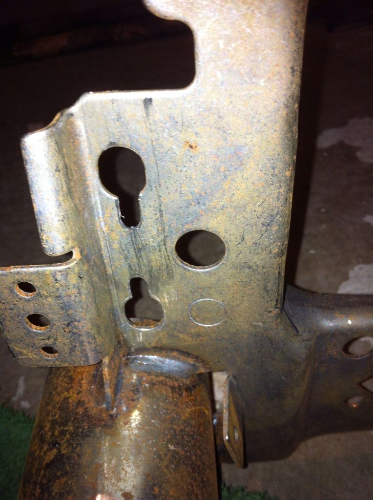

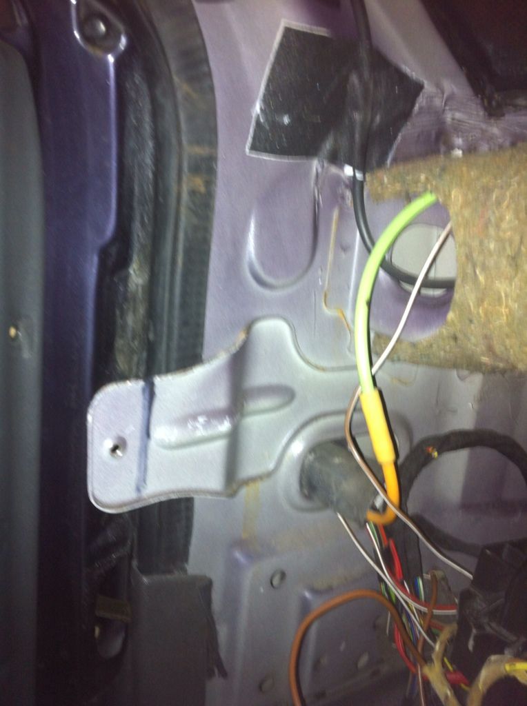

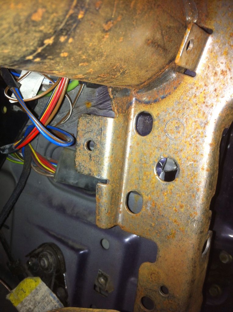

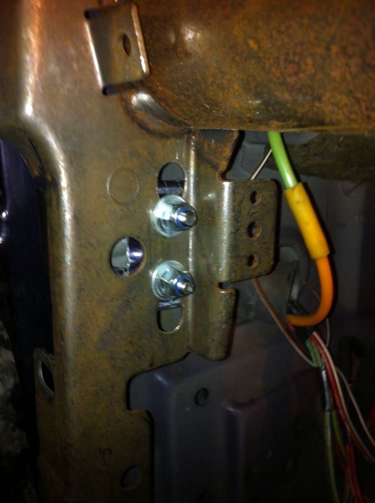

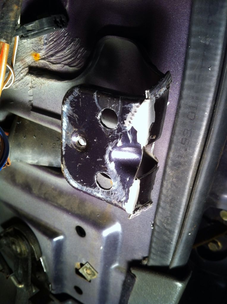

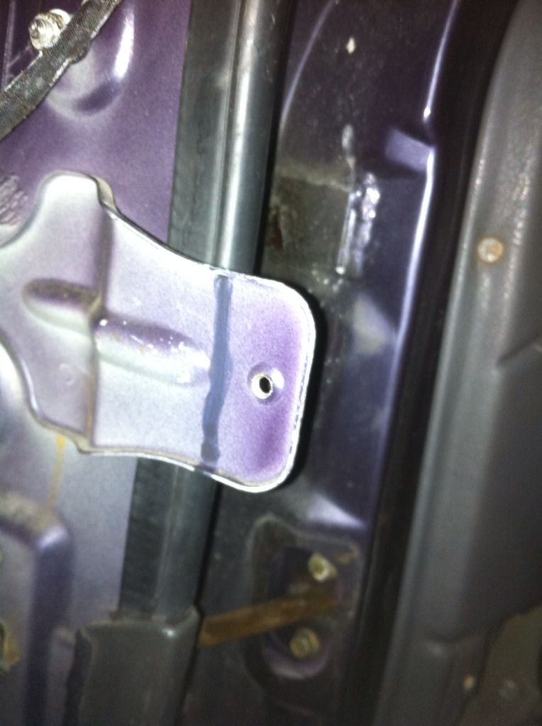

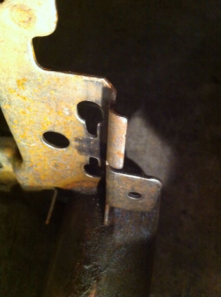

Then suddenly I had a wee flash of inspiration. I wanted to mount the dash side brackets causing as little fuss as possible and try to avoid any major cutting and welding. I'd been debating in my head about how I could use the existing brackets and I just worked out how it could be done.
A couple of crafty snips and I had a place on the brackets that could be bent. But I needed to mark and snip out that bubble in the middle so it could be bent flat where I wanted it. These were cut using a dremel.
Simple as that. This could be welded up to strengthen it but I don't think there's any real need.
The bent metal meets the crossmember perfectly. But we need to mark out where the holes are and extend the existing holes in the bar brackets so we can get bolts through the 2 bits of metal.
The holes were filed out using a round file.
Then a test fit to mark out the elongated holes on the brackets so I know where to drill. This was obviously done on both sides.
And then it was bolted up using 10mm M6 bolts, washers on both sides and lock nuts. All stainless steel fixings.
And that's the crossmember fully fitted. I'll post pics of how it looks with the dash on. Everything fits like it should. That's the main fitting out of the way. Lots more to do though.

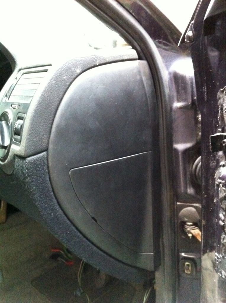

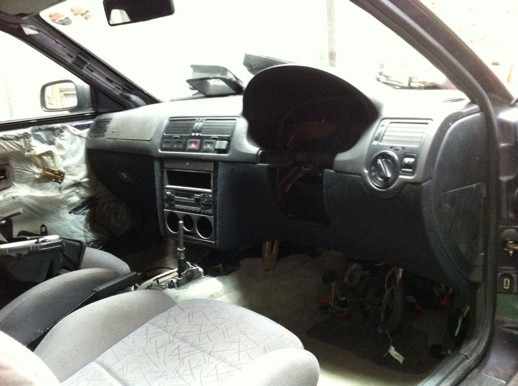

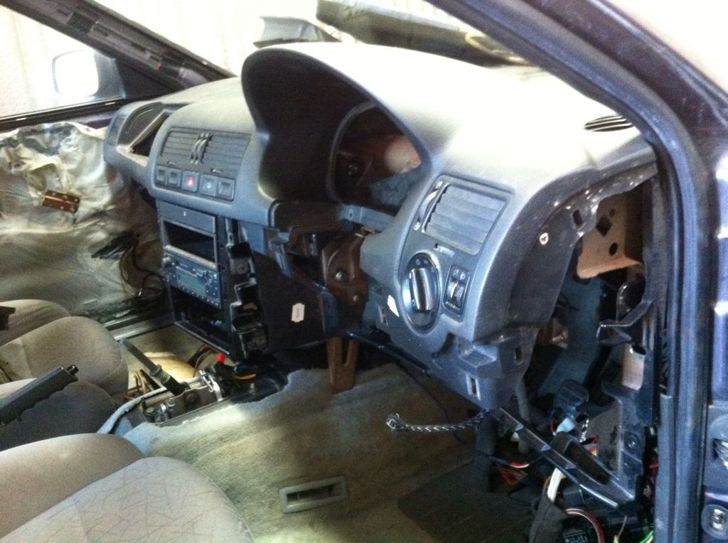

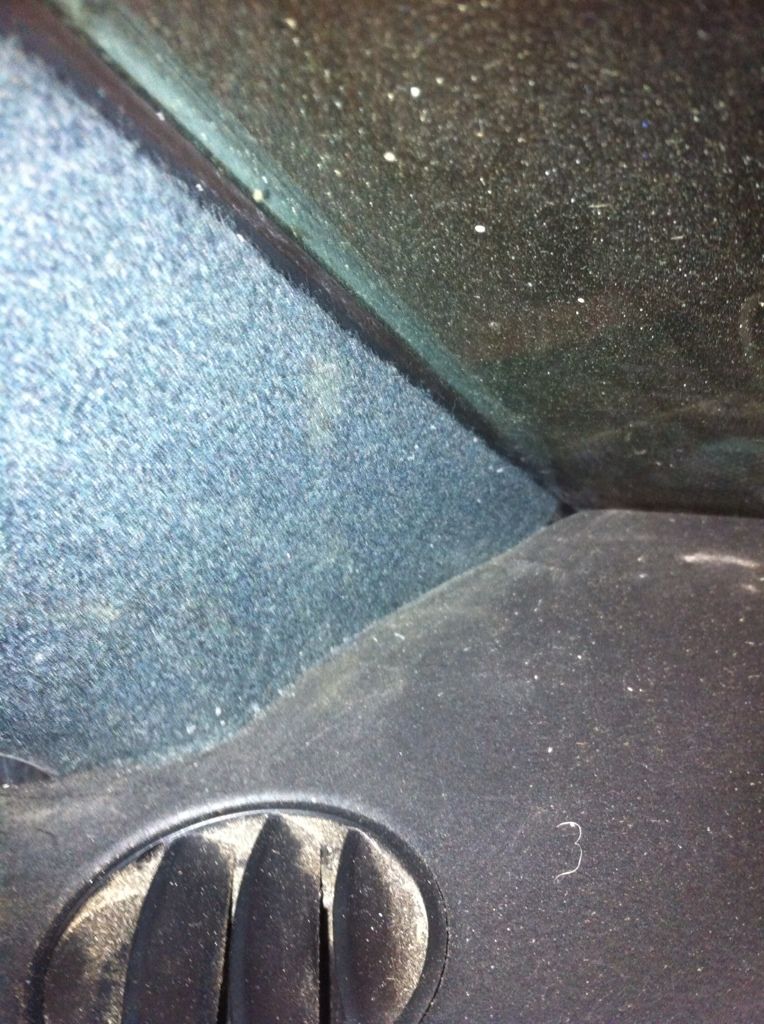

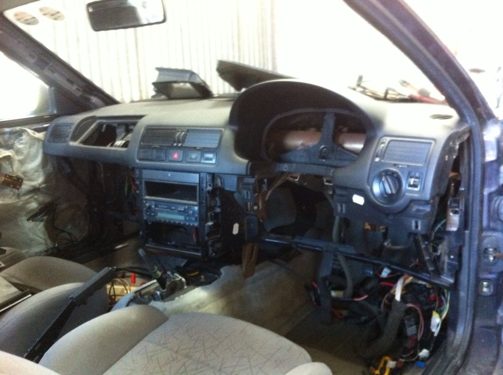

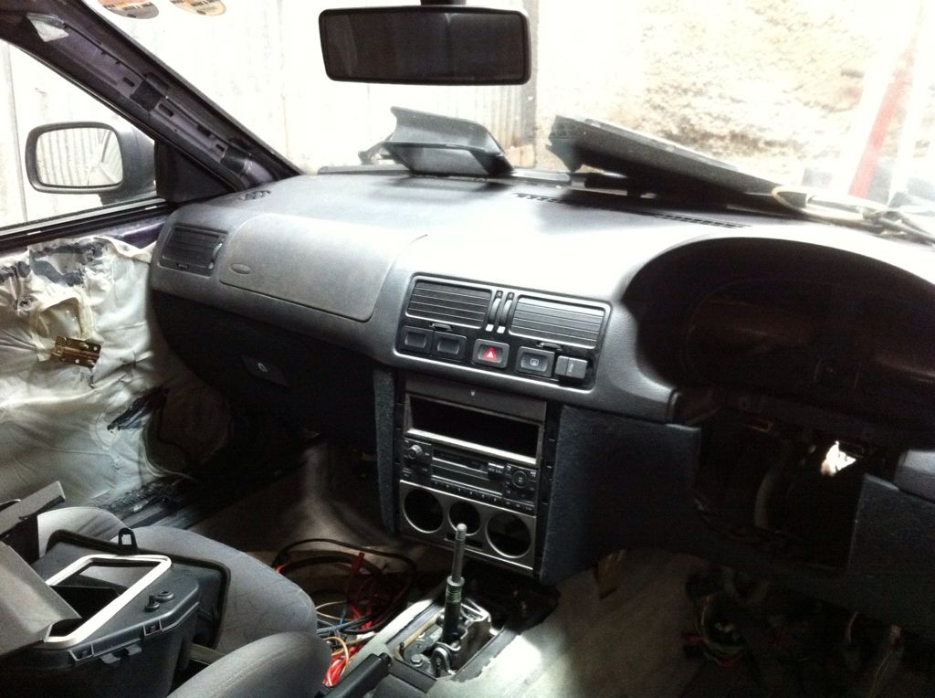

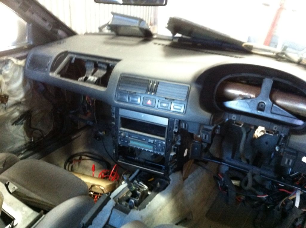

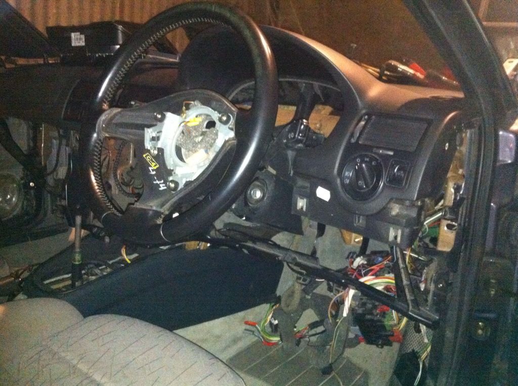

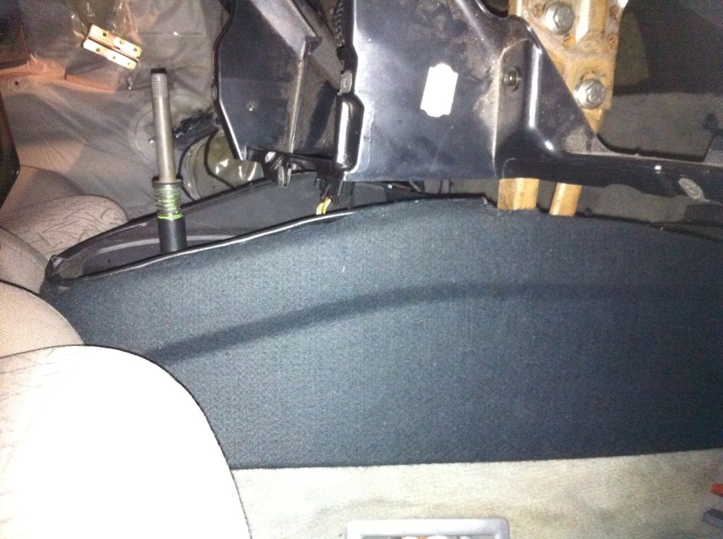

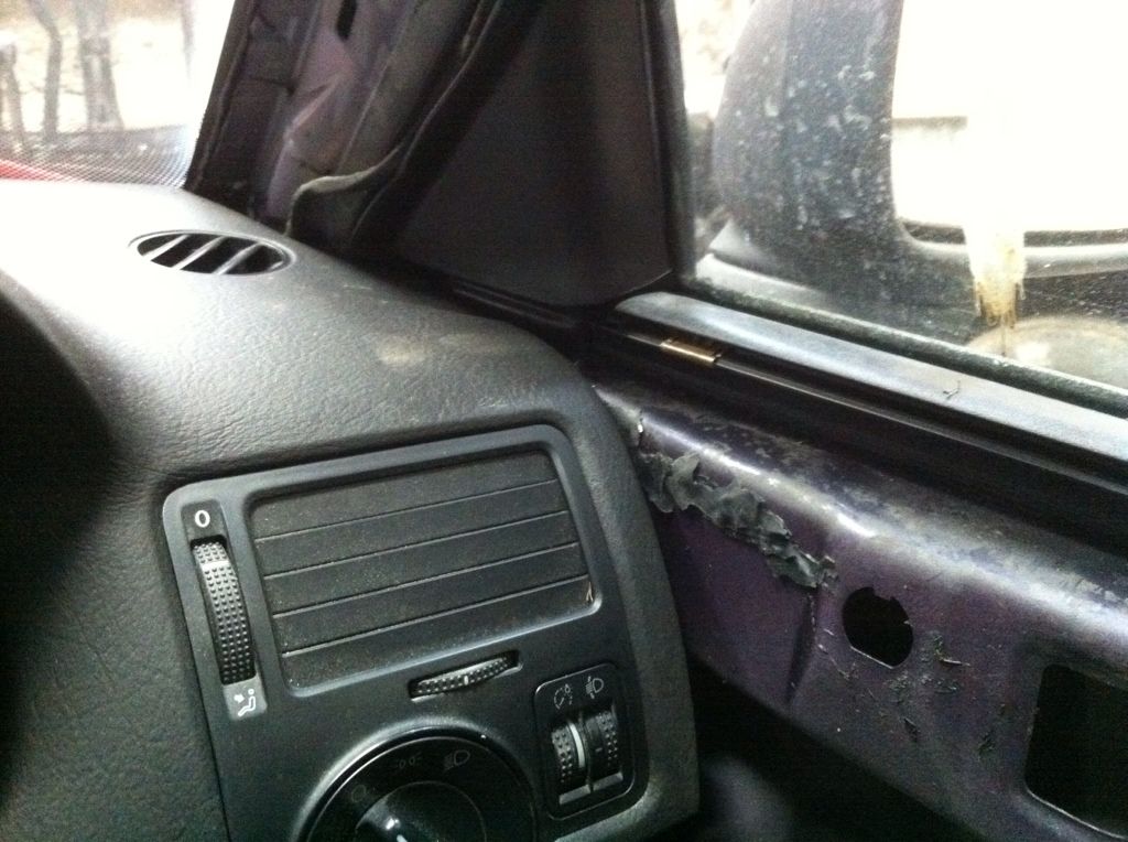

Did a little work this morning with fitting all the dash parts and working on the side panels. There's a threaded stud on the door which fouls the side panels and simply needs to be shortened a bit. The pic below shows the top threaded stud which has been shortened. It also shows all the silicone crap that some muppet has used to stick the plastic lining on with and made a right mess. That's a problem I need to solve and clean up and work out a tidy solution for it.
And this is the dash fitted with everything bolted on except the steering column stuff.

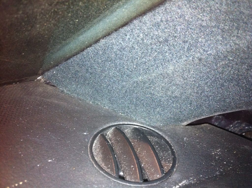

Trim the side panels in the dash to allow the doors to close without fouling them.

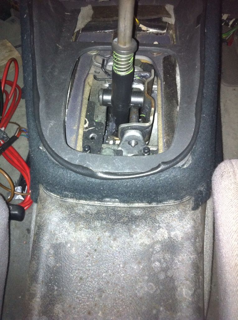

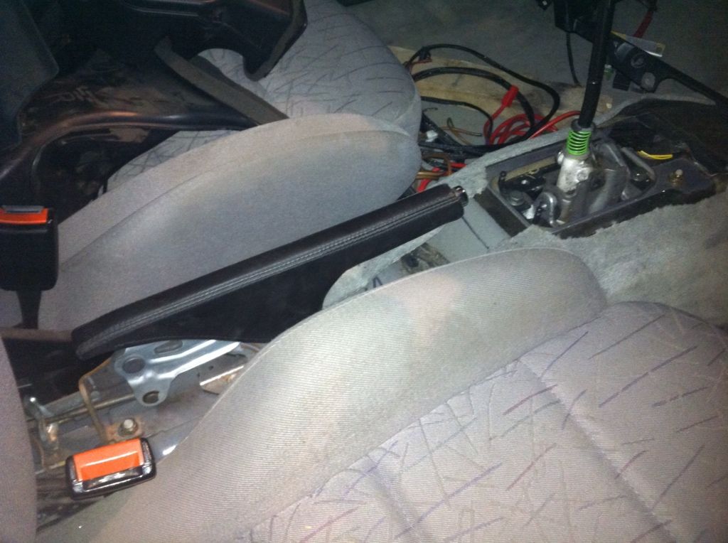

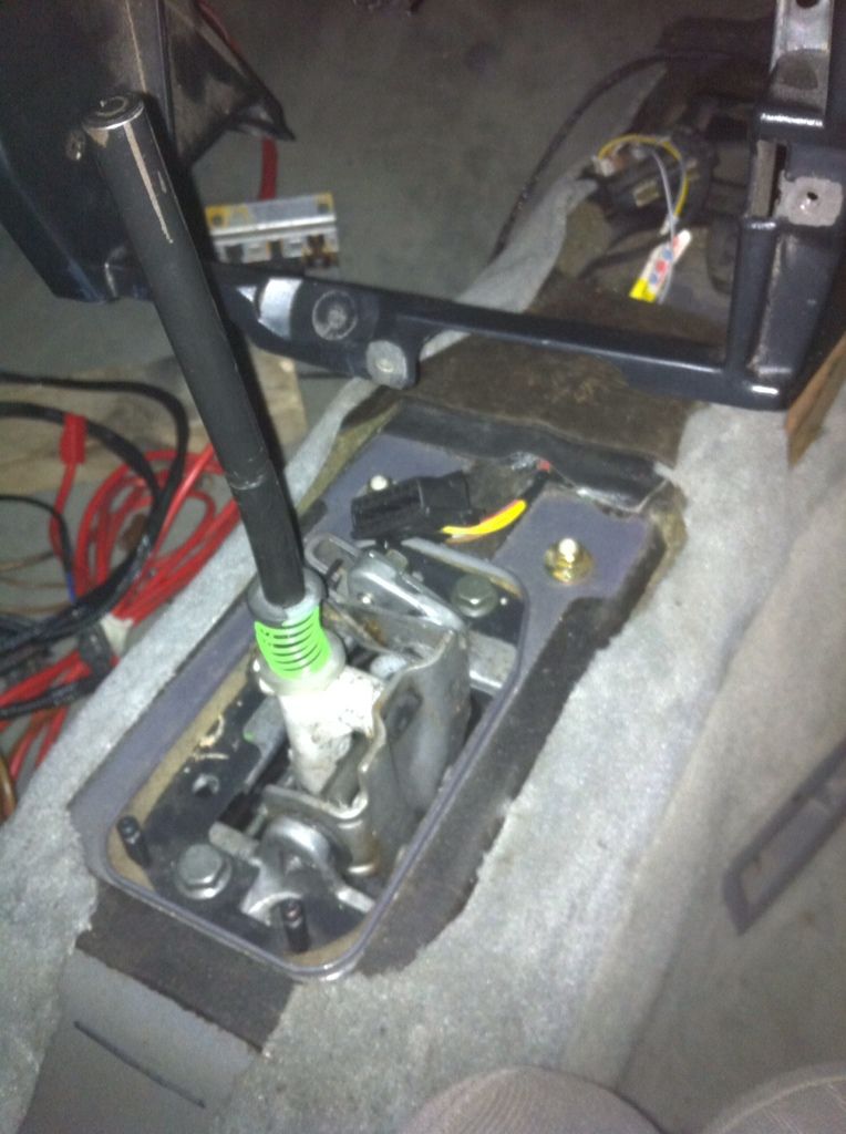

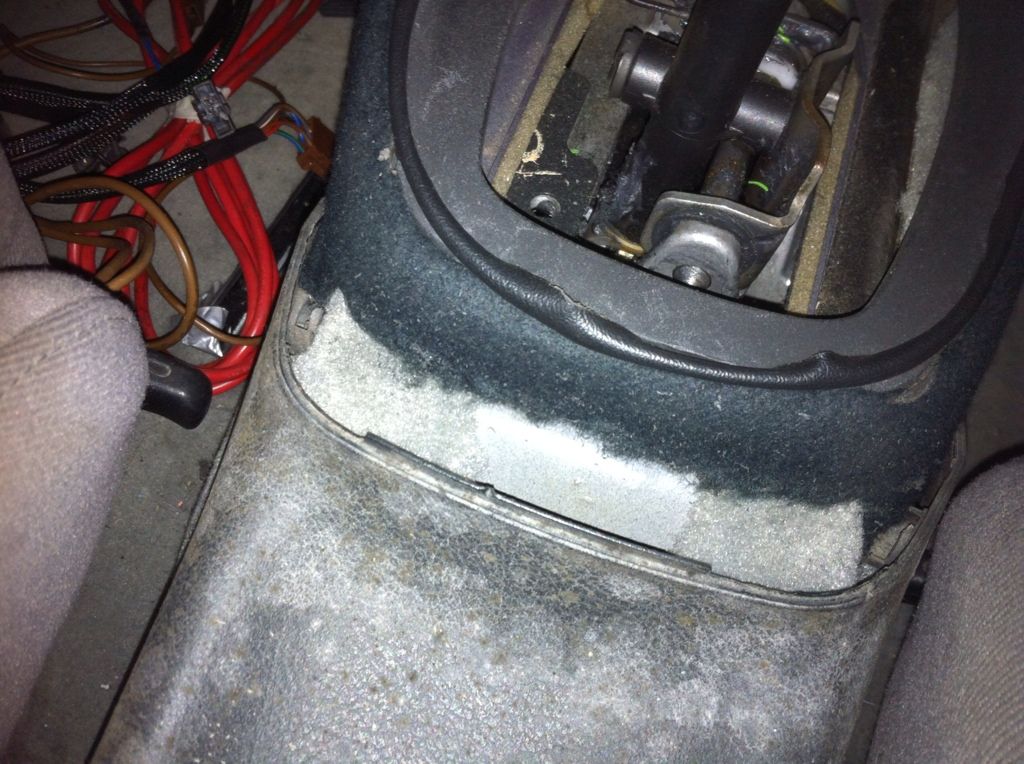

Test fit the center console for the shifter.
Mark center console position.
Drop out the shifter box and take to the engineer.

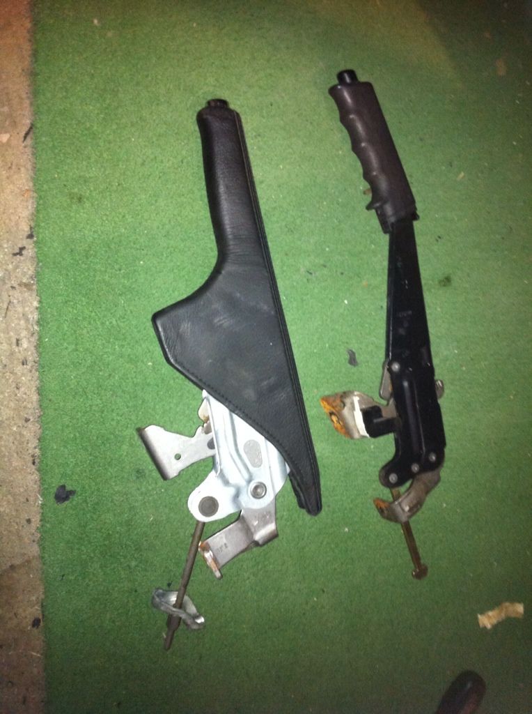

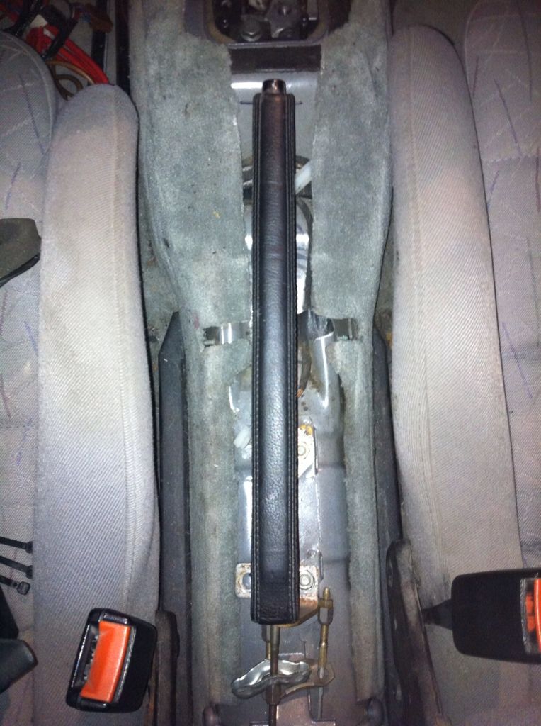

Test fit handbrake surround/rear center console.

After a little trimming I think I can position it pretty close to where I want it. I'll not be making any decisions or making any brackets for it until I get the modifications made to the gearstick. The cogs have been churning again and I've got a spare shifter box and cables from a MK4. I'll be having a look at these side by side later tonight.
The rear part needed a bit of a shove in but it's not too far away. Again, it's quite tight because of the tunnel size. (ignore the dirt/mould/grime).

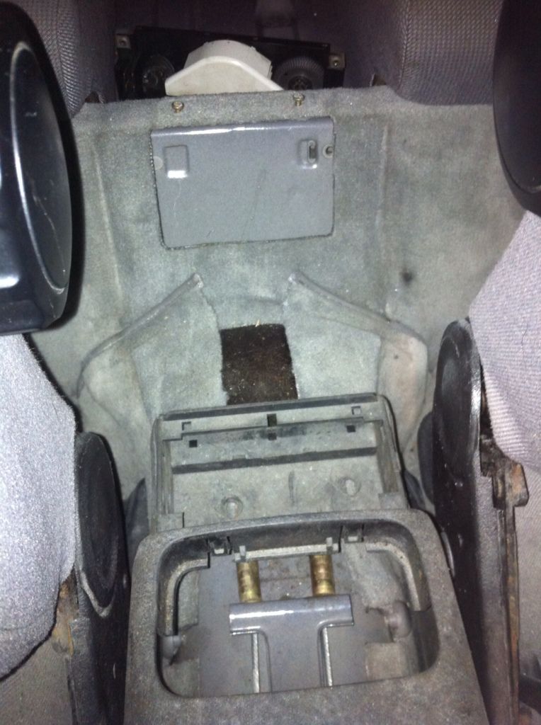

This is where the back of the rear center console reaches.
Another issue to resolve is the handbrake if I decide to go with the MK4 console (which I will). The MK4 handbrake is offset to the passenger's side. I happen to have a spare one of those too. The bolt holes very very nearyly mathc up. A little ream with a file and it should sit it there pretty well.

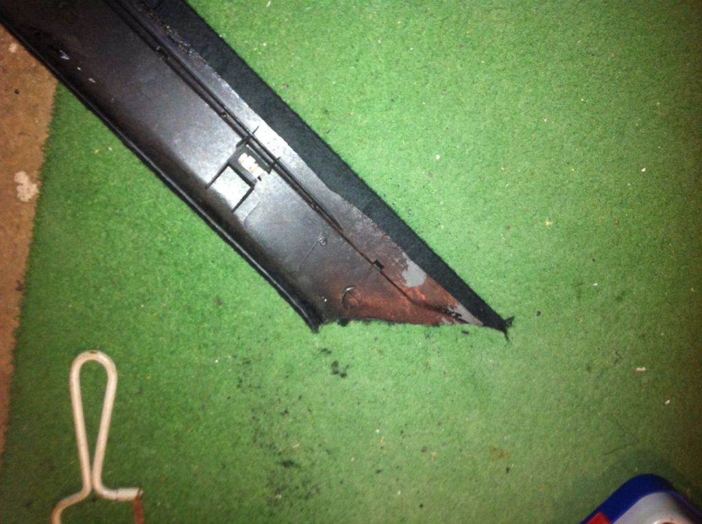

I played about with the A pillars. They just needed a little trim off the bottom and they go in pretty well. I'll tidy them up when it comes to the final fit.
I test fitted the upper steering column and ignition parts for fitment too.
I'll make better progress later this evening hopefully.
There's a couple of pics on page 1 or maybe 2 of the gearstick fully forward. It's right into the center console. lol
Reverse is actually a bigger problem as the dash is tilted towards the driver.
MASSIVE FAVOUR NEEDED: Can someone unscrew their gearknob and remove the gaitor and measure the throw for me (at the top of the stick) from the top of reverse where it's fully engaged back straight back to the stop in the middle very left hand side (furthest left you can go).
I have no gearbox in and I don't want to have to remount the block and gearbox just to measure that.
OK last nights work involved getting next to sod all done so not happy with the progress but hopefully I'll get more stuff sorted tonight.

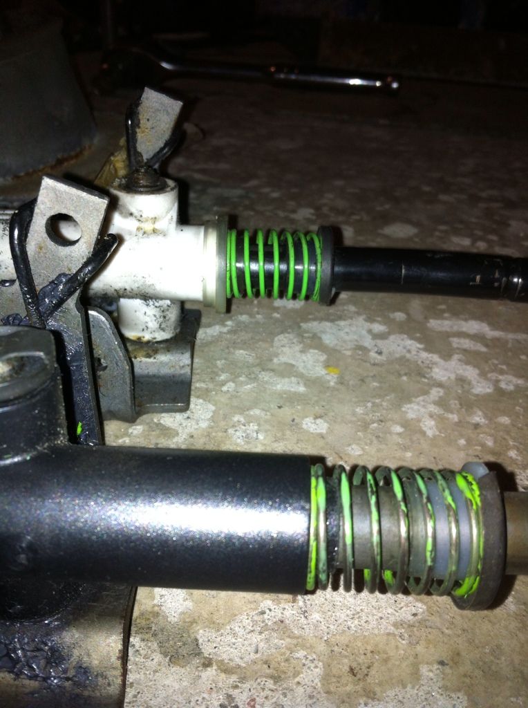

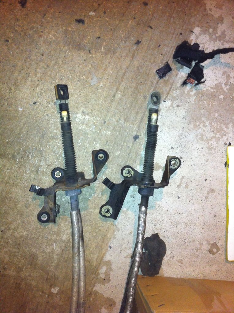

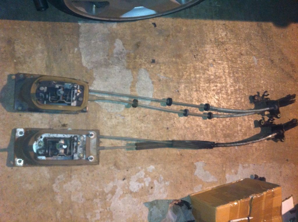

I compared the MK4 shifter and cables and the Corrado shifter and cables. Pretty similar setups.
Then I took the actual shifters apart to see the differences inside.
This is the MK4 shifter on the left and Corrado one on the right.
Interesting!!! The MK4 spring is positioned lower on the shaft meaning that I would be able to position the offset modification lower down if I use it...
Bottom of the boxes are different. The mk4 one is more curved. Because the MK4 spring and pivot is positioned differently it needs a tiny bit more clearance on the bottom.
After a quick test fit I noticed that the corner of the sharp angle on the corrado box was fouling the bottom of the mk4 shifter.
Sorry, I don't have any pics of the mod I made but I think we're all big boys and girls and we know what a hammer and metal bar can do. lol. I put the bar down through the inside of the box and flattened the angle out a bit for more clearance.

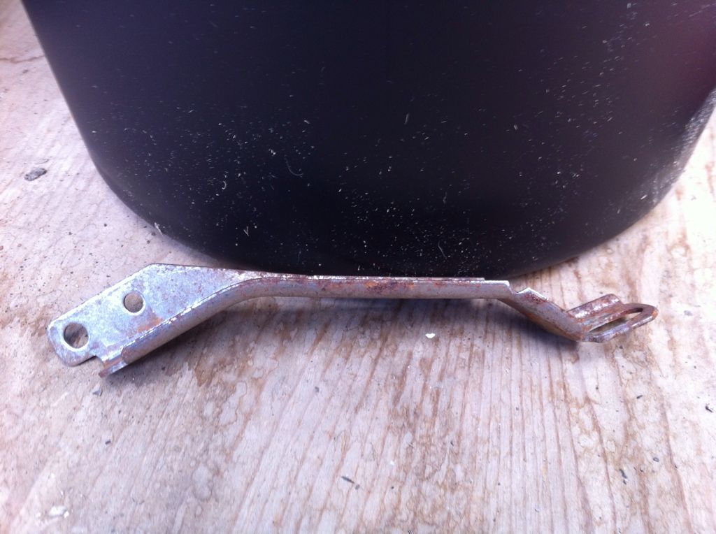

Test fit.
Then I filed out the handbrake bolt hole. As you can see it needs filed out off to the side a bit as the handbrake sits offset at the back (where it should be) and straight in the middle at the front. I'll sort this later.
