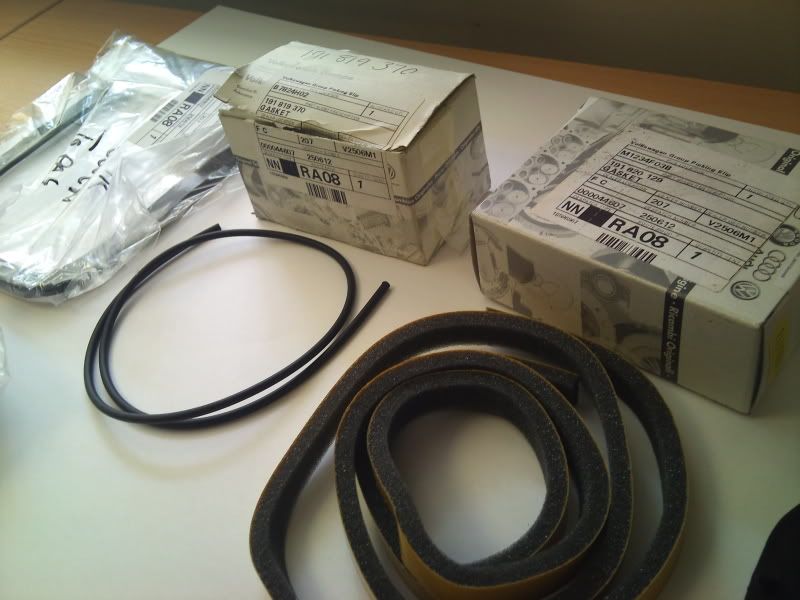

Jim Bowen 1 Posted June 28, 2012 Just collected these bits from VW and not quite what i expected. I can't access vagcat so unable to post the diagrams of where they go. I'm meant to have a foliage seal, top of blower motor, parts diagram showed 2 gaskets i ordered them both. And a gasket between the blower ducting and the unit behind centre of dash. This is what i got 191820129 - GASKET 191819166 - GASKET 191819370 - GASKET All those are about £6 each Quote Share this post Link to post Share on other sites
Bazmcc 0 Posted June 28, 2012 One on the left is the seal around the top of the airbox where it touches the scuttle panel. The one on the middle might be for between the groove in the airbox where the main center flap is and it's covered/sealed by the plastic part that fits on the front. Or it might be for around the edge of where the fan motor/resistor pack is bolted in. The one on the right is for the bit that sticks out of the top of the airbox and directs air into the dash or ducting to the dash vents. Probably enough there to do the bit on the bottom where the footwell vents are as well. Either way you'll need to lift the dash and airbox out to fit them all. Quote Share this post Link to post Share on other sites
Jim Bowen 1 Posted June 28, 2012 Nice one, sorted out the middle one, now I am home with the bits here. I was looking at the old aircon bits and not the normal ducting thats why it looked wrong. So the preformed one on the left, does that go interior side or engine side of the scuttle tray? Then the roll of seal on the opposite side to that? Sent from my X10i using Tapatalk 2 Quote Share this post Link to post Share on other sites
