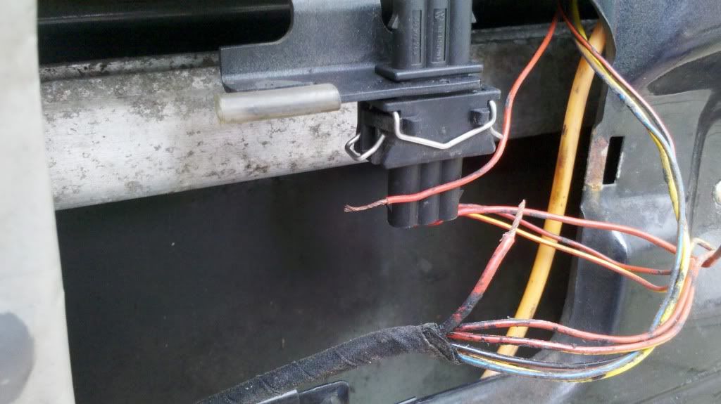

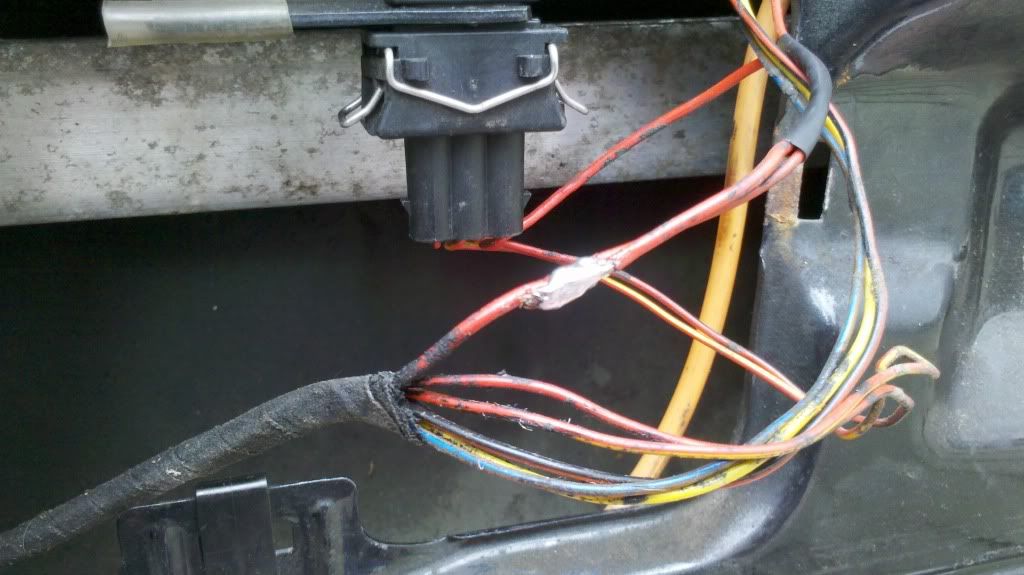

Just incase anyone wants to know, i managed to figure this out by tracing back all the cables and stripping back the fabric tape that holds the wiring loom together for the central locking. I thought the only other possible cause of this problem could be the wiring itself having a break in it somewhere. So I checked the most obvious place first inside the door lining, pulled back abit of the loom tape and found the problem, broken cables, and it was the same inside the drivers and passenger door. So I stripped back the cable, soldered them back together and shrink wrapped them. Reconnected battery and tested. And it all works perfectly again!
It has probably taken me the equivelent of a whole day time wise to figure out what was happening here. Changing the central locking module, central locking pump, removing handles to check for damaged cables and tracing back all the cables! But im really happy its all working like new again.
