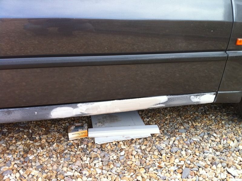

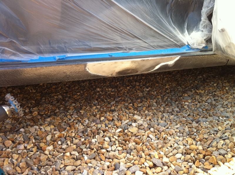

I decided to pull back the filler on the sil and see how bad the rust beneath was.
Not too bad you think, OK it's received a scrape in the past so someone filled it. Not a problem!

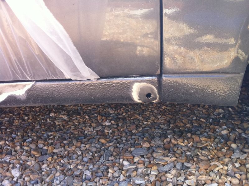

Buzz back more of the rusty area where it's peeling;
BALLS!

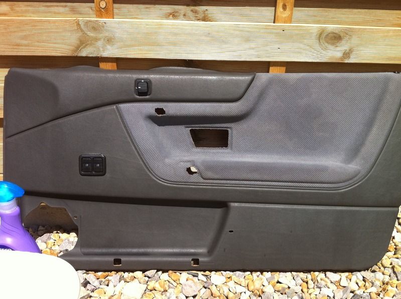

Cleaned down and restored the door card.

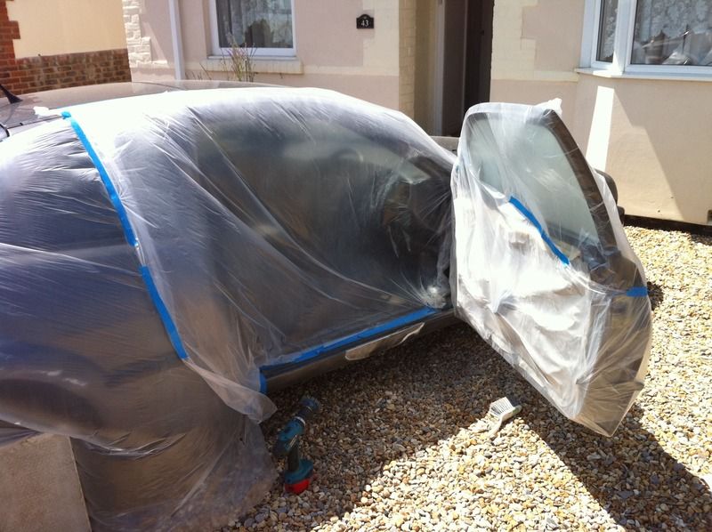

Spray the inside of the sill with Waxoyl, fill the hole with mesh and filler! (yeah I know).

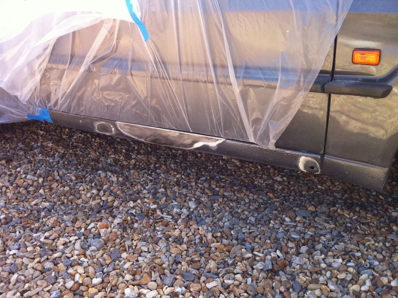

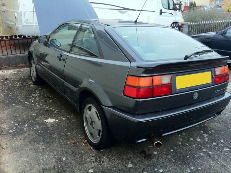

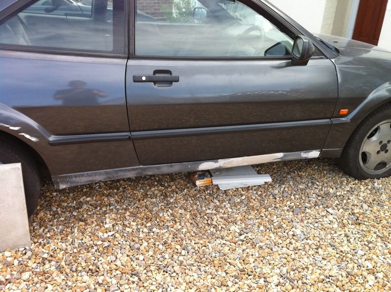

So this is her in the current form:

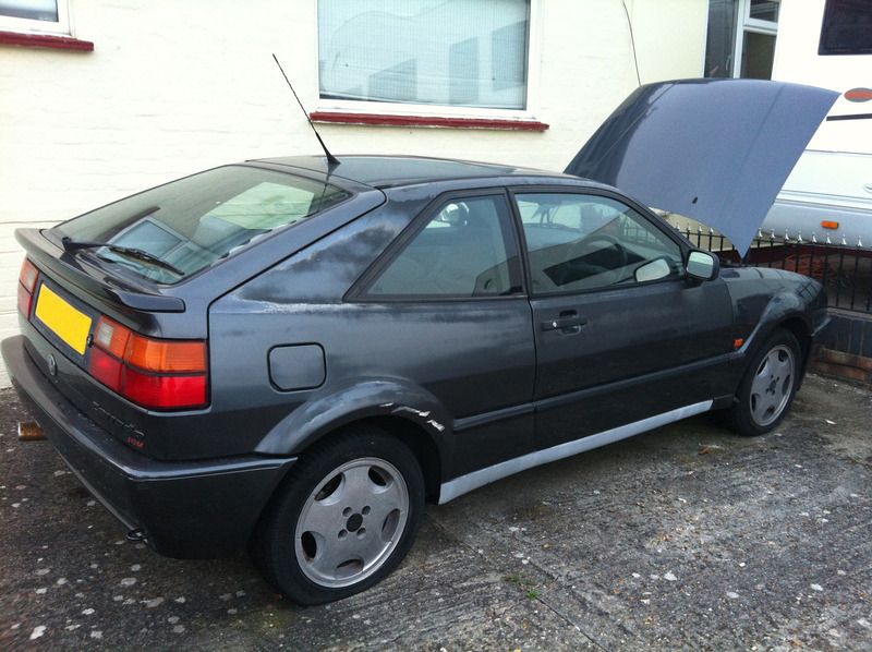

And the bad side that's had the bad paintwork since we bought it:
You can see my handiwork on the sill at this point. It's actually well formed and pretty smooth.

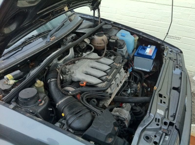

Engine bay

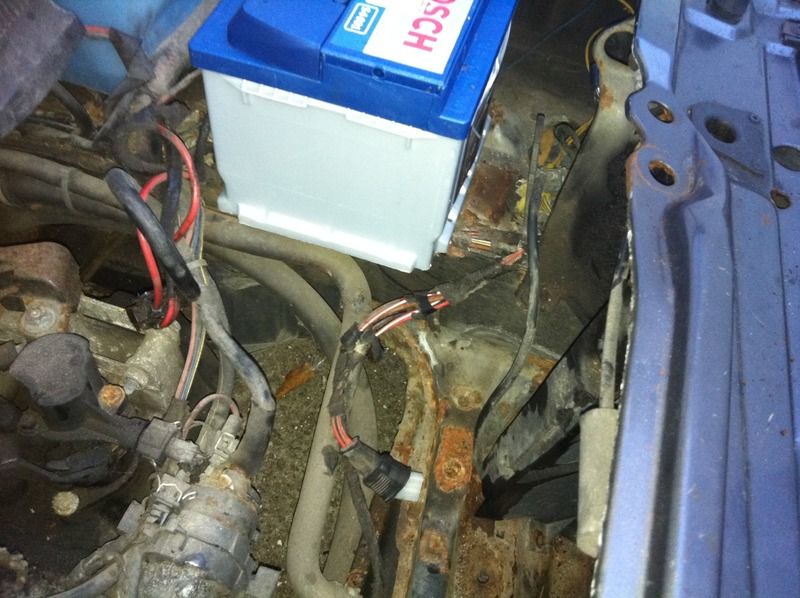

After starting it I decided to check that the rad pipes weren't bulging and that the thermostat was working. Everything felt OK but the pipes felt "crunchy", like there was piles of rust stuck in the corners sooooooooo.. Time to take the rad out!
Took a bit of effort what with everything pretty much ceased (actually removed in the shot above) but we got it out in the end;

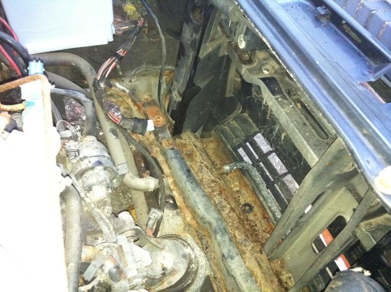

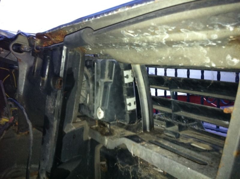

Front cross member/subframe (if someone can tell me the proper name for the lower front that the engine mount connects to that'd be great!) is a bit.. corroded!

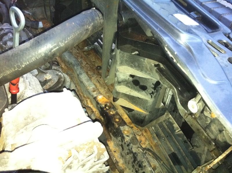

Slam panel corrosion up and underneath where the rad mounts have been rubbing badly for years;
More corrosion;

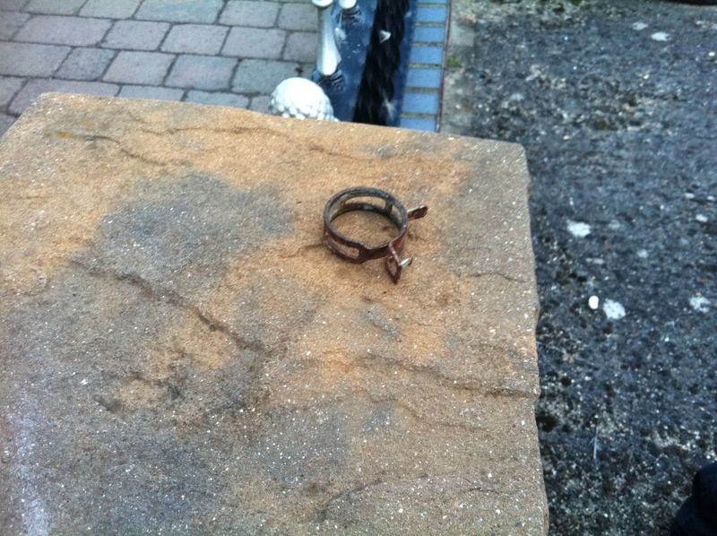

Also whoever invented these hose clips is my nemesis;
I'll replace these with stainless jubilee clips when its all put back together.

In relation to the front cross member / beam / bumper / whatever it's called, I think it'll probably need replacing. Does anyone happen to know how much of a challenge this job is and if I have to use a Corrado specific part?
Google seems to indicate Passat parts might work but if anyone has done one themselves and can tell me that'd be cool.
I also need some new rad mounts at the existing were rotten out, again a google indicates that VW don't actually make/sell these anymore, so if there is an alternative that I can use, awesome.
