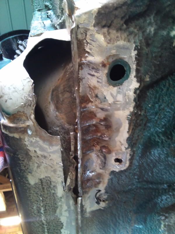

Some of mine, think its the same area you mean, the underseal hides so much corrosion.
I only planned to repair the small hole in the wing, thats all i could see
Other side was similar
After cutting some metal out
Yeah similar area. See the first pic, its where the horizontal line is on the left, but sill side not wing side.
Hope there isnt more than whats visible.
