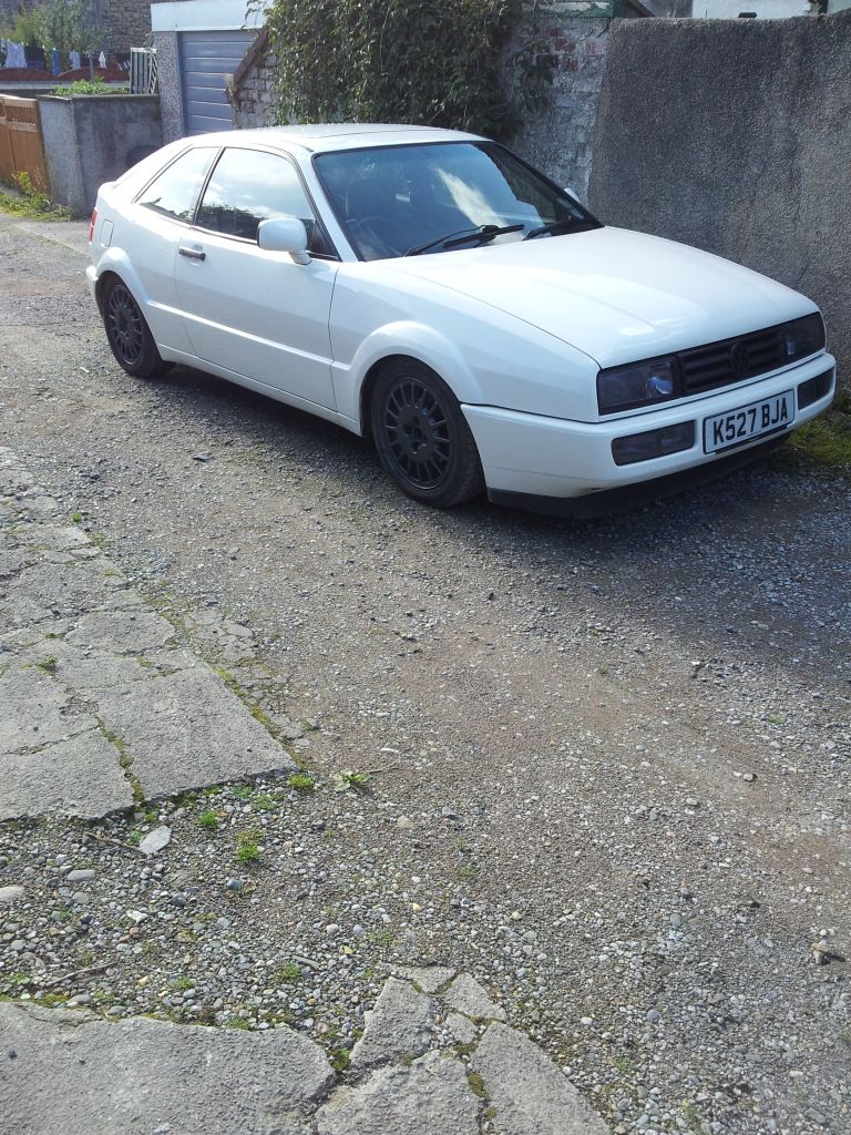

i got rid of the washer jets and arial only small things but makes a lot of difference to the look of the car and a smooth front bumper
I notice you didnt take off the door trim. it looks mint.
not that youd care but im surprised u went with those wheels. they seem different in the pics.
ur reg plate is the mustard tho.is that legal? how did u delete so cleanly off the bumper? and can we get a rear shot?
Same wheels (for info, Sebrings that were fitted to early 1.8 16v's), although in the second shot the centre caps are on.

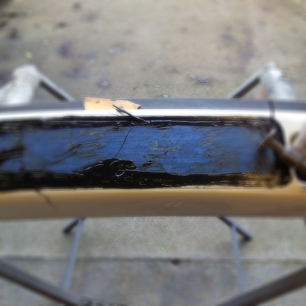

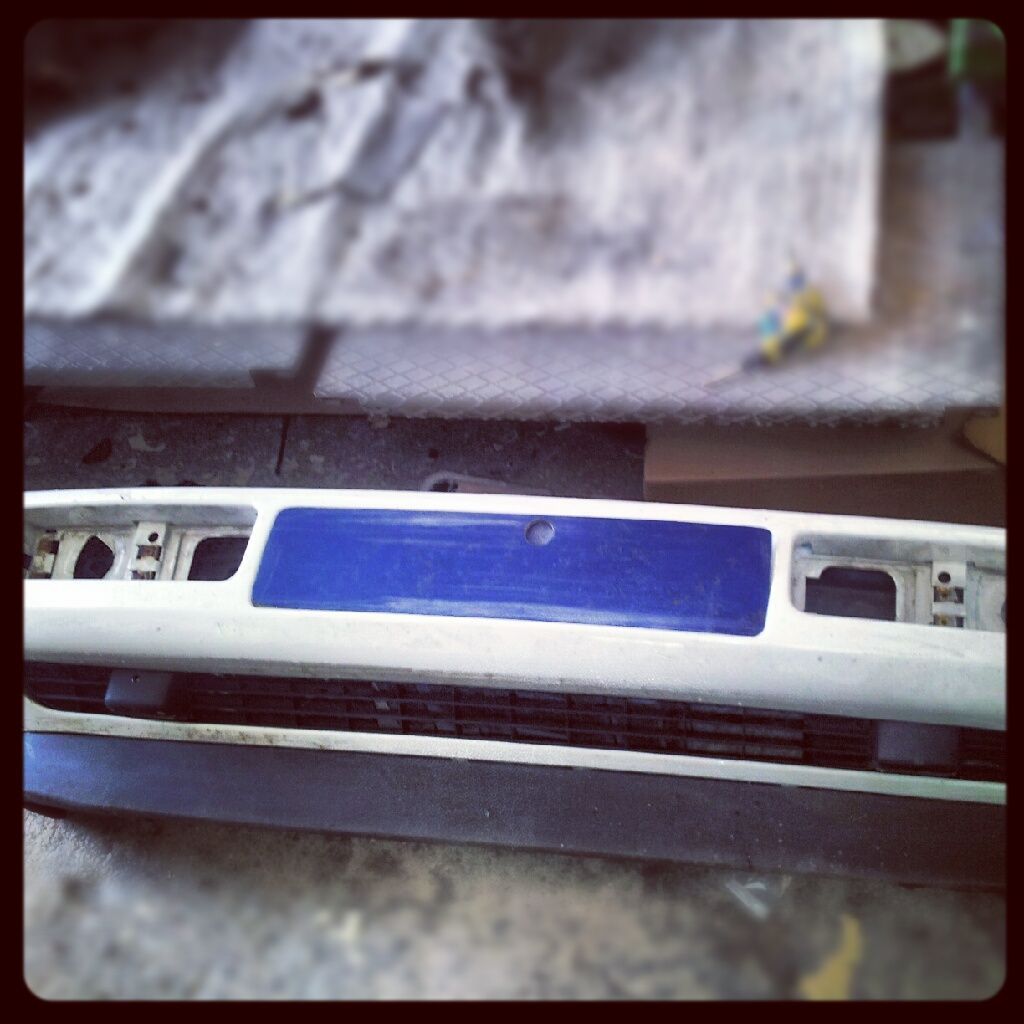

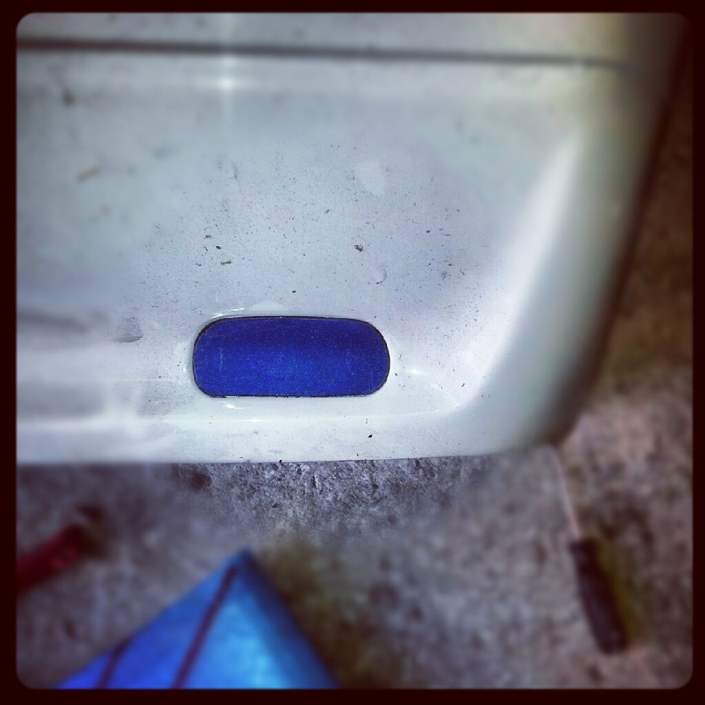

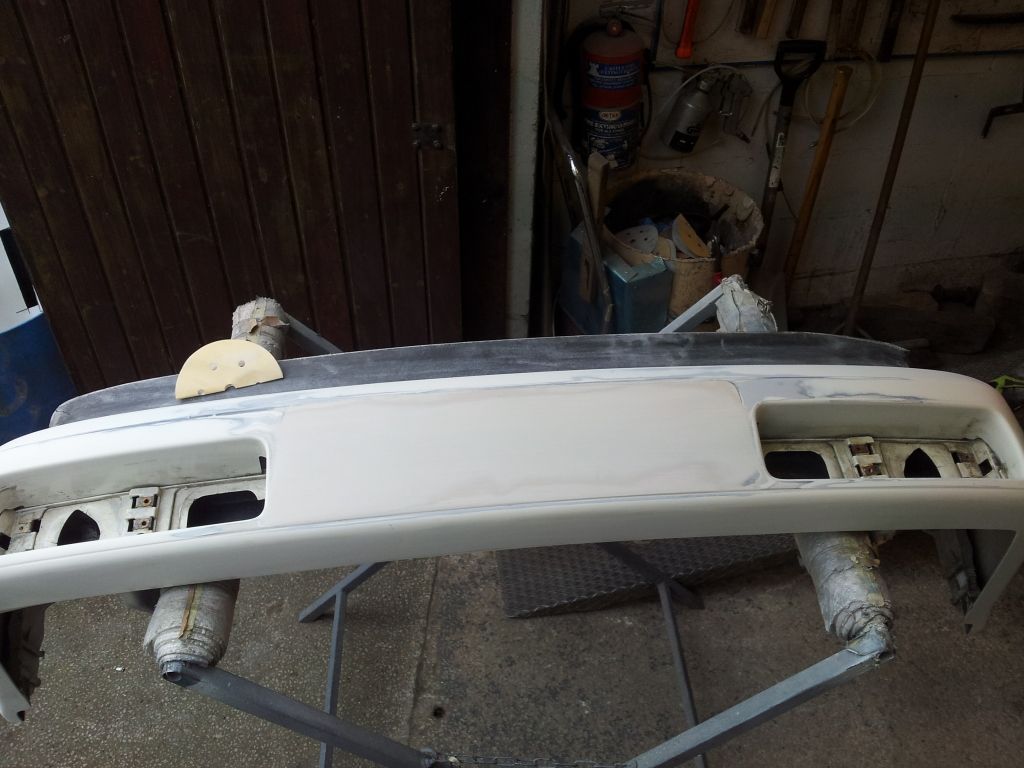

i got the car with the wheels on and just running them for winter as for the bumper i got another bumper and cut a section out to fit in the recess bonded that in and then gave it a skim of filler over that i have some pictures of the process if your interested in seeing it. the number plate being where it is im not sure but the police haven't said any thing. and yeah ill get a picture of the rear today
yeah no worrys fella
so that's the bit of bumper cut out next is to bond it in
then it was sanded down and given a skim of filler

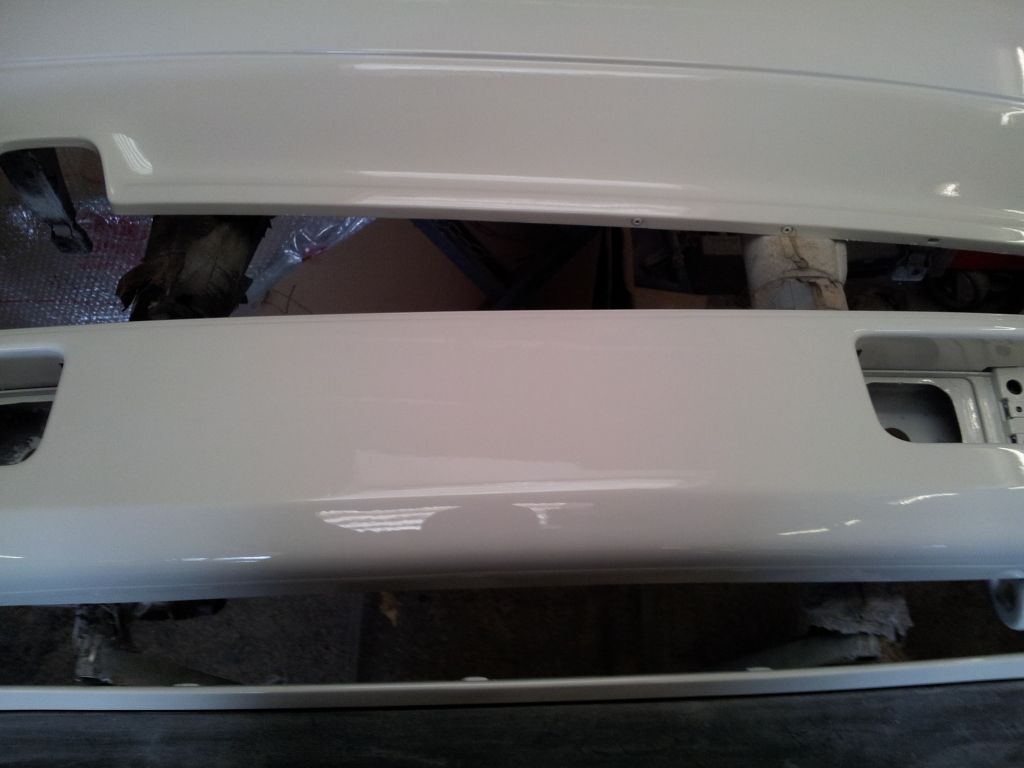

then its basicly the same for the back bumper
then all painted up

Your car looks lovely :) Did you use a section from another bumper to fill in the rear towing eye or just make it up with sheet?

cheers man :-) yeah basicly i just made abit to fit in the whole and bonded it in and skimmed with filler :-)
