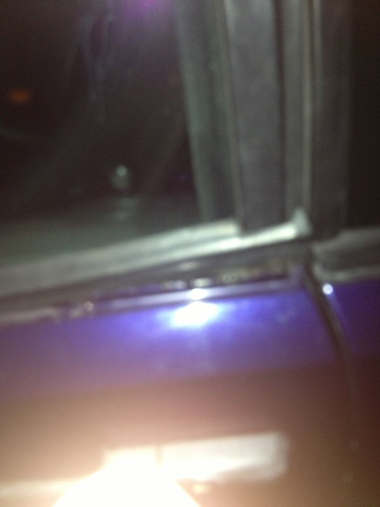

My scraper seems to be knackered, am I just missing some clips or do I need to replace it?
lol thats a realy terrible photo dude , i know what the problem is though, the rubbers more then likley broken, theres a peice which hangs down and folds over underneith to stop it from pulling up like that, its ethier not seated right or the rubber peice has split, them seals/trim peices are very expensive {£70 ish per side} and hard to get 2nd hand in good condition, if you push it back down and it looks ok i would just get some epoxy adhesive and put small spot of it under it {Not to much!!!} and just glue it for what its worth..
Lol, I'll take a better pic tomorrow, but I can't see any damaged/split.
Do these just push down and into position? I had assumed I'd lost some clips.......
put the window down all the way, you might be able to see with a torch if you look from the inside through the glass, realy dought theres anything more you can do other then glue it.

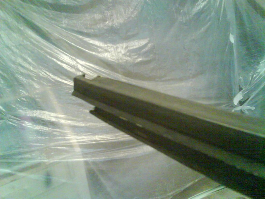

here you see the very bottom edge? that clips over a lip which stops it from pulling up
if its split like this , then its free to pull up, like yours { and mine!!}

I think I'm missing the bit that loops under to stop it coming up.
