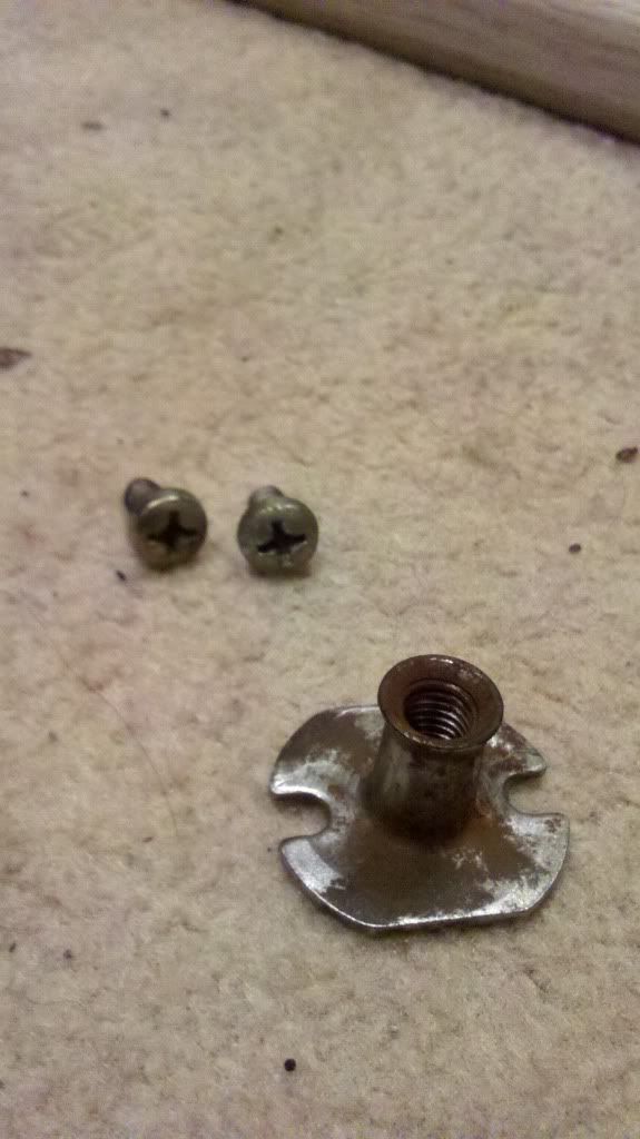

The problem is that when I went to fit it, there is no threaded hole in the floor. There are two smaller holes that had self tappers screwed into them.
You can't see it too well in the pic below but basically there are two holes here, neither is big enough for the stopper.
How the hell should this fit? :)

I wonder if there is supposed to be a bracket unr the carpet that has a threaded hole for the stopper but is attached to the floor with 2 self tapping screws?

There should be a small metal plate that attaches with the two screws. Part number 192721531, simply called 'threaded plate'. Should be cheap as chips if still available from VW :)
If you want I can get you some pics of what way the stud on my floor is set up as I have my dash out at the minute.

That would be awesome as the part is obsolete and so I'm probably goign to have to make one myself unless someone is breaking a corrado and has it.
Either way a photo will help me big style
Ah ha!
Cool, not at all what I expected it to be like!
I was going to contact you tonight about that trim panel, I'll take it but I just needed to hold off as I've bought so many parts lately without thinking that I've maxed out the card connected to my paypal ;)
All sorted now. Do you by any chance want to sell me this bracket? Save me the hassle of trying to make one!

£4 including the screws? Yeah I've still got the trim panel as well, Im happy to send you out the bits you need and you can pay me once you have the money buddy. Let me know.
