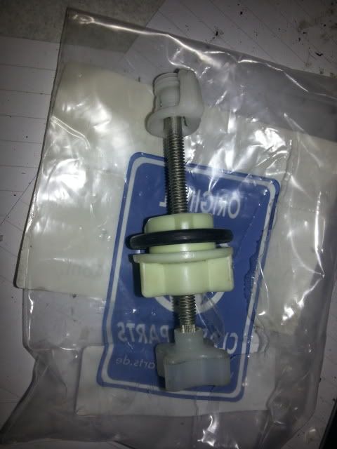

Can't for the life of me fathom out how this fits securely to the headlight unit!
Removed the trim and glass (good excuse to give it a clean) and removed the old, broken adjuster.
Fitted it to the reflector all OK, the problem i'm having is the adjuster part coming loose and therefore the reflector coming loose - it seems as if there's nothing holding it in place unless the adjuster screw is wound completely out. Weird!
Anyway, here's the part below - is there anything missing at all?
The top bit on pic just clips to the reflector. And the white bit in the middle with the rubber washer fits to the black plastic of headlight casing. Should be three gaps where the lugs on that middle white plastic bit goes in then you have to twist it to lock in place. They are really tight gits though. I've snapped loads of those fins off over the years.
