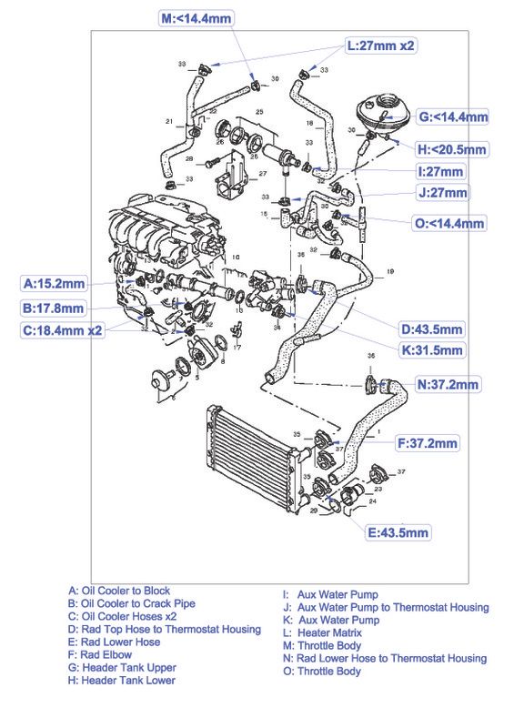

Jim Bowen 1 Posted March 8, 2016 I made this for spring clamps Brought the clips from here https://www.hcl-clamping.co.uk/36-rotor-spring-band-hose-clamp-constant-tension Quote Share this post Link to post Share on other sites
Jim 2 Posted March 8, 2016 Whoa awesome! Thanks man! Quote Share this post Link to post Share on other sites
g0ldf1ng3r 14 Posted March 8, 2016 very nice Jim! i have favourite that for later lol Quote Share this post Link to post Share on other sites
Jim Bowen 1 Posted March 8, 2016 A few of the smaller diameter ones i did use jubliee's, like the throttle body ones and header tank, those hoses don't seem to expand or suffer as much as the bigger ones. Quote Share this post Link to post Share on other sites
