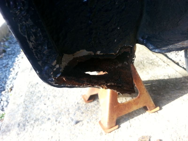

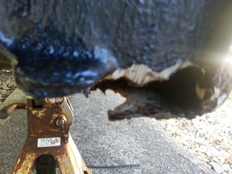

its the end of the sill by the rear wheel is what I need, not sure what the correct part is called
Unfortunately you have to buy a whole rear panel to get that bit :(
Part #11 on this pic:
535809843A (left) and 535809844A (right). Still available from VW Classic Parts in Germany but at €495 each! You'd do better cutting it off a breaker. The parts I have are #10 on that pic. £120 the pair (collected) if anyone wants them :)
