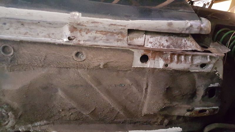

Hi guys, I have recently bought a corrado project car and she has rusted badly behind the lower part of the wings (further most forward part of the cill). At first I thought this was part of the wrotten wings... but... its not..
Has anyone else had experience of this? Is the general concensus to cut a section from an old car? Are parts still available?
On both sides it has started to effect the frontal areas's of the cills (delaminating at the seam).
I will try to get some pictures today. Any advice would be a great help!

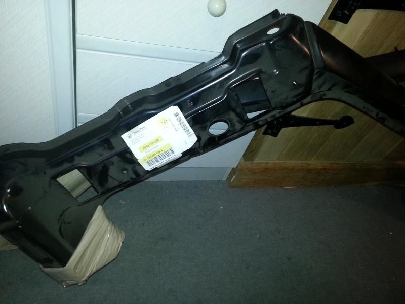

VW sell the repair panels, but you get a lot of panel you don't need. LHS = 535809839A RHS = 535809840A

I found once the water got beneath the under seal the rust spread all along the seams, i had to have a few bits of sill cut out and repaired as well.
Jim, thank you for taking the time to post such a detailed reply, it is certainly given me hope she can be repaired. It was just abit of a shock when the knackered wings had been removed and I started chasing the rust.
I will add some photo's tomorrow and post up the progress.
