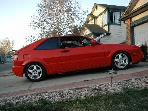

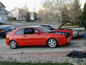

vwfastg60 0 Posted January 8, 2005 I have been looking over the forums on and off for a while now.I thought now was a good time to join. I figure i might as well post some pics of my project vr6 because its moving pretty quick right now. Heres the basic rundown of what i have done so far... I picked up the car dirt cheap the old owner had trashed it. when i got it there was alot of work to be put in to it. some one had broke the drivers window and trashed the dash and seats trying to stal the stereo. also the person who had done the work to the car just made it work. there were rollerblade bearings as spacers for the charger. hoses that wer spliced together. wires that were taped together. the car accually caught fire on the way home. the gauge pod on the piller shorted out and sparked a fire. after 2 years of having the car and it sitting i figured i would jump on it. The headgasket was bad when i got it and never knew it cause they covered it up with stopleak.once failing emissions for the 3rd time the waterpump went and after the coolant flush it would no longer hold.so the motor was replaced within the first few months and it went down hill from there. heres the pics of the rebuild tho. The car after lots of cleaning and the motor going back in...at this point i had added PSS9 coilovers lights and little things. the new motor going in and the new color of choice how the car has sat for over a year now.inside but no changes audi a4 handles going in after i moved in to the new house HID and new euro headlights new wheels and the 90mmlip Now to fit the wheels The rear is still to come. I also have a 90 g60 corrado that im going to be using as my daily driver. it is also getting a make over but as fast and not as big of one. Enjoy and any comments would be great. Russell my g60 Quote Share this post Link to post Share on other sites

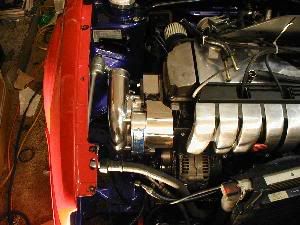

CoxyLaad 0 Posted January 8, 2005 i think he is going to paint it some sort of purple - check out his engine bay pic nice, I bet it shifts somewhat Quote Share this post Link to post Share on other sites
biggerbigben 0 Posted January 8, 2005 VWfastG60, Have you modified the arches yourself and those BBS rims look awesome, they must have wider rims on them than standard???? Wicked car.. Quote Share this post Link to post Share on other sites

vwfastg60 0 Posted January 9, 2005 Thanks guys,The wheels do have kodiak motorsports lips on them. to make them 17/9 and 17/9.5 from the standard 17/7.5. I am pulling the fenders myself and doing 90% of the body work on it myself.I was going to spray the car but im scared to.Im going ot have a friend of mine come and help me spray it or atleast watch over me as i do. The color is going to be more of a purple blue color. Lee you can message me anytime about the H.I.D's you have hepled me out alot...its the least i can do...it was simple and helped out more then i ever would have thought. Thanks again guys Quote Share this post Link to post Share on other sites

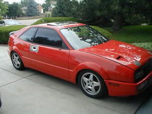

vwfastg60 0 Posted January 9, 2005 Im running a 205/40/17 on the front and a 215/40/17 in the rear the fronts are 9 and the rear are 9.5. here are some more pics of the front fenders. Before the bumper was heated to fit the fender After heating The rears are going to be harder after spending time yesterday looking at it i am going to split the inner and outer 1/4 pannel. Im goin g ot metal shape the outer just like i did the front. then im going to weld the inner up higher to allow the car to sil lower and get the tire up in the wheel well farther without rubbing issues. I want the car to sit low but not have to worry about rubbing. the fronts with the car lowered all the way down on pss9's i can turn the wheel all the way and drive with no rubbing at all. Just another pic to add to the thread Quote Share this post Link to post Share on other sites
