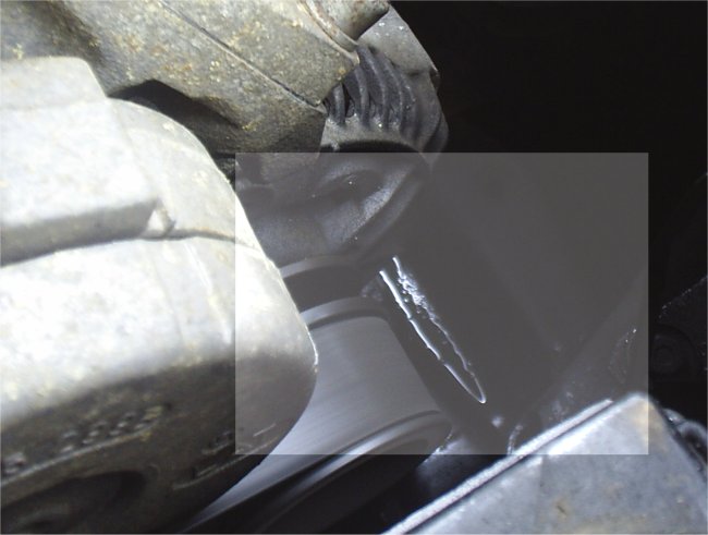

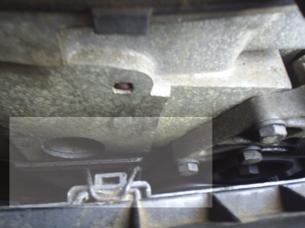

theRuler 0 Posted March 7, 2005 right then i just fitted the bypass pipe, joining the 2 pipes together. put water in and run it up to temp. then i noticed this: the light shaded bit shows water that seemed to be collecting there. like it was being sprayed out from by the belt and all them pulleys here's a shot of where the head meets the block. looks moist. the water seemed to be misting from there, although the belt was spraying it heres another pic and as i was undoing the clips, i slipped with the grips and the clip sprang open and twanged my thumb. i cant feel it yet. Quote Share this post Link to post Share on other sites
