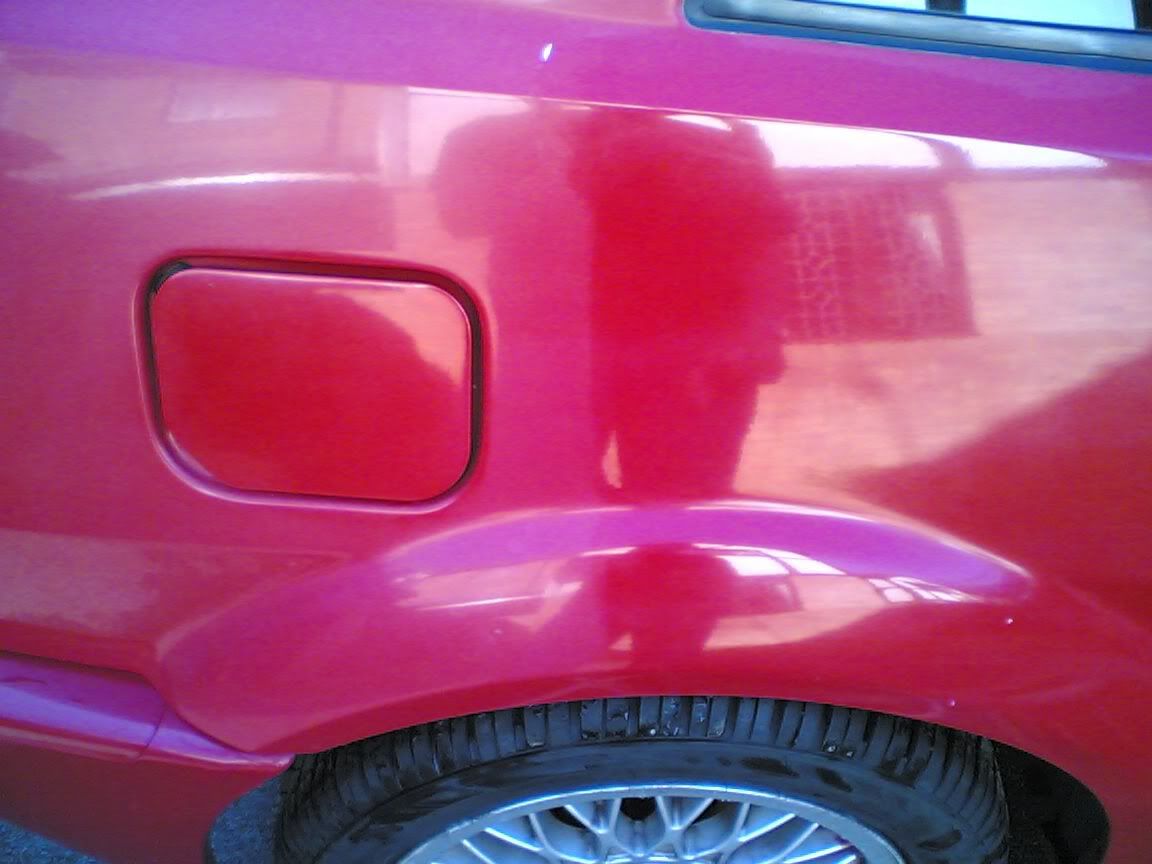

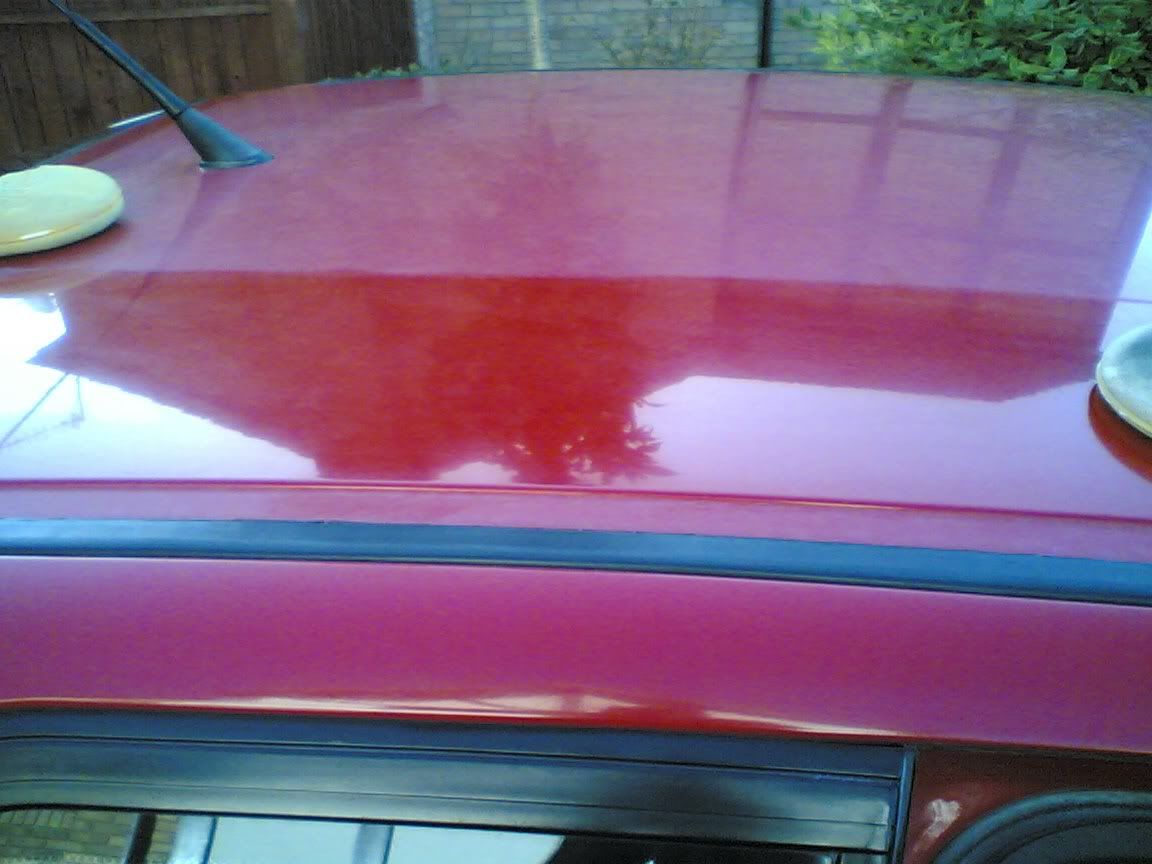

Spykee 0 Posted August 14, 2005 i totally understand where your coming from check out the roof of my G60 > and the rear wing > i have got fed up with polishing it and waxing it etc all the time so its going for a respray on wednesday! 8) Quote Share this post Link to post Share on other sites

Spykee 0 Posted August 16, 2005 LHD-G60 That paint will fade again in no time with just the wax applied. It needs to be cut back properly and then sealed (and continue sealing regularly) with a good wax. Get it professionally mopped with G11 and then wax it regularly. no point mate its a lot worse than it looks :wink: plus some ofthe car is flash red and some is Tornado red! its supposed ot be all tornado red! its goin into the garage tomorrow for the respray so its gonna look the dogs bollards when its done 8) Alex Quote Share this post Link to post Share on other sites
StormchargedVR6 0 Posted August 17, 2005 Polishing it won't last no time at all,don't matter how good the polish is. Get it resprayed, make sure they basecoat it and clearcoat it, all solid colours now days are clearcoated to stop fadeing. Was in the spraying game for fifteen years,i know my paints :) Quote Share this post Link to post Share on other sites
