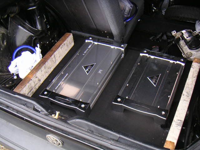

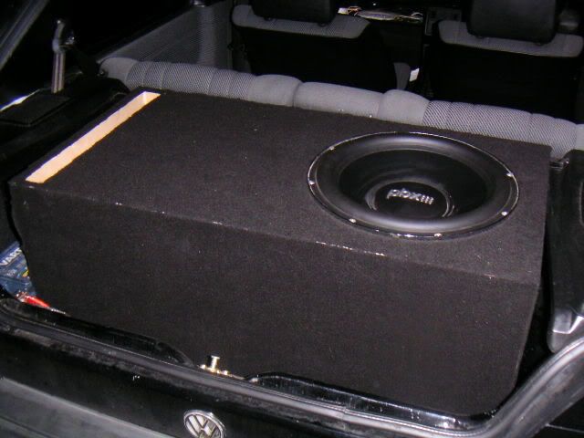

heres a few pics of my mk2 golf install.... its a spl install, for low bass...
http://i22.photobucket.com/albums/b321/ ... CT0067.jpg
http://i22.photobucket.com/albums/b321/ ... CT0043.jpg
