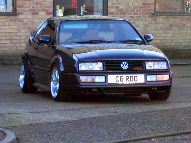

racingswamp46 0 Posted December 23, 2005 here's the spec list, i brought it from a mate who used to use this forum he used the name vr6220, ihave just changed the alloys to brock b2's with deep polished rim because i bent one of the oettinger ones and couldnt get hold of any new ones! most of this work was carried out in the factory when the car was brand new, i have over 40k's worth of reciepts for it! oettinger 3.2 engine conversion two highlift camshafts modified inlet manifold modified exhaust manifold modified air flow oettinger chip and ecu full powerflow s/s exhaust de-catted oettinger bodykit oettinger type m alloy wheels spax suspension shocks and springs (30mm front 20mm rear) oettinger steering wheel light smoke window tints full cream leather retrim additional instruments (volt meter, oil pressure) and a private plate to top it off!! C6 RDO Quote Share this post Link to post Share on other sites

racingswamp46 0 Posted December 24, 2005 i'm not sure how to post pics! hope this works! Quote Share this post Link to post Share on other sites

VR6 220 0 Posted July 10, 2006 not like you, you bellend! why is there a pic of my MR2!?! Quote Share this post Link to post Share on other sites
racingswamp46 0 Posted July 14, 2006 Fcuk knows!???? must have opened the fckn crap picture file instead of the fckn smart picture file!!! :D My bad. Quote Share this post Link to post Share on other sites
