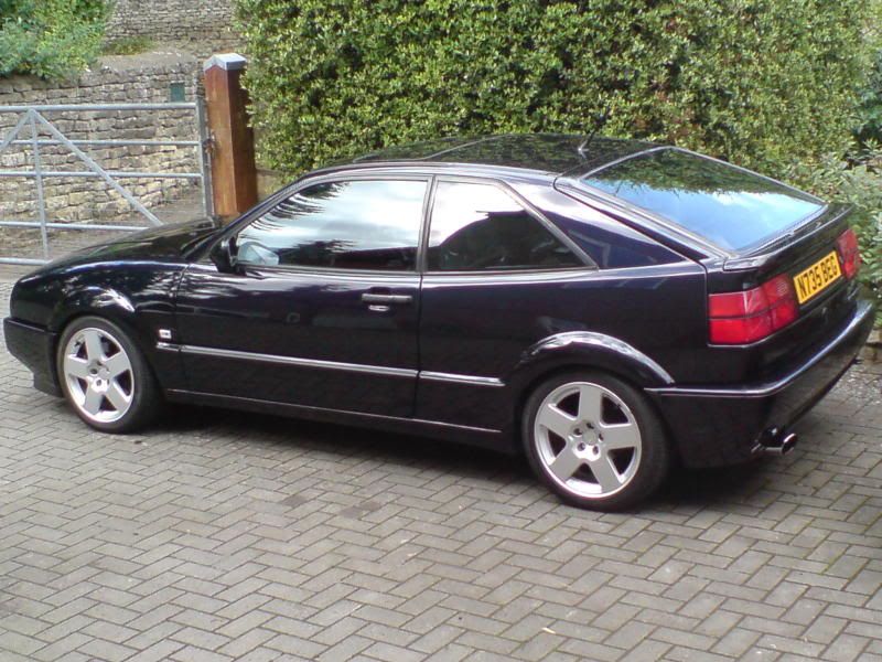

KADVR6 0 Posted March 13, 2006 looking very nice steve, great colour. and very nice wheels. one thing and im not picking faults, but the back seems to be sitting lower that the front, or is it just the angle of the pic?? Quote Share this post Link to post Share on other sites
steve @ 0 Posted March 13, 2006 looking very nice steve, great colour. and very nice wheels. one thing and im not picking faults, but the back seems to be sitting lower that the front, or is it just the angle of the pic?? Yeah your right It could do with a set of lowering top mounts to bring it down 10mm at the front. Although in this pic it doesnt look to bad http://www.the-corrado.net/.archive/forum/album_pic.php?pic_id=1418 Quote Share this post Link to post Share on other sites
KADVR6 0 Posted March 13, 2006 please dont think i was picking faults steve, i wasnt, but i think some 10/15mm lowering caps would make it sit just perfect 8) but hey still a very nice rado Quote Share this post Link to post Share on other sites

herisites 0 Posted October 9, 2006 That is one superb looking corrado mate :D you must be well chuffed!! Quote Share this post Link to post Share on other sites
Phil K 0 Posted October 9, 2006 Looking very sweet! Love the wheels and the ride height is spot on 8) Quote Share this post Link to post Share on other sites

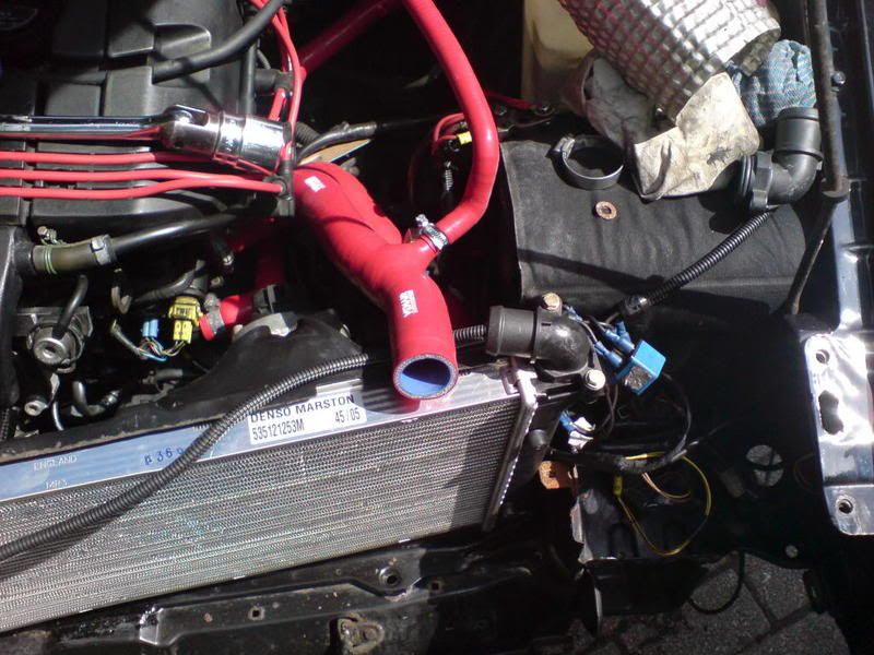

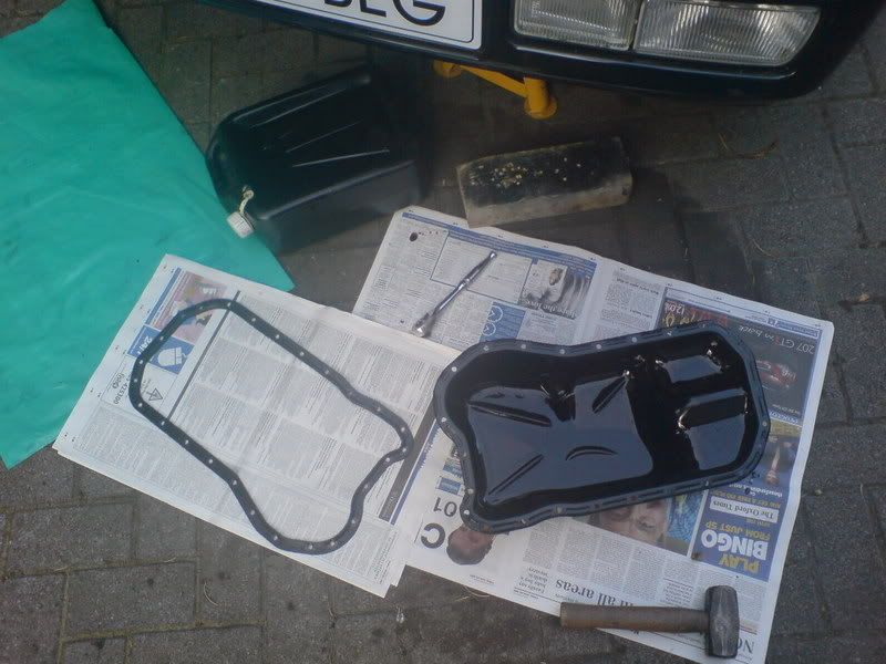

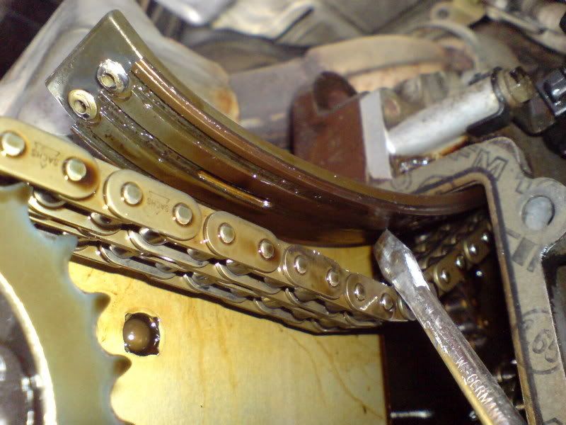

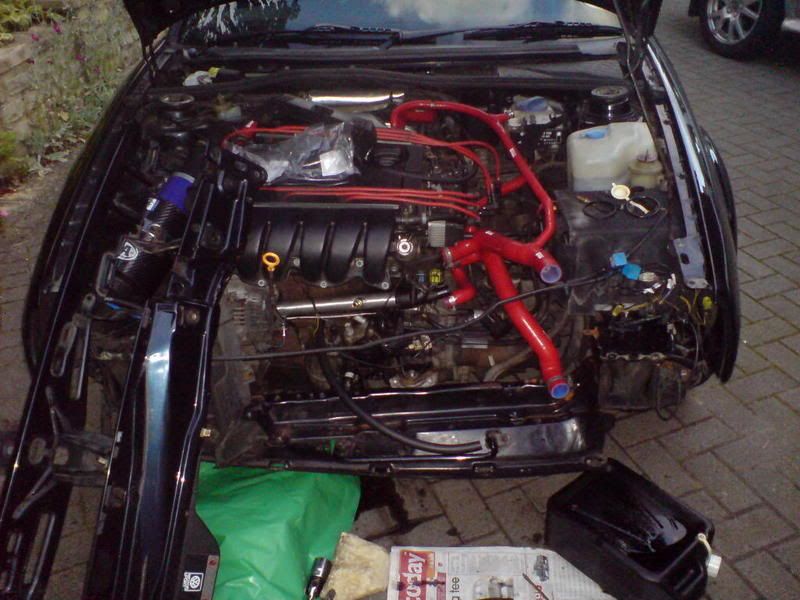

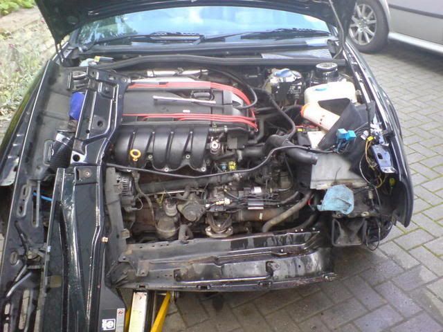

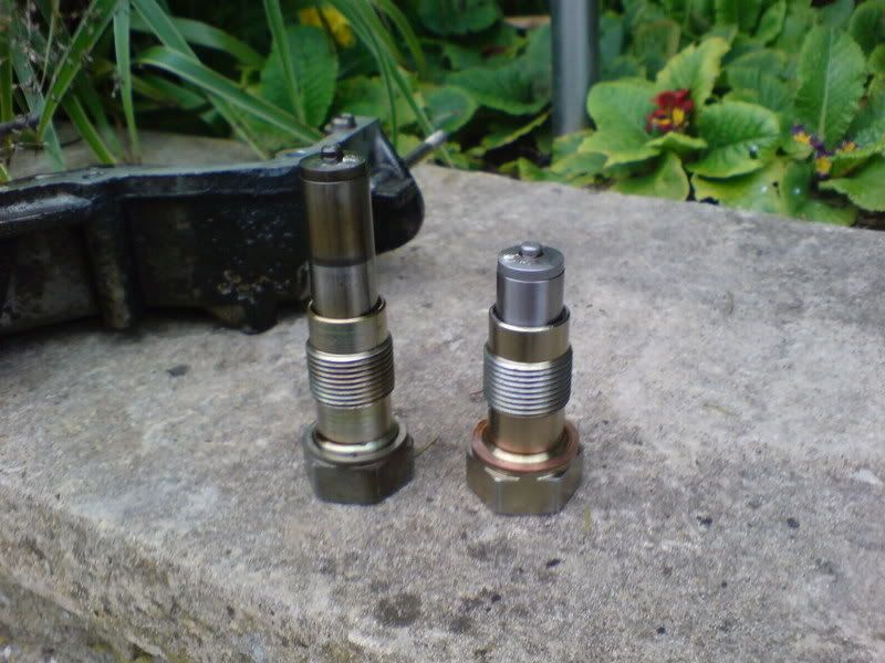

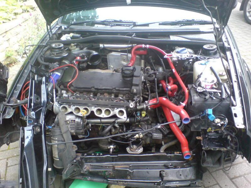

steve @ 0 Posted September 1, 2007 Haven t updated this for a while so thought i'd add a quick update. Well first of all I ve had a load of parts in the garage for ages; 6 branch, clutch chains oil cooler etc etc. So after my radiator sprang a leak I though it was the ideal time to fit a few of the above. First of all I replaced the non gen rad with a new gen rad (quality is miles better). That was straight forward enough. Also fitted the guven ally crack pipe(old one was really brittle and fragile). Next was the mocal oil cooler .... bit of pain trying to source a metal end cap to fit the shorter banjo bolt. After ordering a few parts form vag I simply gave up and extended the tread on the original bolt and cut it down to the required length. Next red silicone hoses .... fitted Umm then came to fit the rad ..... ment for a golf not a corrado ... cheers Jimmi !!!! Top hose has the wrong angle Bottom hose crimps up While the car was at this stage I thought i'd check the condition of the top pad and guide. Top gide is fine pad is clearly worn (154K) I fitted all back together with a new top tensioner ... only for a bit of dirt to block the oil hole resulting in the chain jumping a few teeth .... o bugger (my fault really :( ) O well u live and learn. So book the car in to stealth for head and chains etc. Seeing as i am probably looking at a few bent valves (happened at idle, but still..) Brought a second hand head, stripped it had it cleaned valves cleaned and refaced 12 new guides and stem seels also had a little work carried out 3 angle valve seats port matched inlet manifolds big bore throttle body (with enlarged butter fly valve) and had the 6 branch ported to the gasket. Head returned: Cleaned the inlet up with the air grinder and a lick of paint. Wrapped the manifold and sprayed in high temp paint (not shown in this pic) Dropped the sump, cleaned ready for a new oil pump to be fitted. Fitted new fuel lines to replace nackered return line: Ready to be towed to stealth: Dropped it off this morning should have it back by next weekend. Cant wait as its been off the road for 4 weeks already!! Quote Share this post Link to post Share on other sites

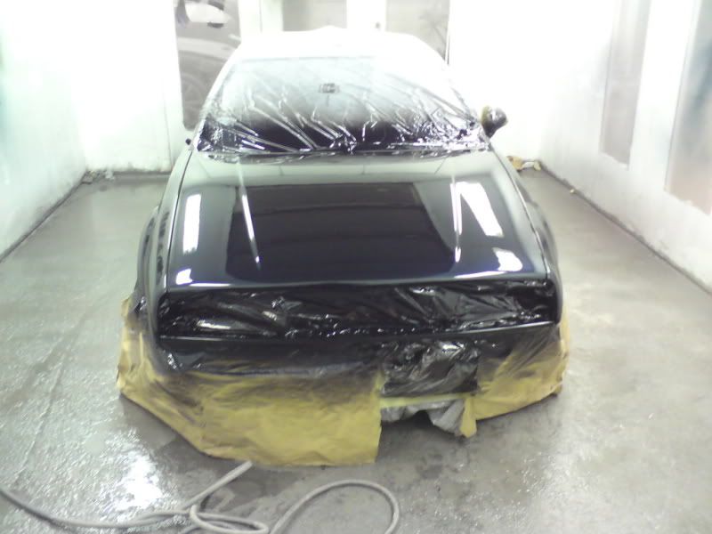

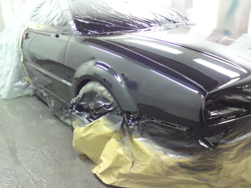

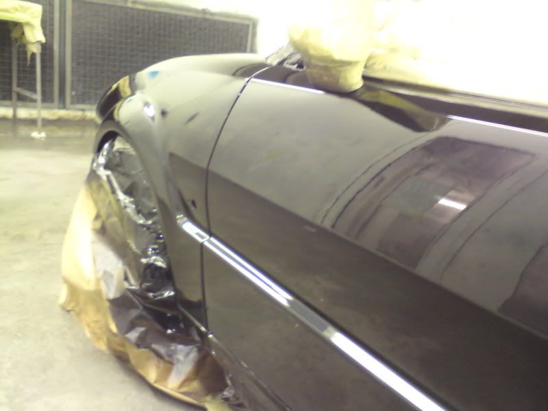

steve @ 0 Posted December 10, 2008 Well its been well over a year since I have updated this :shock: quite a lot has gone on with the car. I hope to do a full update soon, but for the time being a few from the body shop where she had a bare metal bonnet respray along with both doors and wings and handles. Looking much better now!poor phone pics as always :lol: Quote Share this post Link to post Share on other sites
