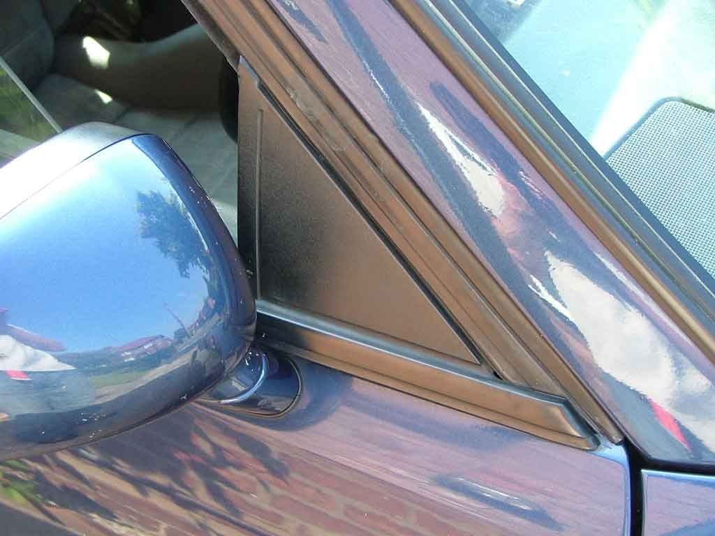

Hi all.
I think my windnoise on the drivers side is coming from this panel. It can be lifted with fingers and at speed it has started to lift.
I guess its damaged already but I have no desire to bust it. How does it lift off.
i think its held on from the inside? there is a screw at the front on the inside that also holds the door seal down, i think you undo this one and the outer trim lifts off, the triangular cover on the inside just pulls off.
the design of the mirrors does seem to cause a bit of wind noise anyway especially at motorway speeds.
I had some wind noise coming from the mirror housing (underside).
I smoothed it down and it's eliminated it.
if your sure its that panel then I think it is secured from inside (you remove the inside triangle) as said above

yeah I did some investigating. Found a screw hole no screw? It was stuck on with double sided???? :lol:
All the clips are broke?
Try some window poly for the time being. Get hold of another.
I'll take alook at the mirror whilst i'm there. The panel is lifting at speed. So maybe its making the bulk of the noise.
