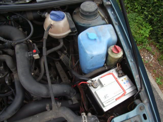

covincharger 0 Posted July 8, 2006 can someone tell me what the container with the red cap by washer bottle is,as its empty. Quote Share this post Link to post Share on other sites
vr6storm 0 Posted July 8, 2006 PAS reservoir...............best to use VW's own stuff btw Quote Share this post Link to post Share on other sites
Supercharged 2 Posted July 8, 2006 Yep - it's in the instruction manual btw.... As above only use the green stuff which is about £4 from VAG (NOT red ATF fluid!!) Quote Share this post Link to post Share on other sites
Crasher 4 Posted July 8, 2006 Err sorry Supercharged but red cap means ATF Dexron II (red) and green cap means mineral! Quote Share this post Link to post Share on other sites
Supercharged 2 Posted July 8, 2006 Hmmmm.... Steve - this has been a point of discussion on here several times and I have seen both red and black caps on Corrado's but every VW dealer I have been to has said that green is the stuff to use and they only sell ATF fluid for use in Auto boxes... GSF/Euro seem to say what you have said above but I have never seen this in a manual and my friend in Audi parts says that no VW's have ever used ATF fluid for PAS as it rots the seals of the rack components - both types... Also G 004 (which replaced G 002 and is about half the price) is the only fluid listed for a Corrado on ETKA and I don't think I've ever seen an original (ie unmolested) Corrado with red fluid... Have you got any other info or documentation on this as it's something that really needs clearing up?!? Quote Share this post Link to post Share on other sites
steveo29 0 Posted July 9, 2006 just had a look at my g60...its fairly unmolested red cap..green stuff inside Quote Share this post Link to post Share on other sites
Crasher 4 Posted July 9, 2006 It is a contentious issue and has been for years and as far as I know there is no definitive answer, the black cap is a good one and the only explanation I have is it is a universal replacement. We go by the bottle cap colour and also the ledged on the bottle which tells you to use approved fluids (very helpful) and occasionally says nur (only) mineral or ATF fluid respectively. The general rule is all cars after 1992 use mineral. One thing though, I have never seen problems from using ATF. My wife’s G2 has used a late G60 rack with ATF for the last five years with no problems. Quote Share this post Link to post Share on other sites
